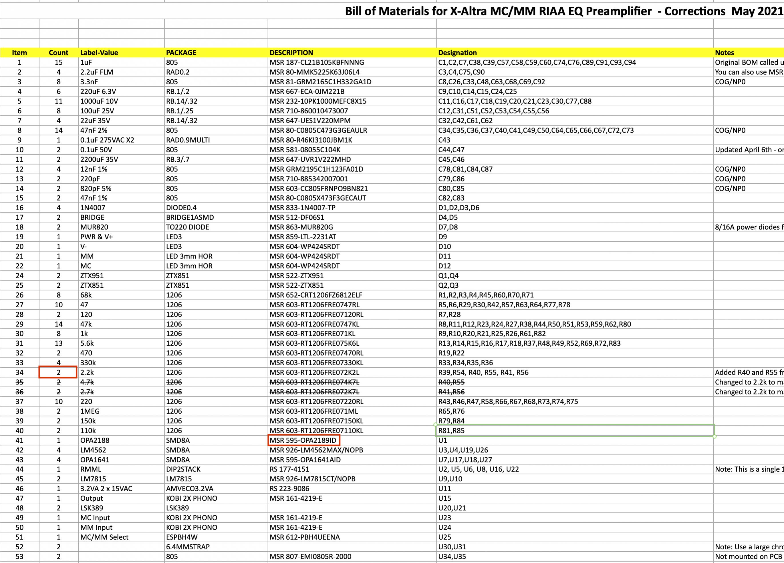

I just ordered the PCB, chassis and most parts. I did see a discrepancy in parts and BOM, shown in red squares below. When R40 et al were changed to 2.2K, the quantity was not increased to 6 pieces. Also, as previously commented in thread, the OPA2189 (which is out of stock) is being specified in the Mouser numbers instead of the OPA2188.

1. the BOM was updated after the version you have posted above. Here is the link to the page
audioXpress Supplementary Material | audioXpress
2. That transformer looks equivalent so you should be good to go
3. The 12-way DIP switch you are proposing will work. (For builders sourcing the RS part, it looks like they have linked to the wrong data sheet on their website. The part number however is correct because that's what I bought for my builds)

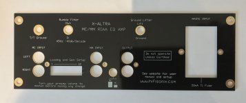

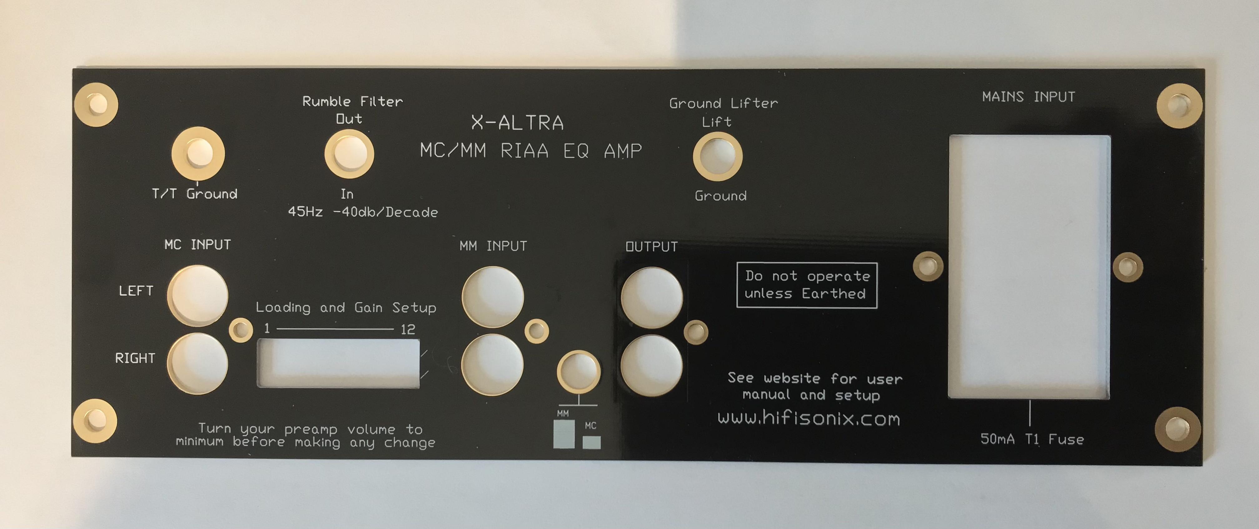

4. Rear Panel - the PCB set (2 boards) comes with the rear panel pre-drilled, with cut outs and silk screened - you have to throw away the rear panel of the Galaxy housing and use the PCB. If you want to machine a rear panel, let me know and I will dimension up the PCB and send it to you separately. The supplied rear panel is DSTHP and gold flashed.
5. Labels. In the download pack I linked to earlier there is a user manual that details the switch settings. Since the rear panel is quite crowded, I decided just to number the switches and then refer to that in the user manual.
Here is a picture of the rear panel

Thanks for the reply.
I hadn't realized that the rear panel was part of the PCB. (In re-reading some of the docs, I can now see this; sorry about missing it.) Very clever: I've not seen such use of a PCB. This then means I've no need to spend more money on machining another panel, thanks again!
