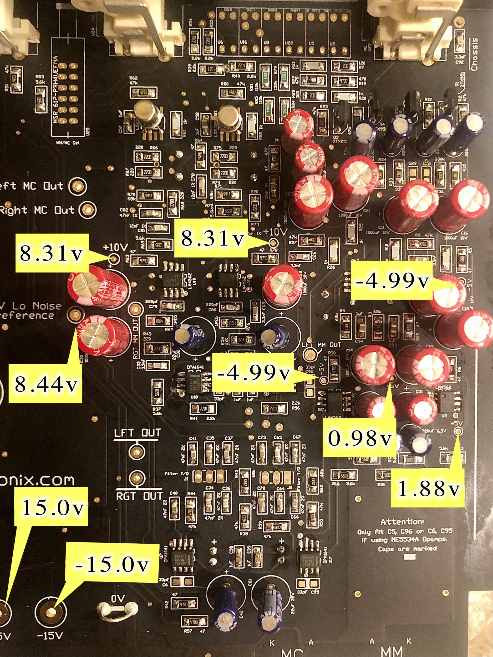

I have +15 and -15 input at the correct pins at all of the LM4562 and OPA1642 so I've mounted them and the OPA2189 but unfortunately I'm only getting -5v in the proper locations now that i have them mounted. My measurements are low where i should have 10v and +5v. My raw ~10v has also dropped down to about 7.5v. I guess I'll have a look at the diagrams for these chips and check the output voltages of each one tomorrow.
Apologies - the regulated +-5 and +10 won’t be present without the LM4562’s.
If you have +-15 at all the opamp pins, that’s a good sign. You must have +-5 and +10 and they have to be ultra clean with zero noise (ripple etc). It seems your +10 V are not regulating. Can you check that all the caps are the right way around - if not they will load the opamp outputs and pull the output down.
Can you measure the voltage drop across each of the 7815 regs. Across input to output you want at least >4V and preferably a little higher to ensure you get no ripple bleed through. If you have a scope to hand, you can check that output is clean as well - ie no ripple and in regulation.

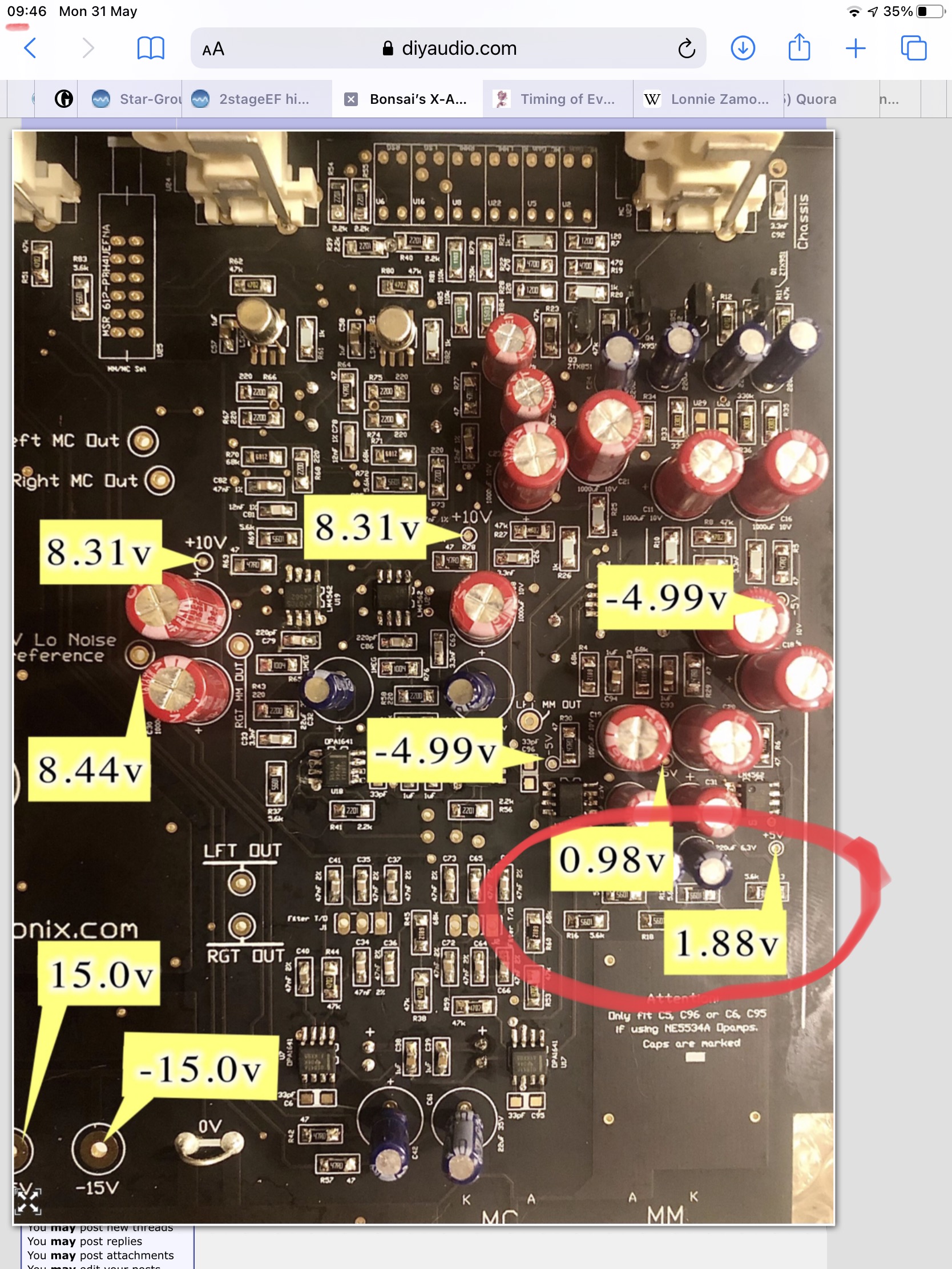

Steve, can you check the voltages across the 5.6 k divider string (ringed in the attached pic). Starting from +15 you should get +15, +10 and then +5. From the -15 V rail, you should get -15, -10 and then -5. All voltages wrt 0 V.
Each 10 and 5 V rail is decoupled with a cap - if any of these are the wrong way around or leaking, it will pull the voltages down. Your -5 V rail looks good (so -10 should be ok by implication) but your +5 and +10 don’t look good - check that the caps are all the right way around and/or there is not a problem with the resistors.
Yes, it looks like something is pulling down the +5v to 1.8v. When i measure across the 5.6k resistors the negative values look good (0, -5, -10, -15), but the positive values are off (+15, +8.2ish, +1.8, 0). I popped the 5.6k resistors off, tested them, switched the positive and negative ones and put them back on with no change of results. They all tested good and I haven't found a bad or reversed capacitor yet. I'm mainly looking at C12, C14, C15, C19, and C20 (as well anything near by that i can think of).
Are U4 and U5 paralleled? I'm now wondering why I'm getting -5v at pin 3 but +1.8v at pin 5 of both of these LM4562's. Any suggestions on other places to look for what's pulling down the +5 would be most appreciated.
U4 and U5 (I assume you mean U3 since U5 is the MC gain setting switch for the right channel) are not paralleled. U4 opamp 2 and U 3 opamp 2 are the +5 V regulators and op amp 1 in the same devices are the -5 V regulators. The regulators for each channel are completely separate.
To move forward,
1. check that the voltages on pins 5 and 6 on U3 and pins 5 and 6 on U4 are equal.
2. Check that pins 2 and 3 on U26 are equal to within 1 mV and the same in U19
3. If the voltages are the same on the pins on each opamp to within 1 mV, the opamps are probably ok and the issue then is that the + side of the divider chain is being loaded down by the caps. To check this remove C15 and then check the voltages again. If still wrong, remove C30.

Success!
Thank you four your patience and kind support. Somehow I had a poor connection to the pad of pin 7 of U4. I was able to rework it and now have a good +5 and +10v.
I was a bit confused about what U3 and U4 were doing in the circuit and why I wasn't seeing +5 and +10 anywhere if both of these are producing separate positive and negative 10v and 5v for each channel. I had been looking at Figure 5 of Part 1 of the AudioXpress article and trying to figure out why i seem to have the same fault on both U3 and U4 though. I guess that the +5 and -5 from U4 are fed in to pins 5 and 3 of U3.
