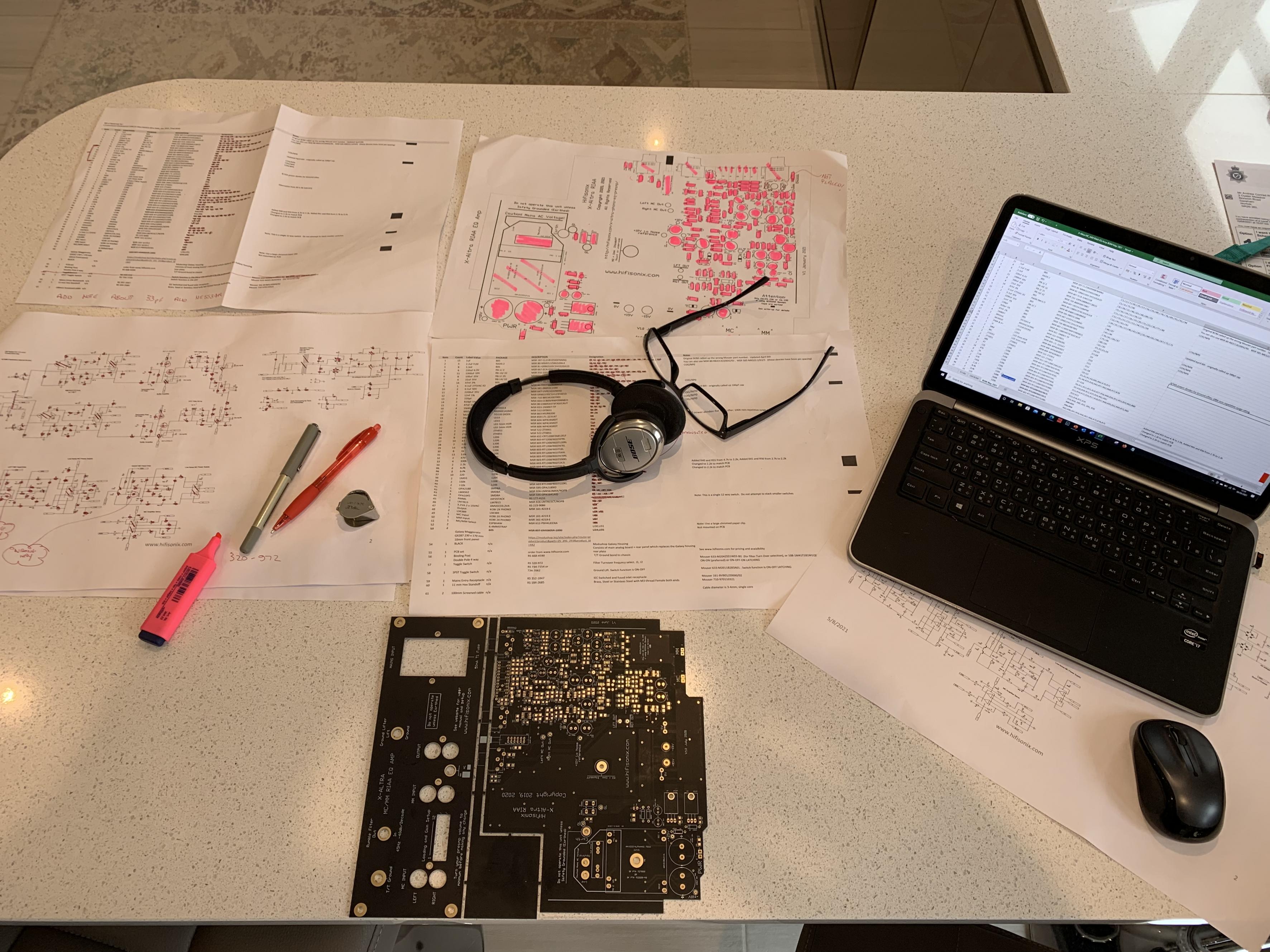

This is my first big advanced project and I have parts confusion already, so appreciate the update because I hadn't seen the convo on differences between BOM and pcb. I have a Mouser order together but I'll hold until I can go back and review the edits.
The BOM has been checked manually to the layout and to the circuit and you can now get a copy in the link below
X-Altra RIAA Phono EQ Preamp
It seems when I did the original, that the part references on the BOM came out of sync with those on the schematic.
Excellent. Thank you for updating the BOM. I'm much more confident to start populating the board now.
