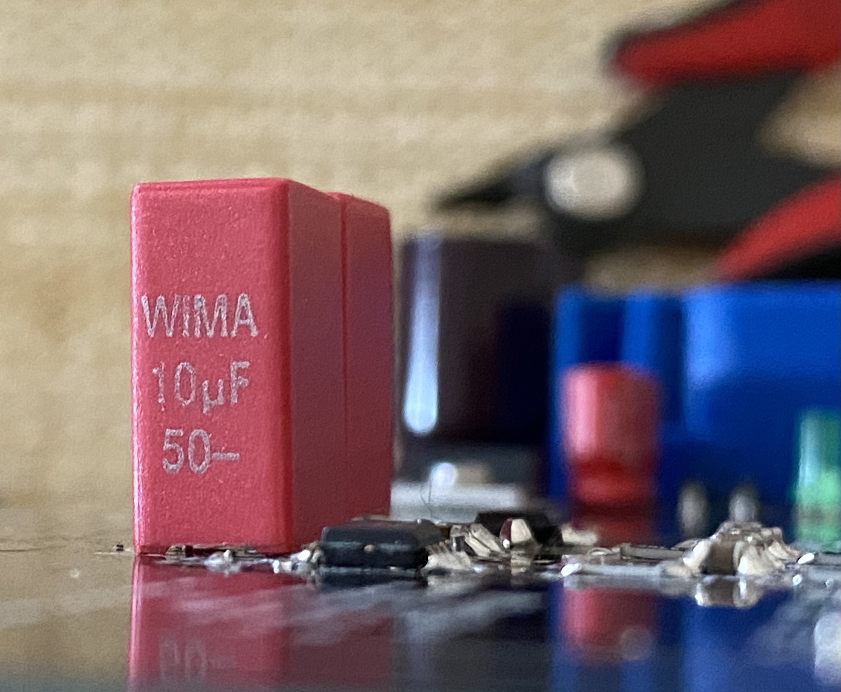

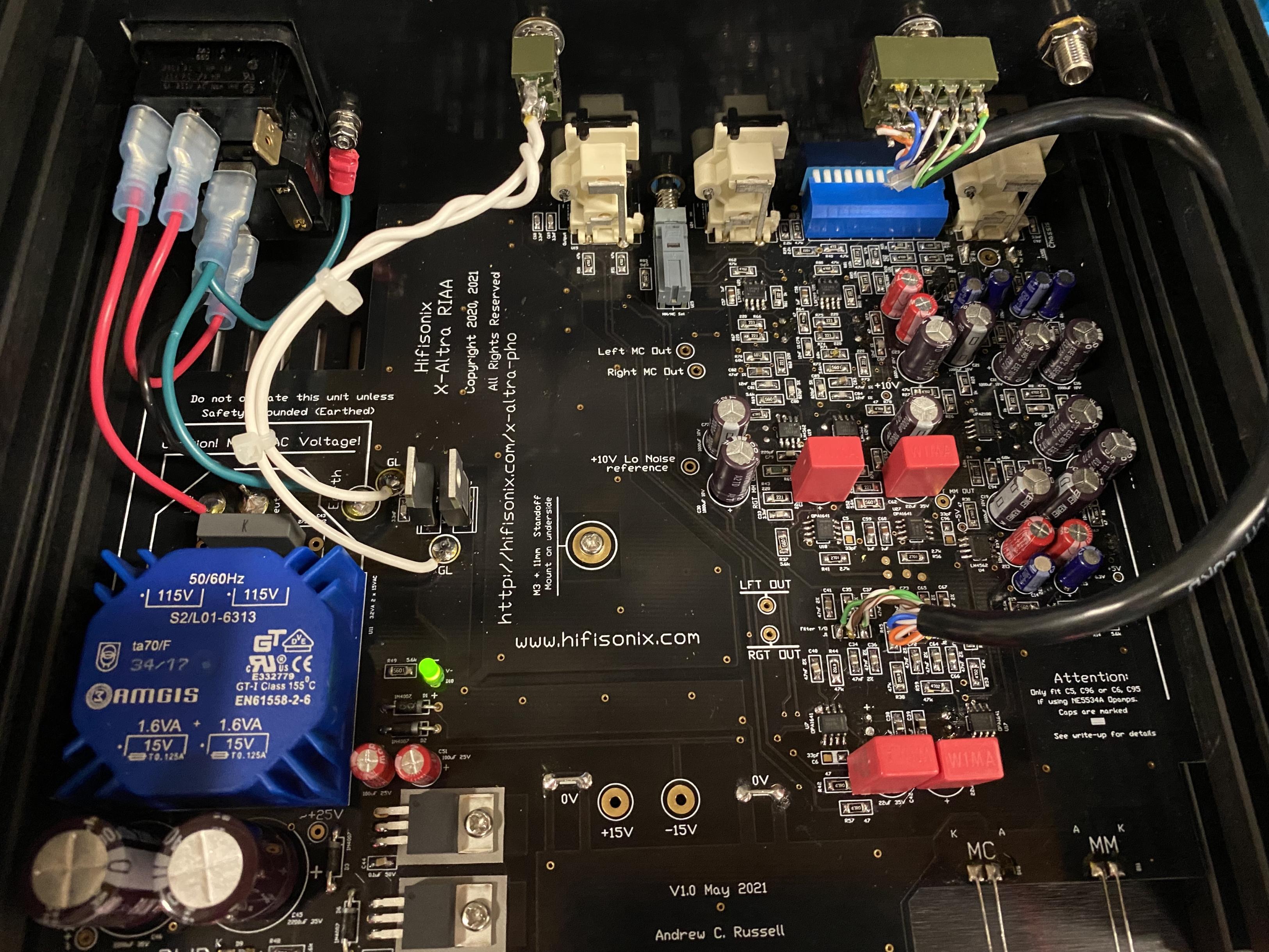

Besides using the CAT6 cable for the rumble filter, I did make another change with one capacitor set, as shown in the attached photos.
I'm not too keen on electrolytics in the signal path, so I substituted a WIMA 10uF/50V film capacitor (Mouser) for each of the four 22uF/35V bipolar caps. These have almost the same lead spacing (5 vs 3.5mm; I could not locate any in stock at Mouser with sufficient capacitance and voltage rating with a 3.5mm spacing). A slight lead adjustment with pliers to one of the pins, making the spacing closer to 3.5mm, is required prior to better fit into the PCB.
If I've calculated the f3 correctly, the spec'd 22uF/5.6k should be at ~1.2Hz. With 10uF, this increases to ~2.9Hz, which is okay with me (and not at all a factor if the rumble filter is engaged).
If 20uF is preferred, another set of the same capacitors could be soldered on the bottom of the PCB in parallel with each topside WIMA cap. Each would need to be placed on their side (they're 7.5 x 11mm square with a 16mm length).

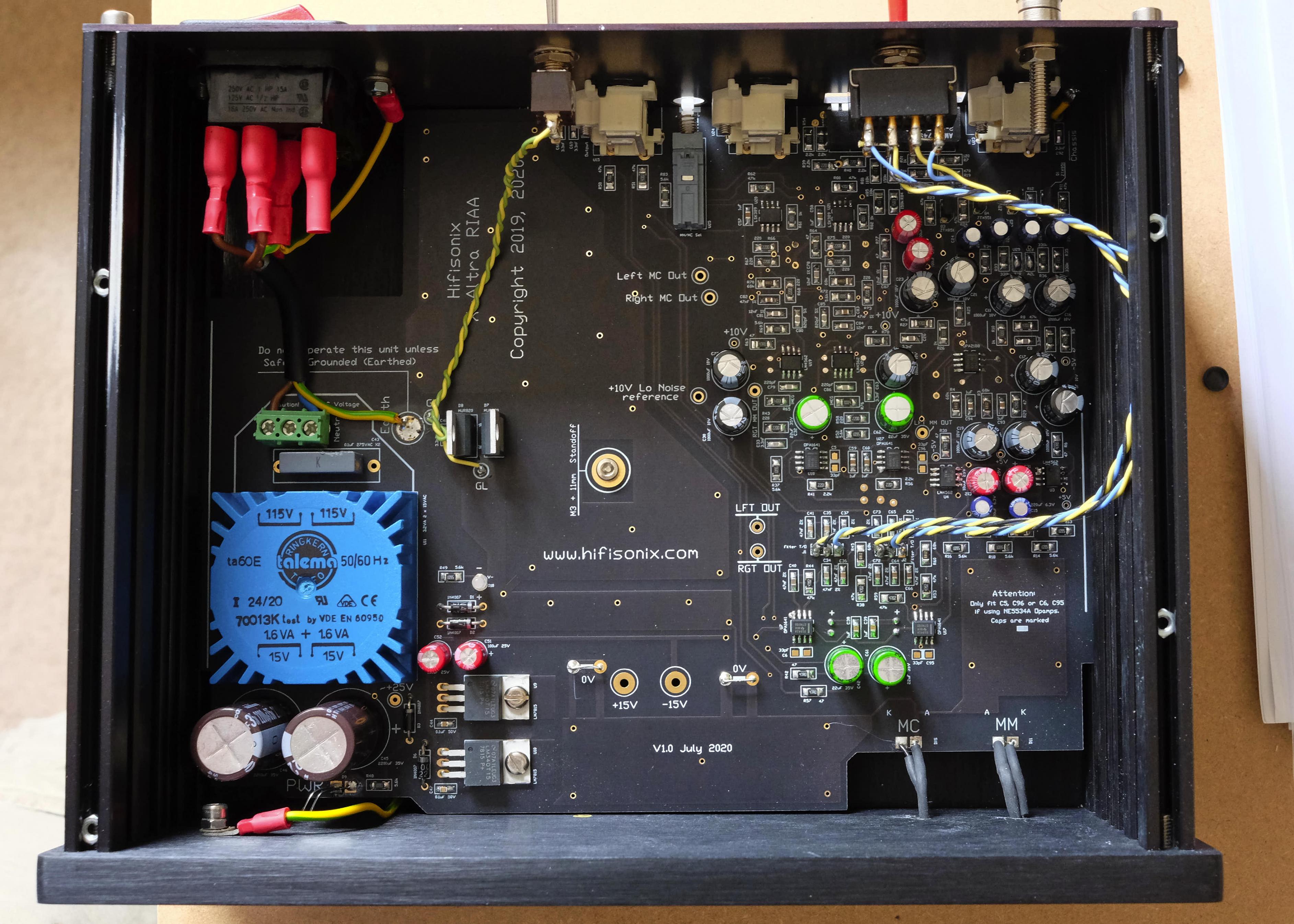

Terps: I forgot I had this photo of the whole PCB, in the upper right corner beneath the MC jack, you can see the shorted RFB1,2 pads (I only realized these needed jumpering after everything was assembled and in the box, so not the neatest job).

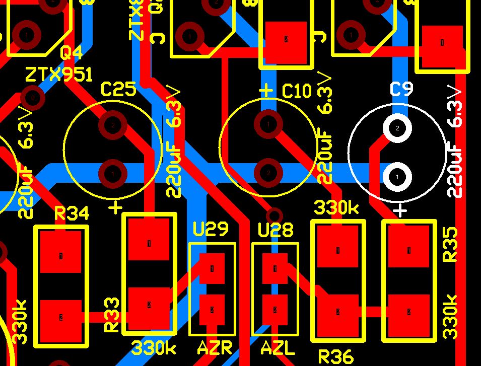

My is working just fine (I posted image in #201). I have no way of knowing about earlier versions, but I rather doubt a change in polarity. Those issues are usually sorted out pretty early.
I believe I did read in earlier posts about an inconsistency between the back and front of the board with respect to cap polarity, but that the front was correct. You'd have to re-read earlier posts to see if any images matched your PCB date.
I realize that there are different dates on the PCBs, but all seem to say "V1.0", which is a bit confusing.

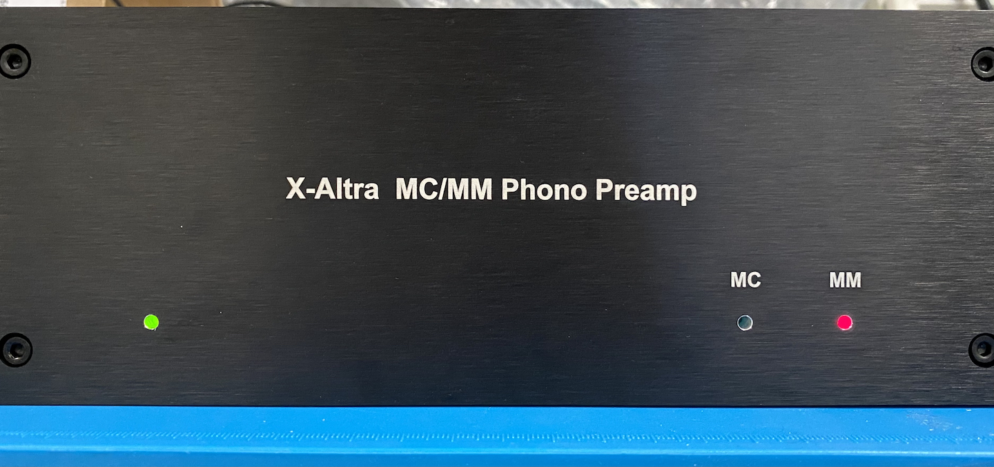

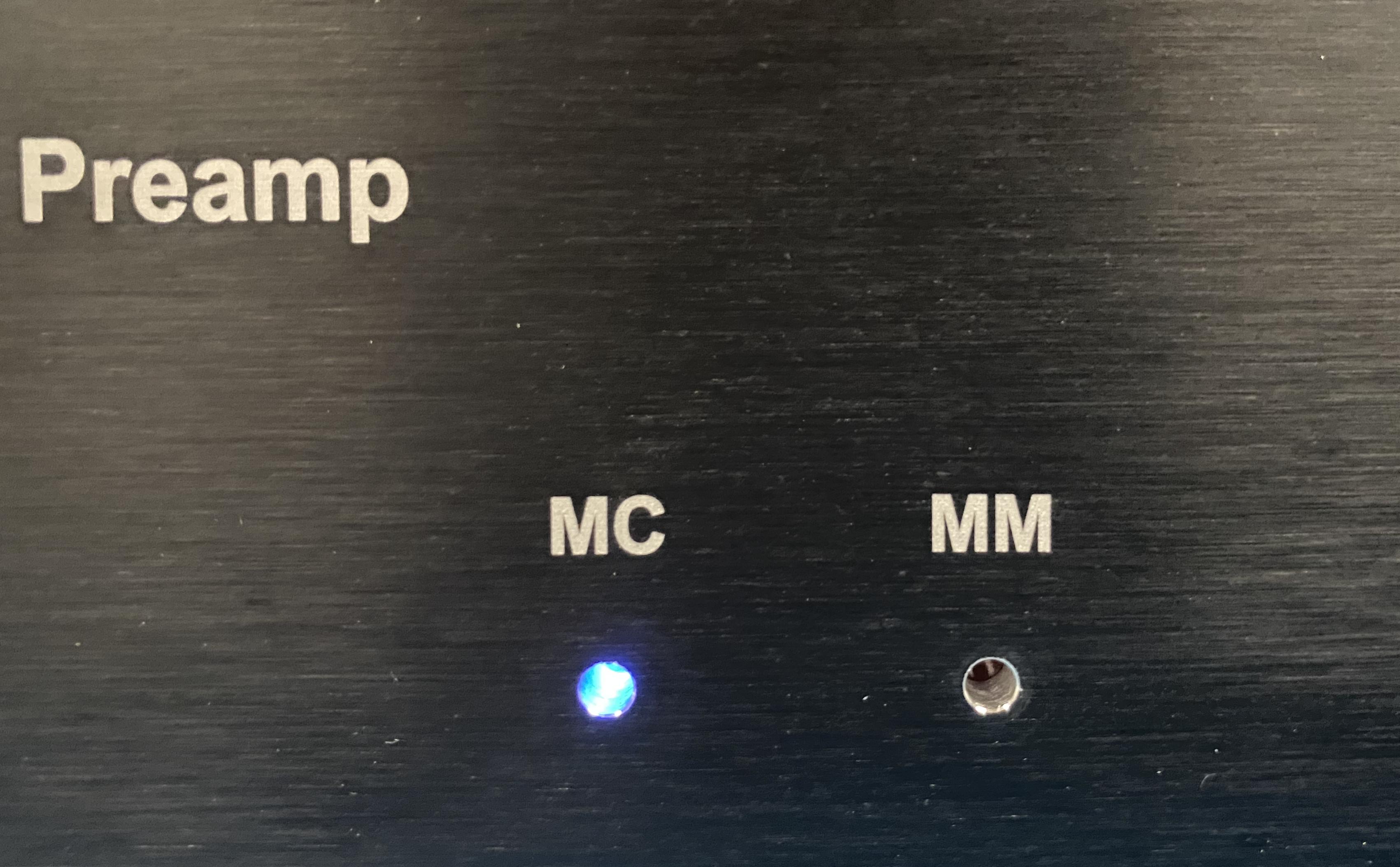

The front panel engraving, done by a local shop, was finished (LED holes were sized to 3.1mm). Attached is a photo of it on the assembled cabinet.
I did change the LEDs to different colors: green for power, blue for MC and kept the red for MM. I also added a 10K resistor in series in one leg of each LED to reduce the brightness.
In addition, I printed out the image for the rear panel switch from the "X-Altra User Instructions" PDF file. I then taped it to the top of the cabinet: not elegant, but it works (I know I'll forget the switch functions in a few weeks).

Thank you. That picture is helpful.On both C9 and C25, the cap +ve faces towards the front side of the PCB which is to the bottom in the picture below.

Quick DIY tip. If you drill holes in black anodized aluminum for LED’s, you can sometimes see the light aluminum edge around the hole. Use a black permanent marker to color the edge. Just hold the pen tip at 45 degrees and run it round the exposed corner.
This will ensure there is no silver edge to the hole and improve the finish and look. .
