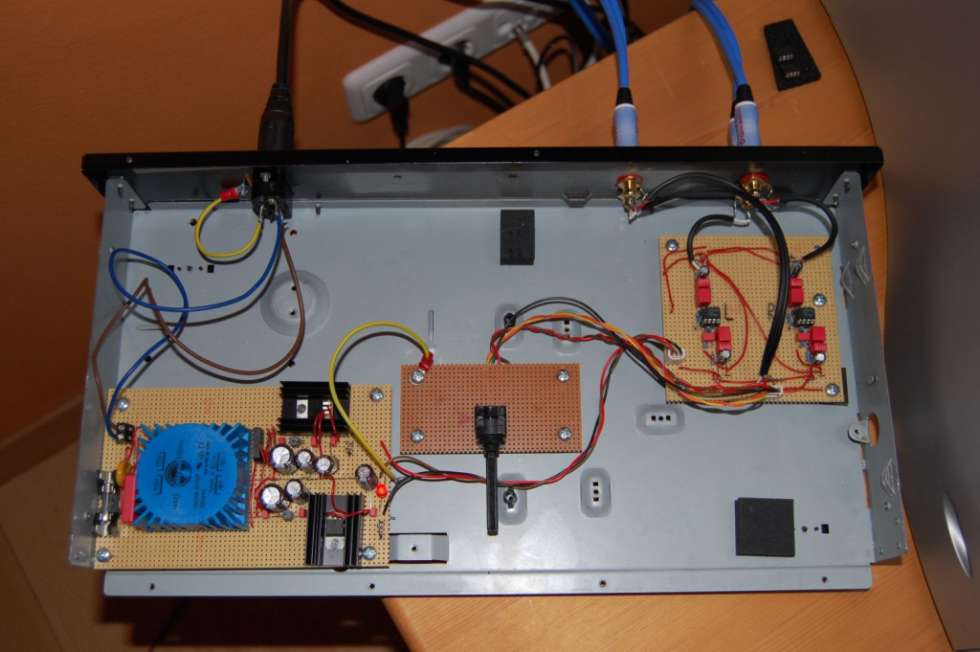

Hi folks,
burned down the right channel of my Alps Motorpot because I plugged my opamp the wrong way (1=8). Sh..! 23€ away.
When I grounded the input section I got noise on the speakers which I had not before (without the ground). What went wrong?
I think I have to pause until I get a new Alps.

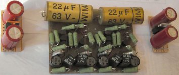

legarem said:Hi Simon
What kind of discrete circuit did you use
Can you show us the schematic ?
thanks
Legarem
Hi Legarem,
It was designed by Ray/6h5c of this monster thread http://www.diyaudio.com/forums/showthread.php?s=&threadid=54009&perpage=10&pagenumber=1 (700+ pages!)
It's class a and uses FETs. It also has the passive filter onboard. I used decent parts - Kiwame 2w resistors, polystyrene caps, Elna Cerafine psu caps. Blows even the 4562 away...by making every cd sound enjoyable! It always finds the best in a recording, as well as showing what's wrong, but in a benign way.
I can't find the schematic right now, sorry.
Simon

Route the lines from the mains socket along the edge of the cabinet -- don't let them dangle in space.
If you have RFI you'll need to bypass the power supply rails of the opamps with 100nF ceramics. You could also place a 220pF mica cap across the input lines of the preamp, ferrite bead on the input to the opamp, etc.
Here's a few.
- Make the path between the opamps and the pot a LOT shorter.
- Close the lid of the enclosure (with the front in metal mounted).
Just to make sure that the interference is comming from the curcuit. Try to short the input and listen, is the broadcast still there now ?

Hi
after I got a new Alps pot, I soldered it directly on the preamp pcb. That worked. Now the sound is perfect. Rich heights and mids, well controlled bass. And no noise or strange radio stations.
Thomas
Hi
Thomas
