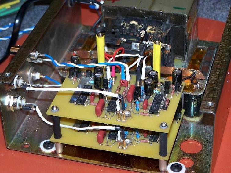

MikeBettinger said:
The offset from the first stage is being aggravated by the second stage, which I also increased the gain on to better suit my cartridge. I would assume this is the reason a servo was added in the application note. I don't like the sound of servos, though.
Mike.
Do you have a schematic?
hags said:Do you have a schematic?
http://www.national.com/an/AN/AN-1651.pdf. This the link to the application note. I was looking to build a sort of baseline design to use as a reference for a discrete FET based MC amp. This seemed to fit the need. I did not use the power supplies or the servo, just the main MC circuit. I designed the PCB for OPA27's but decided to try the single chip versions of the National chip after reading good things about them.
Mike.

I think the output offset will be far too high without the DC servo.
A high grade capacitor at the output won't degrade the sound any more than a DC servo...I beleive.That circuit will take some time to design the pcb
Anzgar said:I think the output offset will be far too high without the DC servo.
A high grade capacitor at the output won't degrade the sound any more than a DC servo...I believe. That circuit will take some time to design the pcb![]()
I haven't found a 100mv of offset to cause a problem, maybe a small tick switching to the phono. Sonically no.
I already have designed the PCB. See attached.
Regards, Mike.
if there's .1 v at the output of the preamp and you have 30X amplification in the power amp it would mean 3V over the loudspeakers, but of course there's the attenuator beetween.

I think those of you with amps without input caps know about it... because you took em out on purpose..... but for the rest 99% of amp have a cap right at the input anyway......
100mV on a buffer which may only be passing 1V... is quite a margin though... and I would suspect it needs some adjustment somewhere...way off from datasheet that....

I have a wet slug tantalum bypassed by a paper dialectric film cap on the preamp input so it's not an issue. Best sounding combination I've come up with over the years.
The board program is supplied free by ExpressPCB. Four boards cost less than $100. without silkscreen and soldermask. Great if you just want to bang something out and try it.
The second set will get the OPA627s and I'll recycle the power supply portion of the layout and insert a discrete design for my next attempt. Sort of an apples to apples comparison that way and easy to back up. I'm able to unplug the existing PCBs and plug in the next contender.
