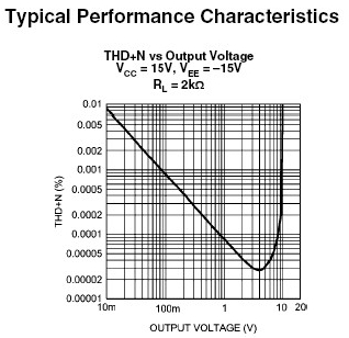

Hello
Looking at the data sheet graphs of the LM4562, the THD+N vs output voltage show a very big raise of distortions at low level output and it should be higher in a dynamic situation, this is a sign of high crossover distortions.
Any though about that ?
I can not access the Bob Pease article on the LM4562, does he say anything about that high crossover distortions of the LM4562 in his article ?

gaetan8888 said:Hello
That curve is consistent with 1 microvolt input noise. Do you have the input conditions for the test?
Indeed. 1uV noise at 10mV input signal is 80dB S/N ratio, which translates into -80dB THD. Exactly what the data sheet says. Nothing to do with xover distortion.
Jan Didden
Hello
Yes, a part of that low level thd+n are the noise floor, but with a typical input noise of 2.7 nv at 1 khz the raise of thd+n whould not start at 5 volt but at a lower output voltage less than 5 volt ?
Thank
Bye
Gaetan
