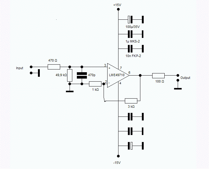

Hi there!
I have build a preamp with the LME49710 (single version of LM4562). The sound is very rich of details but has a lack of warmth and deeper frequencies (under 1KHz). So, voices seem to be a little bit to thin and a bass guitar vanishes often of the sound spectrum.
So, does anybody have a well working preamp circuit for the LM49710? Mine is too thin.
Thomas
Thomas
Hi Thomas,
your schematic is missing one ground connection for feedback and input-network.
Guess this error is on the schematic only?
Regards
Jürgen
Regards
Jürgen
juergenk said:Hi Thomas,
Regards
Jürgen

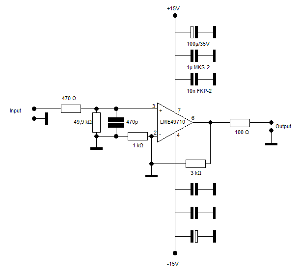

Hi Jürgen,
you are right. On the original circuit they are grounded but because I am no electrician but a business man I haven't seen the mistake but funny, it works although!
The drawing is exactly how I have connected the parts so the mistake is in my circuit, too!
What will be the effect when grounding correctly? More bass? With OPA604 there is enough bass!
Regards and thanks
Thomas
Hi Thomas,
some signals may pass through, but thats not the real thing
the ground connection is needed for proper operation
regards
regards

no, the circuit simply does not work as it is meant to be without that groundTolu said:
Do you mean the switch-on-plop of the loudspeakers e.g. as a reason for missing grounding?
that some music got through and you like or dislike it, doesn't mean anything
for any judgement on the opamps you need a properly working circuit first
regards
Tolu said:Do you mean the switch-on-plop of the loudspeakers e.g. as a reason for missing grounding?
Please look at the diagram on here (Noninverting amplifiers) and compare your schematic:
http://ourworld.compuserve.com/homepages/Bill_Bowden/opamp.htm
That might help you to see where your schematic is incorrect.
Regards
Simon
