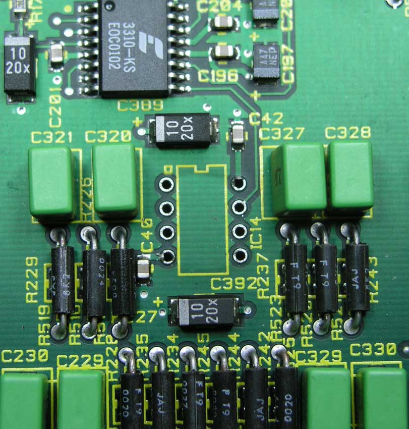

Hi Folk!
I've may be a "compatibility" problem using a LM4562 in a circuit designed for an OPA2134. It's at DAC output (AK4393), the next circuit in the chain is an CS3310.
The sound is very detailed but metallic and flat. If I replace it with an AD8620 or an OP627, the sound is ok. PSU is 12,5v. I don't have the schematic yet. I've to trace it.
After, the CS3310, I have another op-amp. If I replace the original OPA3134 with an LM4562, I don't have the same symptom. All seems fine (more detail, better bass, good sound).
Any idea ?

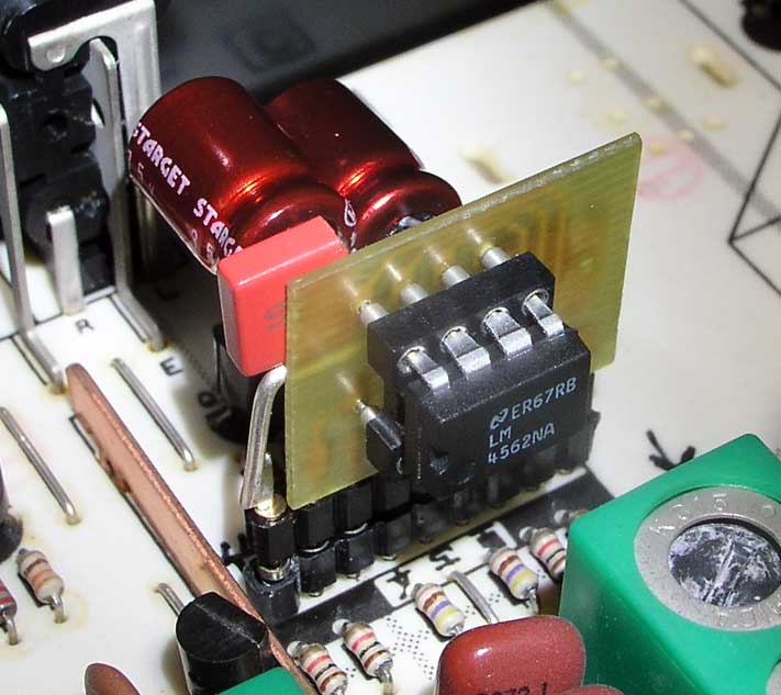

So what are the bypassing requirements of this opamp? In typical National style the datasheet makes no mention of this. There is one example of a phono preamp in the datasheet with 47uF bypassing but thats all! No technical discussion of this important topic at all in the datasheet!
It seems that the good config is 100nF + 47uF stick to the op-amp.
I made some test tonight.
nothing : hyper chirurgical and flat, lot of details
100nF : again too chirurgical, better bass
100nF + 10uF : same case 2
100nF + 47uF : the best (a little grainy but less than OPA2134)
