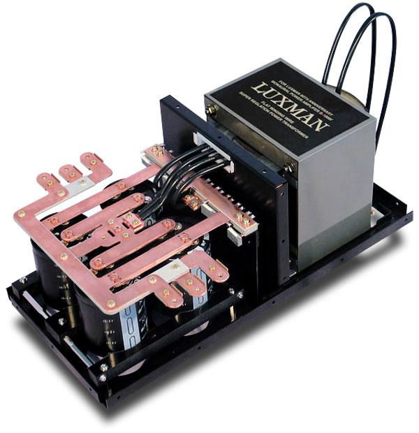

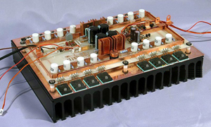

RAIL TRACKS - read this , Enduring Class B layout mythology
I always suspected this , in my study of the hundreds of OEM's (pro amps). Even in the luxman m-800a ($16K) or B-1000f ($30K +) - below 1-3 , you will find no twisted wires or other "voodoo" ... lots of copper , but no "myths".
PCB has layout similar to mine augmented with copper bars (below 3).
I have schema's for BOTH. Those luxman's use a refined hawksford cascode ,8 pair toshiba BJT - triple OP , hence my revival of it (LX -with cordell's "DBT") cool:

I just read Ostripper's link about class B PCB mythodology. It looks like running the power rails close to eachother is not the full Eureka after all.
We might add that running power rails close to eachother includes a warning. Say each rail is about 75V, the potential gap between them is 150V. Running them just some mm apart from eachother is not safe as (in worst case) it could cause arcing.
It is true that in class B operation induction field cancellation (caused by the high currents) is not possible.
As this is about the induction field or current field
Is tension or voltage field of any importance? Is cancelling here of any importance? This is out of my knowledge but if anyone has the right answer it would be nice to know

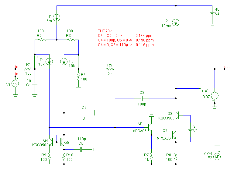

improving psrr
I'm aware of this, but then they also affect open-loop gain. It's been years back since I've looked into this, but IIRC the effect was gross enough to make the technique unusable.
Samuel
At frequencies of interest the effect is virtual zero (at least in this application). Even at 10MHz the OLG is only 0.4dB less. Is that what you call gross enough to make the technique unusable?
E.
Hi Samuel,

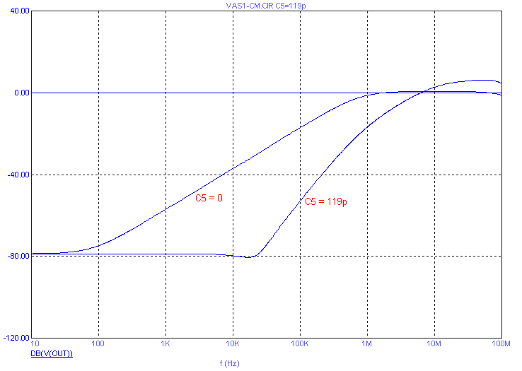

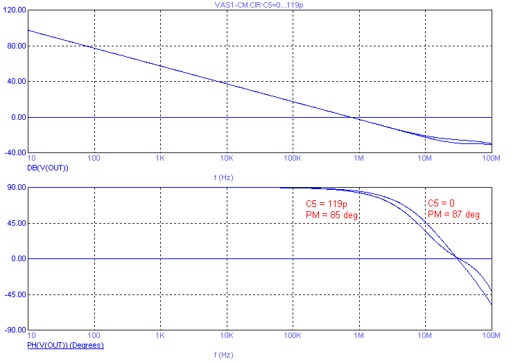

Here are some simulation figures. Indeed, the PSRR cap has some effect on the phase margin, but not that much. In the test circuit as shown below (fig.1), only two degrees (fig.2). You also worried (in a PM) about extra distortion, induced by nonlinearities of the current mirror. Well, you are right. Distortion does increase, that is, if the cap is connected as previous suggested (see C4). In this case the THD20 rises from 0.144 to 0.198 ppm.
But if we tie this cap to the emitter degen. resistor of the current mirror (see C5), than the distortion drops to 0.115 ppm. 😀
Fig. 2: Gain and phase response of the global FB loop.
Fig. 3: PSRR of the negative rail.
(Trannies of the IPS and OPS have been replaced by ideal components to avoid swamping by distortion from other sources.)
E.

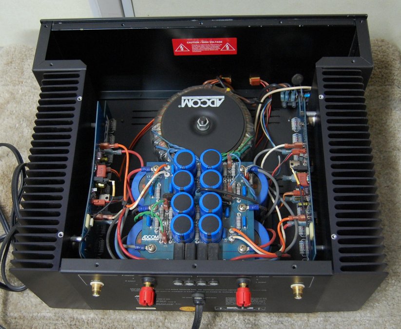

223625d1305911976t-fixing-adcom-gfa-5500-20db-bass-attenenuation-both-channels-1023.4.jpg
Do they feel that the gains obtained by doing so are too trivial to include in their products ? A common practice where there is NO wiring (all PCB traces) is to run the rails together along the path they take on the main amp board. The ground(s) run separately , not to be contaminated by the rail fields (or the larger "summed one"). It was these real world observations that lended credibility to GK's argument.
Personally , I'm open to any improvement.
Please comment on your triple (my post with the "DBT" question) ... thanks 🙂
OS
If those two rail wires are twisted together, their magnetic fields will ADD, resulting in a linear magnetic field representative of the signal. This sum will have very little distortion in it. The same argument holds for having the P and N parts of the output stage in close proximity, such as by physical interleaving of the output devices, so that their created magnetic fields will tend to SUM to a more linear representation of the signal.
Bob

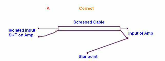

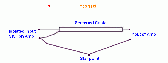

Lifting grounds in general.
A lifted ground by it's very nature is a Quasi ground = not true ground. And further to my earlier discussions about having a driving signal/s "reference point" i'd like to present what i believe to be the correct & incorrect way to screen signals.
The A image i've drawn fully screens the signal, & prevents earth loops etc. The B image is ineffective at screening the signal.
Thoughts etc are most welcome.
