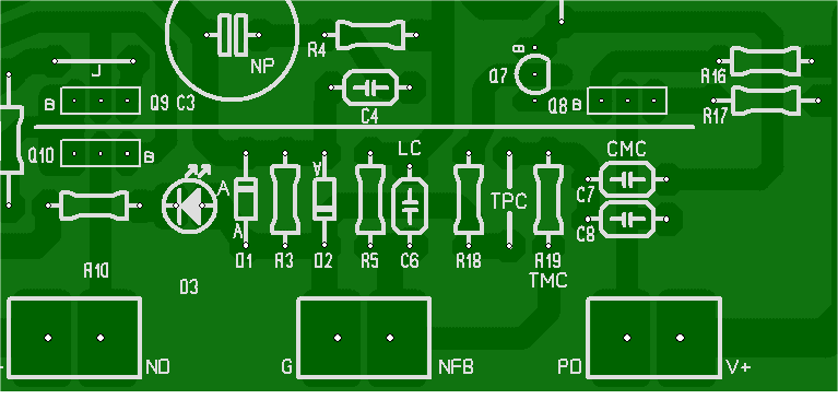

In light of this , would (below 1) be okay ? Or would a shielded cable be better.
Purple wire (NFB L/R) only crosses low imp. areas. Rails are at the sides (orange/red). BTW , that is the TMC'ed "bobamp" (or blameless).

Its a little hard for me to see exactly what is what. These may be dumb questions on my part. What is "cap mux". It looks like the input/driver board is separate and perpendicular to the output board. Is that right?
In the context of a single-board amplifier, I would generally try to run the FB line as a trace, perhaps guarded. On a two-board design, I would be inclined to run it as a shielded cable with one end of the shield connected to quiet ground. I would probably place a 100 ohm resistor in series with the output signal before it enters the center conductor of the shielded cable for short-circuit protection if nothing else. Then the NFB resistor would be at the other end of the shielded cable, near the input stage.
BTW, if your NFB resistor is 39k, this looks a bit high for noise and maybe even HF considerations. This would make the feedback shunt resistor on the order of 1-2k, making the impedance there a bit high. That node on the input LTP likes to be fairly low impedance. I often use a feedback resistor on the order of 4k-10k in many designs, even though this makes it necessary to use higher wattage resistors in the FB network. This, of course, is more practical in designs that use DC servos, else in some designs the NFB shunt capacitor can become rather large.
Bob
I would think the best approach is to place the junction of the feedback resistors (upper and lower arms i.o.w.) right at the inverting input. If you have any length of trace between the junction and the inverting input this can pick up noise or EMI (capacitively or inductively coupled), it will be amplifed by the full loop gain of the amplifier. A similar train of thought applies to the input filter circuit on the non-inverting input. In this case, noise pickup between the output of the filter and the input proper is amplified by the closed loop gain of the amplifer. All in all, very ugly stuff if you are shooting for a low noise design.
cap mux = cap multiplier i would think

I realized after posting this that Ostripper likes to include multiple compensation schemes on his boards which he can switch between for comparison. That's probably what the cap mux is.

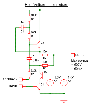

On to my question - I'd like to try building up a SS amp to directly power some electrostatic panels. Let's say with rail voltages upwards of plus/minus 500 volts or more. Possible or not???

Most ES speakers drive the two outside 'stators' in opposite phase from a balanced output. Most use a step-up xformer from a regular amp. Direct drive has advantages, but also disadvantages, the obvious one being the need for high output voltages. The quoted 500V is rather low; in my own ongoing design I shoot for +/-2kV RMS.
The moving diaphragm, sandwiched between the stators, is biased to a high-voltage to obtain a high static field strength to increase efficiency, typically to anything between 2 and 8kV DC. The diaphragm is made high impedance so that the speaker, really a balanced capacitor, operates at constant charge which linearizes the excursion vs drive voltage function.
It's a lot easier if you go for a class A design. This allows you to use only NPN (or N channel) devices in the output stage, and does away with the need for high-voltage driver circuitry.This is a tall order. I'd lean toward complementary MOSFETs, but the highest voltage P-chaanel MOSFET I know of is about 400V. If you stack two of them and pair them with stacked N-channels...
Then there is the high-voltage IPS/VAS circuit...
The circuit below could be a good starting point. ESL stators can be capacitor coupled or just left floating at +500V, assuming negative bias in the diaphragm.

Oh , linguistic semantics aside ... I know it is a multiplier. 😀 Bigun threw "MUX" at me and it "stuck".
Statement is a oxymoron but I will respond. Loop area won't increase (below 1) multiplier in/ out is 1.5CM (euroblock/ ksc3503/back to euroblock) decoupling goes to "clean ground" for separate voltage stage supply. Shrunk the multiplier down to 17 X 17mm. At the real estate required for a 1000uf/100v cap , 15K of emulated capacitance (100u X 150/3503-Hfe) is obtained along with 10db+ of PSRR .... not too counter productive. Less so than $100 cables or silver wire. 😱 PS= total cost , about $3.75 per amp (2 mults. for IPS/VAS stage). Way better deal than $200 "bybee power conditioners" (audio shampoo included).sounds feasible also. wouldnt this increase the loop area and be a bit counterproductive?
Yes , I have the full TMC/CMC/TPC - earth or rail blameless option on my "AX". TMC is the most "pleasing"(vas= lowest impedance).

On that question, a pix will suffice (below) ... no long loops , just omitted components and a few jumpers will get any comp. scheme. 🙂
Hi Godfrey,
This looks like a great suggestion. Probably do-able with N-channel MOSFETs as well.
However, as with any class A design, what about power dissipation? Understood that the input impedance of the panel is high at low frequencies and primarily capacitive, but what is the capacitance and how much current is needed to drive the electrodes to the necessary very high slew rate at high frequencies? This might require a rather high class A bias current, and at these voltage levels dissipation will add up fast.
