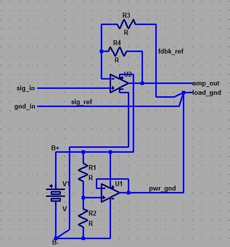

Jan, if there is any coupling in the feedback line, the fb resistor would attenuate the coupled signal also if it is at the input end. Also, if the output coupling is magnetically induced, wouldn't it couple better to a low impedance path? If the fb resistor is placed at the output end, the fb line would have a lower impedance back to the input stage, the impedance being effectively the lower shunt resistor absent the series resistor.
Also, if noise is coupled to a signal line, wouldn't it have a better S/N ratio if the signal voltage is larger (i.e., not attenuated first)?
I drew this for headphone amps with active gnd but I think the location of the star gnd is relevant for common impedance coupling
magnetic coupling would appear to be made more linear if the +/- power trace is "common centroid" or low loop area - interleaving N/P output Q physical positions may drive assembly people nuts but may be "better" from this perspective

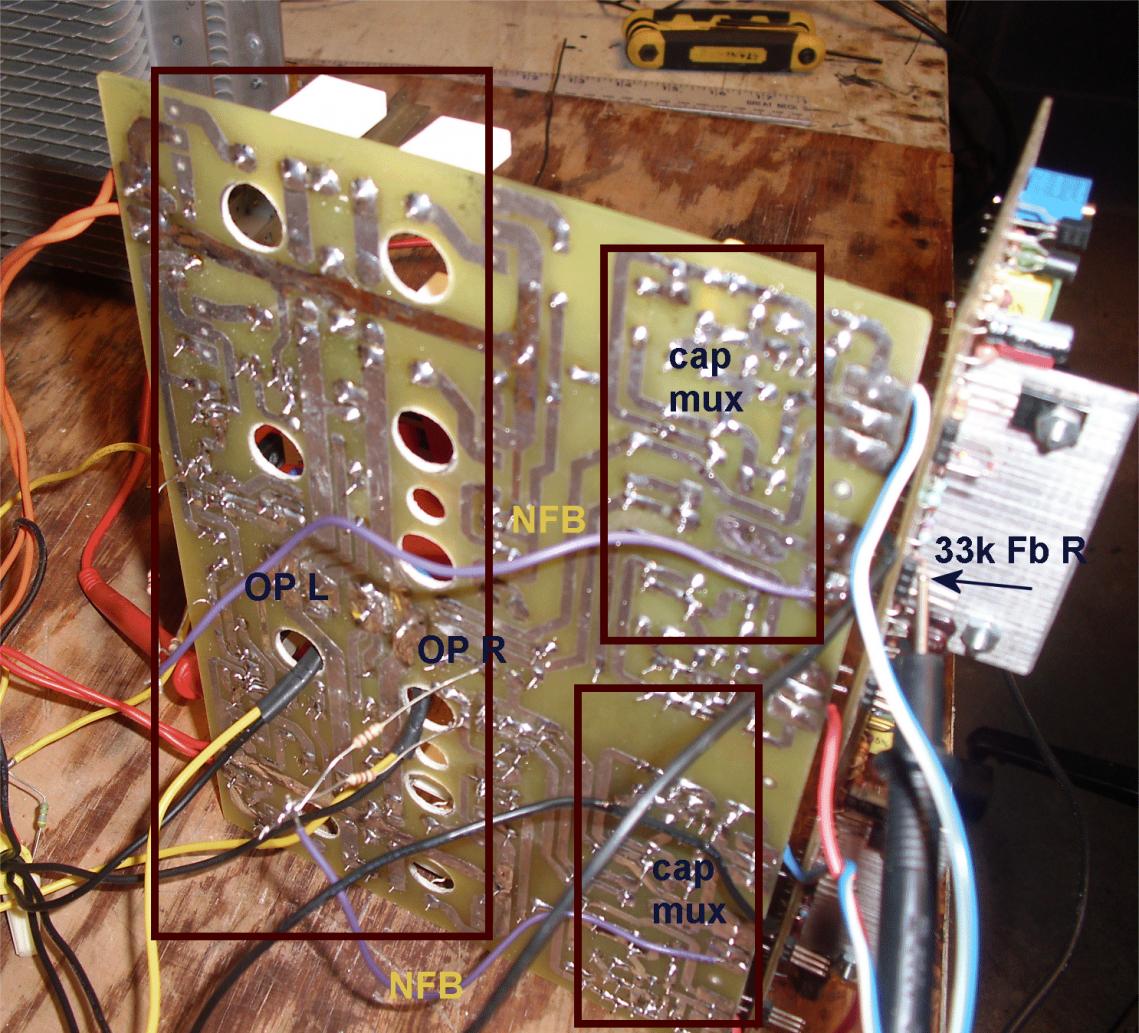

My suggestion of routing the full-amplitude output signal back to a feedback network that is in close proximity to the input stage is mainly because a given amount of noise induced in to a line carrying a higher voltage will have a lesser percentage effect.
Bob
In light of this , would (below 1) be okay ? Or would a shielded cable be better.
Purple wire (NFB L/R) only crosses low imp. areas. Rails are at the sides (orange/red). BTW , that is the TMC'ed "bobamp" (or blameless).
