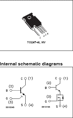

Aren't they scary expensive? A quick look in a local online catalog shows quite a few cheap but usable devices e.g:
- MOSFET 1500V: $5
- BJT 1500V Vce: $2
- IGBT 1700V: $4
- ESBT 2200V: $6 :scratch:
How about that - I just learned something by mistake. I'd never heard of ESBTs before. 😱
Hi Godfrey,
I don't recall hearing of an ESBT before either. What are they and what does ESBT stand for? Electro-Static Bipolar Transistor???? 🙂.
Bob
Yes, that's it. basically a low-voltage Mosfet cascoded with a high-voltage BJT.

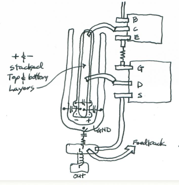

Bob,
I like to draw up diagrams to try out layouts before spending a lot of time with the PCB software. I drew up the attached to see if I could turn your words into a picture. I haven't shown the P devices, but they would be mirror image of the N's on the left side of the power. I've stacked the + & - on the top and bottom layers of the board, an ringed them with ground. The feedback would be shielded wire with the ground connection for the shielded wire being at the other VAS end where there is clean ground. Other changes might be moving the inductor off board. What do you think? Does this make sense, or should the + & - be side by side with the ground below both of them?
Ken
p.s. I goofed up the post and will have to attach the image in the next post.
I found this link http://www.st.com/stonline/books/pdf/docs/12830.pdf
Maybe it is this. Hybrid emitter switched bipolar transistor. ESBT.
David.
Very interesting part. However, look at Figure 12, the reverse-biased SOA curve - the chart is blank.
It is a bit unclear how this device would fare in a linear application with regard to SOA. Maybe I'm missing something in the datasheet.

Bob,
Ken
Hi Ken,
I like the idea of the plus and minus rails being stacked one on top of the other on top and bottom layers. Which layer is the ground on? It sounds like your plan has the feedback cable's center conductor and shield straddling much of the output stage. This is probaly not a good idea if I understand it correctly. I would ground only one end of the feedback shielded cable and that would be the end near the input stage. I'd probably also lean toward a design that gets the P side and N side output transistors next to each other rather than across from each other. I also like to put the temperature sensing diode between the two output transistors (or in the middle of an array of several output transistor pairs). Don't forget the resistor across the output coil. I think you can go either way with the coil on or off the board.
Bob

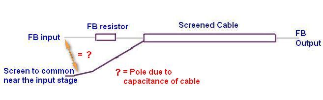

Hi, admittedly i havn't been able to read all the posts, or seen the circuit diagram, 🙁 so forgive me if i appear to intrude somewhat, but i felt compelled to post, if only to possibly gain some insight, as well as "hopefully" offering some.
Re -
I tend to agree, as that "might" induce more nasties than it keeps out ? A dedicated quasi smoothed common "could" be created that "might" serve that purpose ? Or just run a non screened cable, but clear of any inducements.
Wouldn't doing that negate any desired benefits, as i would have expected a driving signal to accompany a driving reference point, ie common/ground near the drive ?
Also would that not create a pole with the FB resistor ?
I'm picturing your proposed setup to look like the att.
Regards

Hi Zero D,
A short length of coaxial cable will probably be in the low picofarads. Such a small capacitance driven by a low impedance source like an output of an amplifier would be hardly noticeable. It's a shunt capacitance to ground. Now if the capacitance were on the other side of the resistor it would be significant. This is another reason why it's better to do it this way, rather than placing the FB resistor near the output and connecting through a shield back to the input.
David.

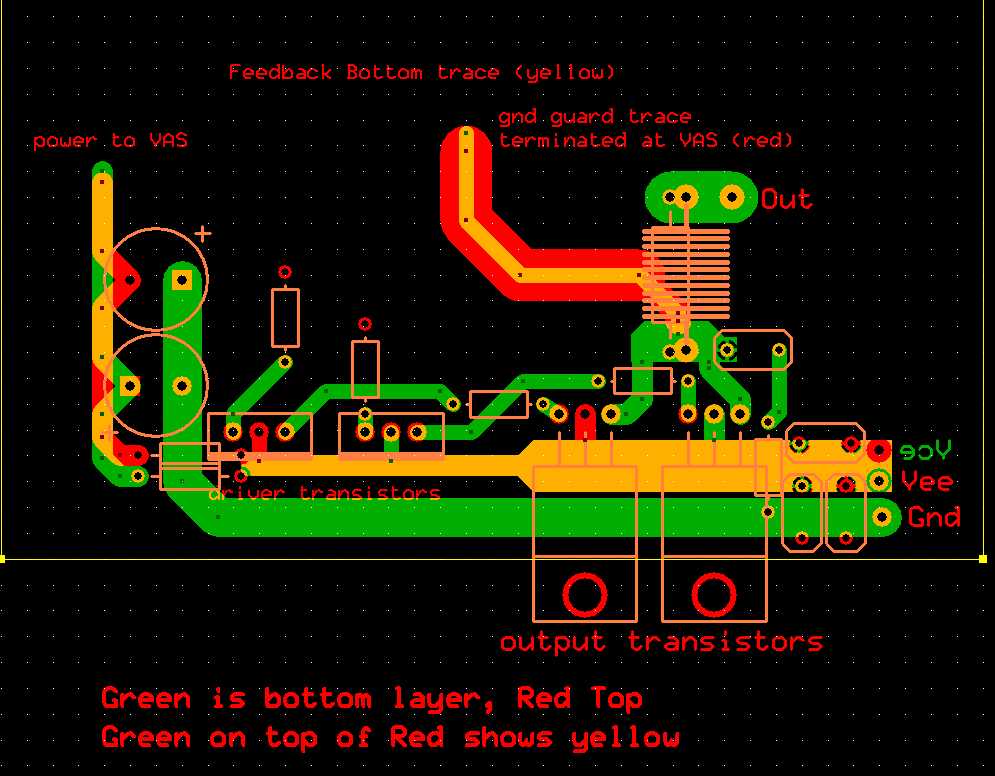

Bob,
Thanks for the critique. I revised the layout, I think this is better, but would appreciate any and all comments. The feedback trace could be a shielded wire as Bob has already described. Not everything is to scale, such as the output transistors at T-220, more of a diagram.
Ken

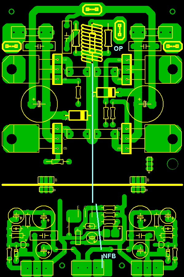

Run the OP signal on the shield, as well ... effective. I just run a stupid "purple wire" across my low imp. output board (below - blue line) , no issues. 🙂

rail tracks
Hi all,
I like the discussion about the rail tracks.
First, it is very handy if you use a mirror image topology where the IPS current sources are fed from the opposite rail. Having them both on either side allows you to minimize tracks having to cross your pcb vertically to reach the other rail.
I think also that having them near eachother reduces V gradients sa they will annulate eachother to some degree. Same counts for induction fields caused by currents.
Ringing them by ground is good. I guess to use the DC decoupling ground node for this and not common ground and off-course not signal ground 🙂
