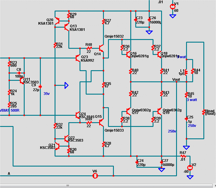

Bob , my question is about your DBT triple (ch. 10 /page 192-3 - figure 10.6 and 10.7). You show the current sources , but what "flavor" (led , 2Q , diode). In other words , what would be the best temperature coefficient CCS to match with this excellent OP stage ? No basestoppers ? , I'll leave pads for them... I know better 😀 . Also , you run the drivers at 50ma ... is this to set a stable operating temperature for the vbe cancellation of pre/driver ?
As you see below , I will build it ... I have the all the pre/drivers separately coupled to a small PCB aluminum bar (to-126 opposes the to-220). With this much Beta , I will be able to try the hawksford cascode properly (luxman). 🙂
PS - I will initially use it as a sub amp (it might have some fidelity as well - next amp 😀 )

Hi OS, I apologize for failing to respond to this post. I have not given a lot of thought to what is the best current source for I1 and I2 for the folded emitter followers in the Diamond Buffer Triple output stage. I don't think they are very critical. A feedback current source, where one Vbe is impressed across the emitter resistor seems to work well, since it has a fairly high output impedance and does a decent job of preserving voltage headroom. Its current will decrease as temperature increases. The current through drivers Q3 and Q4 will also tend to decrease with temperature since R1 has approximately 2 Vbe across it, so I guess this is a good thing.
I run the drivers at 60 mA because I like to run drivers hot so that there will be plenty of current to turn off the output transistors under conditions of high output current slew rate.
There are no base stoppers in these figures for simplicity of the drawing.
Bob
Bob

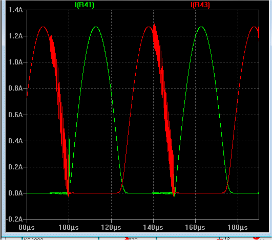

No problem , Bob. If I was in the "warm water", I would not respond... either 😀 .
I simulated the triple with a pair of 2Q CCS's and ksa992/sc1845's (lower Vceo - real low Cob). I would prefer a to-126 package to thermally couple to the MJE's (any suggestions ? ).
My circuit (below 1).
My first attempt (below 2) OOOps ! standard oscillator. 😱
With R48-49 stoppers on the drivers (below 3) , things started to come alive 🙂
With njw0281/0302's just about as economical as the MJE's ($2.30 vs 1.90) , I'll might use them as the drivers ! No problem driving those 4-8 pair of outputs then , unlike some on the forum who try that with just EF2's (droop) 🙁 .
OS

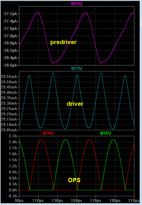

post1787.
the graphs have confused me.
I can't find R26 (pre-driver current varying from 27.2uA to 28.6uA i.e. +-0.7uA)
R35 does not measure Driver current. Ir35 shows up the variation in the bias voltage as the feedback tries to correct for the different drive requirements of the ClassAB output stage to maintain low distortion during the crossover.
You need to add in a dummy resistor on the Emitters of the drivers to read Driver current.
Why are the peak R35 currents varying alternately when the output is changing from +ve flow to -ve flow cf. from -ve flow to +ve flow?
Focus instead on the fact that the SUM of the currents in the plus and minus rails adds to a linear representation of the signal that will not create a lot of distortion if its magnetic field is induced into something nearby.
but this considers only the "FLOW" half of the "CIRCUIT".
The "RETURN" half is just as important. This is either the Power Ground current or the Speaker RETURN current.
To minimise the effects of radiated fields the flow and return pair must be of small radiating area. I refer to this as the twisted triplet, (+ve, -ve, return).
It's just the same at the receiving end.
The FLOW & RETURN of the signal pair must be of small receiving area.

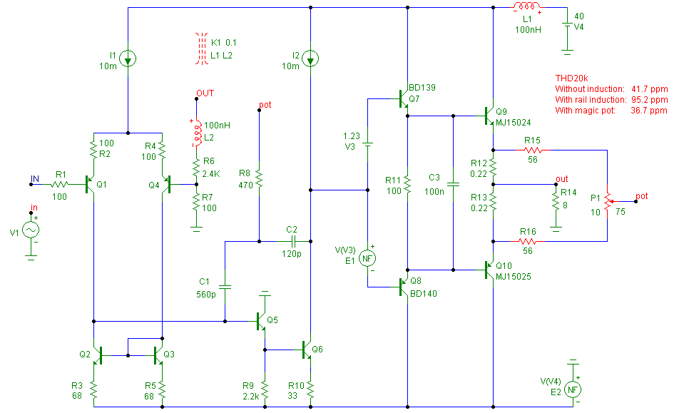

Hi Bob,
Not sure whether you are aware of a third method to reduce this insidious distortion: by means of my 'magic little pot'. So I mention it again (I hope not ad nauseum). See the pic below, red encircled stuff.
Without induction from the power rails this simple 'blameless' amp shows a THD20 of 41.7 ppm.
Next, I have simulated this insidious mechanism by inserting two inductors (100nH) into the pos. rail and the global FB path, which are loosely coupled (K=0.1). Now THD20 rises to 95.2 ppm.
And finally, I have added the magic pot (10 Ohms, wiper at 75%*), which brought back the THD level to its original value (and even slightly below): 36.7 ppm.
E.
* 75% is also optimal at 10kHz. So it is not frequency dependent.

Hi Bob,
E.
