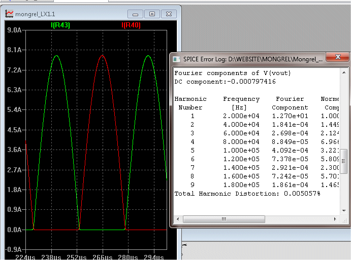

the graphs have confused me.
I can't find R26 (pre-driver current varying from 27.2uA to 28.6uA i.e. +-0.7uA)
R35 does not measure Driver current. Ir35 shows up the variation in the bias voltage as the feedback tries to correct for the different drive requirements of the ClassAB output stage to maintain low distortion during the crossover.
You need to add in a dummy resistor on the Emitters of the drivers to read Driver current.
Why are the peak R35 currents varying alternately when the output is changing from +ve flow to -ve flow cf. from -ve flow to +ve flow?
I built it ! Bob's "tip" about using low Vce/high beta devices led me to the sb1151/sd1691 pair (to-126).On my LT plots , R26 was just a arbitrary value (a "dummy Resistor") to plot the uA's. Using higher gain pre-drivers , this is most likely far lower.
. you are correct , R35 is just the steady bias of the drivers at rest (or at minimal load).Loaded with 1-2R , the actual driver current is in the 100's of mA. As far as driver "dummy resistors" , LT lets you probe the collectors directly to measure current. "Dummies" are only useful to plot total stage current or to add "errata" to a circuit , approximating real world performance.
Simulation is just a step in the process to "make it so" (capt. picard ). 😀
On the real thing , the 1151/1691 pair gave me awesome beta ! With the worse case OP beta (21193/4's) and a near short as a load , expect over one million current gain and the VAS load at under .1ma. The CCS's do most of the work leaving the pre-drivers to soar. Only 2.1V C-E !! Some will fuss about adding 6 more devices to the circuit , but I see it as a well spent $1.80. Awesome addition to any worthy voltage stage ... thanks, Bob.

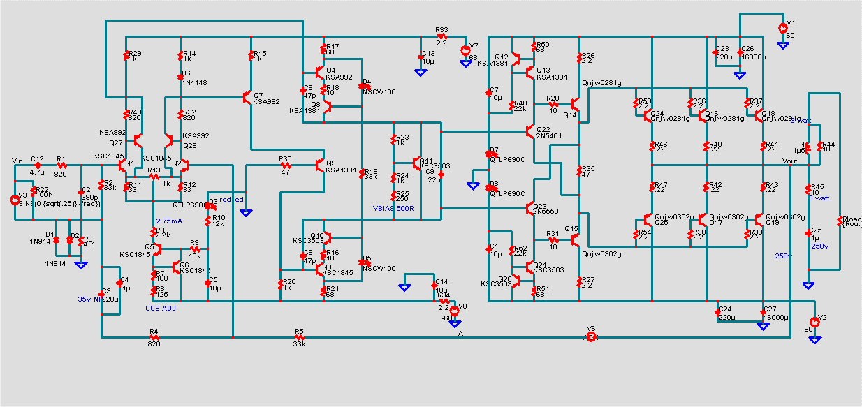

shot in the dark...

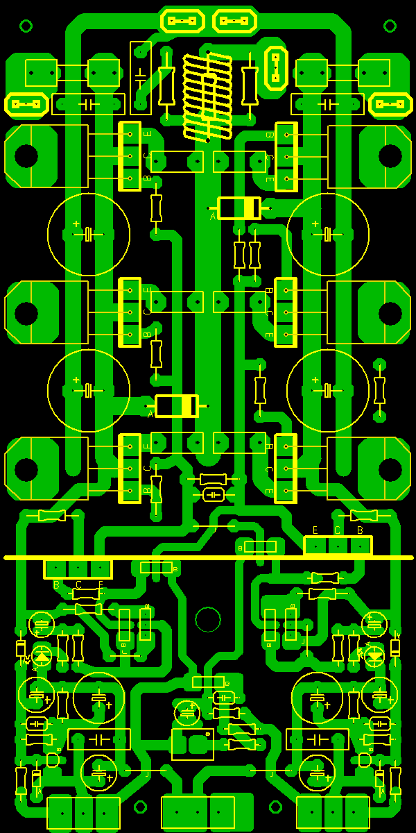

Just this one (below 1/2) , decided to give bob's triple a try ... glad I did. 🙂
Worked the first time. It was more involved to layout , but well worth it.

Well that is certainly an interesting topology, lots of transistors and boosted front end supply rails all adding to cost and complexity. This is probably a good time to ask the question, Bob, do you really think you (or some of the best trained listeners) could pick out one of these advanced topologies as compared to some of the better but much simpler ones in a blind A/B test?
As I've mentioned before, my brother and I were both highly interested in amplifier design decades ago and this is where we ended up. Sure it is challenging to design out as many non-linearities as possible but there are only so many hours in the day and one should ask is this the best use for our time - might our time be better spent designing better loudspeakers for example. It should reach a point where the question arises - where is the threshold of audibility?

By PB2 -Well that is certainly an interesting topology, lots of transistors and boosted front end supply rails all adding to cost and complexity. This is probably a good time to ask the question, Bob, do you really think you (or some of the best trained listeners) could pick out one of these advanced topologies as compared to some of the better but much simpler ones in a blind A/B test?
Being dirt poor , I also must weigh out the cost/complexity to final sound equation (very carefully). For the OP , the BJT "DBT" with 15 devices = a 8 device lateral setup. The DBT costs $20 for the silicon , 6 renesas laterals cost $24-30. Once the PCB is done, it might take another $1.80 and a few more minutes to stuff the board. At a larger scale (5-6 pair of outputs) the BJT's rule.
A 350W/ 6 pair BJT triple output stage can be made for under $40.
I have 2 pair of the original hitachi to-3 laterals to compare to. Very easy to do , 1 trimmer , 4 stoppers ... listen. 🙂 You don't need to be "a best trained listener" to hear the difference. Laterals beat your typical EF2 hands down. Not so with this DBT triple , early effect improvement plus no "suckout" cap makes the Xover smoother. The superior Vbe compensation is also far more attractive than your normal fare. NO load on your voltage stage lets you hear it unadulterated. I am a minimalist , but the positives far outweigh the negatives.
"Boosted front end" supplies will give the amp a noticable dual mono effect with a standard single OPS supply. (yes , you can hear this).

dbt= diamond buffer triple (page 192- figure 10.6). Below it is shown at 20khz driving a .5R load. Note the distortion level at a virtual short. Quite the little "arc welder". BUT , I suppose it does not matter since it will all sound the same 🙄 .
