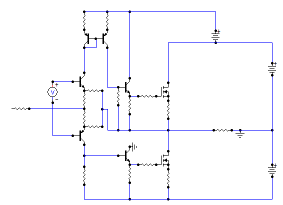

Hi Kanwar,
Thank you for your kind words and I am glad that you like the fact that it has a significant amount of MOSFET content.
By N-channel output stages I presume you mean all-N-channel output stages, those that typically are of the quasi-complementary architecture. Unfortunately, I do not include any material on quasi-complementary all-N-channel output stages.
While I respect the opinions of others, my own feeling is that they are not a good design approach. Price and availability of P-channel devices is not really a factor pushing one to quasi-complementary approaches (as it was in the early days of BJT output stages). The other argument I have heard in support of quasi-complementary all N-channel output stages is that they benefit from the fact that the transistors used in the top and bottom halves of the output stage are of the same type and have more nearly identical characteristics. Unfortunately, the very different way in which the devices are used in the top and bottom halves makes for very serious differences in the behavior of the top and bottom parts - far worse than the systematic differences one finds between N-channel devices and P-channel devices.
Bob
Surely you must be joking Mr Vermeulen.
Cgd is a real PITA. You can't compensate for it, as it is a moving target you always will miss.
I agree, Cgd can be a problem in several regards. It can climb to a very high value when the signal approaches the rails and significant current is being driven into the load, since it gets larger with smaller Vgd reverse bias. The forward gate bias required to source high current only makes things worse.
It can easily climb to 1000 pF for an IRFP240 under some conditions. It gets proportionately worse when multiple pairs of output devices are used. This is one reason that we cannot be complacent about the drivers for MOSFET outputs - they have to pull out charge, not unlike drivers for BJTs. However, for MOSFETs and sinewaves,the highest voltage slew rate typically occurs at an output voltage where Cgd is fairly small. However, a squarewave presents a much worse condition, and cross-conduction can occur when the MOSFET output is pulled away from the rail at a high rate of change.
There is also another problem: parasitic oscillations. We all know that MOSFETs are fast and are sometimes prone to local parasitic oscillations in the VHF band. Cgd often plays a role in the creation of the oscillator topology and resonance that is the root cause of the parasitic oscillation.
With Cgd moving around with signal, changing in value by an order of magnitude, many more signal-dependent opportunities for parasitic oscillation are presented.
Finally, do not overlook the fact that Ccb for BJT output transistors can also get pretty ugly.

Hi stinius,
These are very good questions.
I've done spot checks, but no plots, for both source resistors the same, and both source resistors at 0, all with each pair biased at 165 mA. But not plots.
The biggest reduction is in 2nd harmonic, while the reductions in other harmonics are modest. For example, at 20V peak into 8 ohms, around the intermediate power THD peak, 2nd went from 0.12% down to 0.021%, when 0.33/0.15 ohms was used instead of 0.22/0.22 ohms.
3rd went down from 0.026 to 0.024, while 5th went down from 0.0065 to 0.0041. 7th actually went up from 0.0001 to 0.00024, but these numbers are very low in the first place, and only represent a single power data point.
With respect to the distortion simulations, I did it with both no gate stopper and 47 ohm gate stopper and there was essentially no difference in distortion. In amps that I have built, I have done very little experimenting with different gate stoppers. I usually use 47 ohms and a gate Zobel network with vertical MOSFETs, much as I did 25 years ago when I did my MOSFET power amp with error correction.
Hope this answers your questions,
Bob

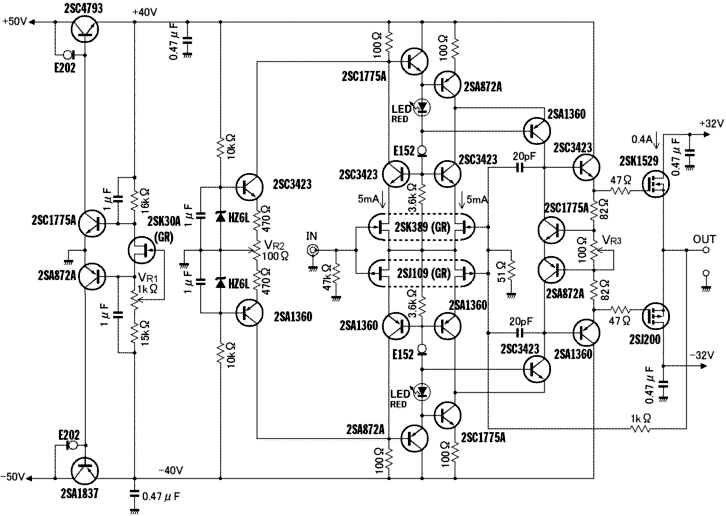

I duly agree Bob...!!!
I think Toshiba vertical complementary pairs are much better in performance and specs then IRF 240/9240 counterparts.
Goes for the baby Tosh too, and up to 50% cheaper per W power handling.
<10ppm (1W) and 50W continuous on a single output pair.
Elegant circuit, including the power supply/biasing!
This is a nice circuit. Folded cascode, Miller Input Compensation. Probably very good slew rate.
The smaller 2SK1529 and 2SJ200 are, price-wise, a fairer comparison to the IRFP240/9240, since both are in the smaller T0247 package. The nice big TO-264 package of the 2SK1530/2SJ201 probably accounts for the higher price.
I personally really like parts in the larger TO-264 package, not just for the often higher device rated power dissipation, but for the much higher metal header-to-heat-sink contact area, reducing the thermal resistance of the transistor insulator.
BTW, any further news on the so-called obsolescence of the 2SK1530? Digikey says so, but I have not seen other evidence of it. Also, Digikey does not say that about the 2SJ201.
Bob
