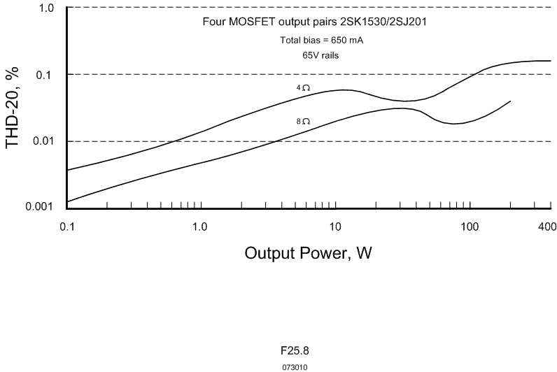

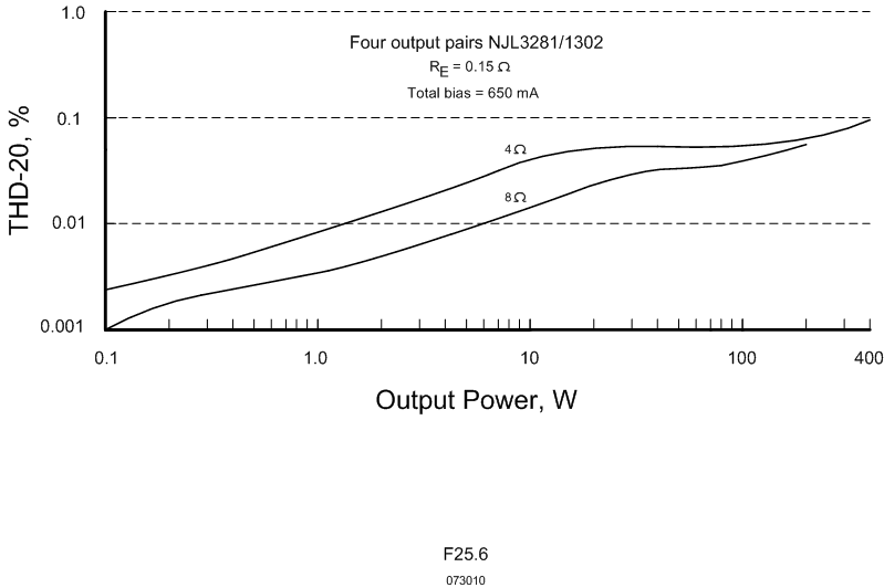

MOSFET asymmetrical source resistors
Here is some interesting data from the book regarding the THD performance achievable with class AB MOSFET output stages when asymmetrical source resistors are used to reduce relative transconductance droop and better match P-channel and N-channel transconductances. It is especially notable how the performance compares to an analogous BJT output stage with the same total bias current.
The output stage for which 20 kHz THD is shown below includes four pair of Toshiba 2SK1530/2SJ201 power MOSFETs. Each pair was biased at about 160 mA. The N-channel devices had 0.33-ohm source resistors while the P-channel devices had 0.15-ohm source resistors. The output stage was simulated using EKV models for the MOSFETs. The performance shown is the open-loop distortion of the output stage alone when driven with an ideal driver. The output stage is designed for 200 W at 8 ohms or 400 W at 4 ohms.
Bob
Hi Bob
First of all congratulations with your book, if it’s written in the same wise and technical way that your posts at this forum and your emails I’m sure it’s going to be a classical “must have” for everybody that is interested in the subject “Audio amplifier design”.
Questions:
1. Do you have a plot showing the THD on the MOSFET ops, when you’re using the same source R for the N and P devices? It would be nice to compare it with the plot with different source resistors.
2. When you are using different values on the source resistors, is the reduction in the THD mostly 2H, 3H or is the reduction evenly distributed.
3. Have you done experiments with different values on the gate stopper resistors on N and P devices?
Cheers
stinius

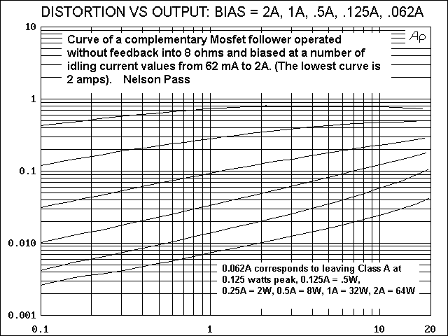

It would be even more interesting if you also tell us what kind of MOSFETs were tested. Any part numbers?
Hello
This graph come from passlabs.com in the PDF document: nelson pass-leaving_class_a
http://www.passlabs.com/pdfs/articles/leaving_class_a.pdf
A year ago I've copy text into the graph to made an image, so the image would self expain the fonction of the graph. But reading it again there is no mention of which mosfet he used.
Bye
Gaetan
That could be interpreted as cheating.
Advocating the use of Class A and vertical MOSFETs, backing it up with thd curves for different bias levels, without mentioning that the devices used are Lateral MOSFETs would imply a hoax at the least.
Credibility and scam artists do not mix.

Hi stinius,
These are very good questions.
I've done spot checks, but no plots, for both source resistors the same, and both source resistors at 0, all with each pair biased at 165 mA. But not plots.
The biggest reduction is in 2nd harmonic, while the reductions in other harmonics are modest. For example, at 20V peak into 8 ohms, around the intermediate power THD peak, 2nd went from 0.12% down to 0.021%, when 0.33/0.15 ohms was used instead of 0.22/0.22 ohms.
3rd went down from 0.026 to 0.024, while 5th went down from 0.0065 to 0.0041. 7th actually went up from 0.0001 to 0.00024, but these numbers are very low in the first place, and only represent a single power data point.
With respect to the distortion simulations, I did it with both no gate stopper and 47 ohm gate stopper and there was essentially no difference in distortion. In amps that I have built, I have done very little experimenting with different gate stoppers. I usually use 47 ohms and a gate Zobel network with vertical MOSFETs, much as I did 25 years ago when I did my MOSFET power amp with error correction.
Hope this answers your questions,
Bob
Hi Edmond,
Are you referring to my data or to the data from Nelson Pass?
Mine were the Toshiba 2SK1530/2SJ201 verticals.
Bob
Hi Bob,
I was referring to the data from Nelson Pass.
(I knew already that you are using 2SK1530/2SJ201 verticals 😉).
BTW, what are your favorite MOSFETs? Mine are the Toshibas, but I've also ordered a bunch of FQA12P20/FQA19N20* pairs, but not yet tested them.
E.
* Not the C version (FQA19N20C), which has a much higher Cgd.
PS: Thanks Gaetan.
