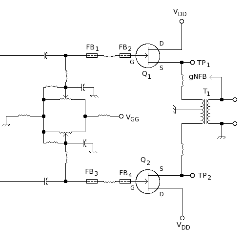

To the best of my knowledge, there is no P-type complement. For me, that is a show-stopper, but maybe not for others.
Not a show-stopper for me.
The SiC JFETs, like vacuum tubes, don't come in P-Channel form. I wouldn't operate these at less than 300Vdc (otherwise the internal capacitance goes vertical). I'd use a final similar to this one. Getting the voltage up and current down also avoids another problem with these: a substantial gate current that accompanies higher Vgs bias voltages, due to a parasitic diode that turns on and begins to pull current.
Getting the durn things: now that's a show-stopper.

Hi Miles,
I actually had not been thinking of their application with output transformers, but you make a good point. The main thing I was referring to was the need to operate them in a quasi-complementary output stage, which I don't like.
If one is willing to spring for an output transformer, these devices may be a good choice for getting a more tube-like sound without the fuss of tubes. Of course, one can do the same thing today with high-voltage vertical MOSFETs.
With a vertical MOSFET design feeding an output transformer, I think that one needs to be very mindful of the rather high peak voltages involved unless one uses an output transformer with a smaller primary impedance rating than is normally seen with vacuum tubes.

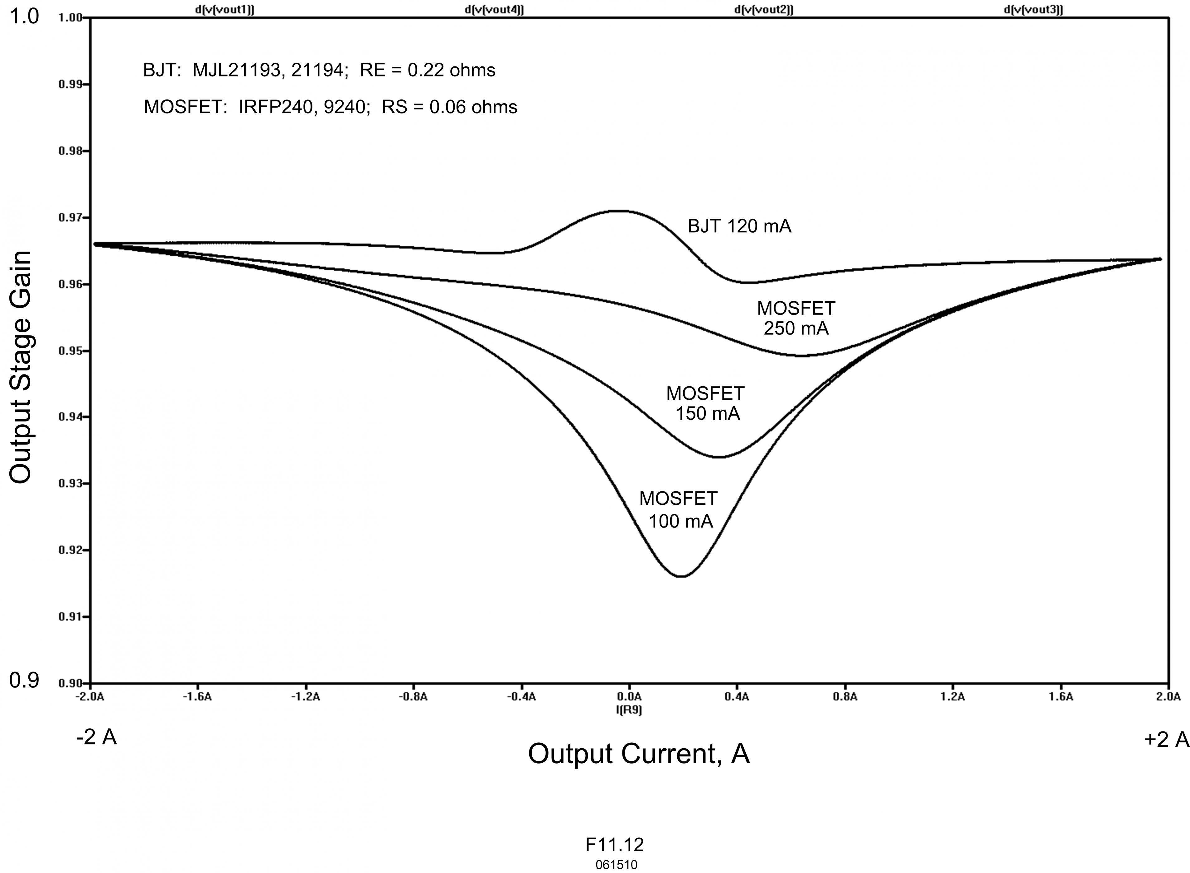

MOSFET vs BJT Wingspread
Attached is an interesting plot from my book that compares output stage wingspread simulations for a BJT output stage and a vertical MOSFET (IRFP240/9240) output stage, the latter biased at three different idle currents. Transconductance droop is evident in the MOSFET curves and BJT crossover wiggle is evident in the BJT curves.
MOSFET source resistors were added to equalize the output stage gain at high current for the two cases, but the MOSFET source resistor values were not adjusted in value or made asymmetrical to minimize crossover distortion.
It is interesting to note that the BJT crossover wiggle is somewhat more abrupt and occurring over a smaller range of output current, suggesting that the BJT may be more prone to create higher-order distortion products.
Obviously, MOSFETs like more bias current, and that is a price to be paid for good MOSFET output stage linearity. This will result in the amplifier running hotter in the idle state, but will have little influence on the maximum amplifier power dissipation that occurs in the neightborhood of 1/3 rated power.
Bob
