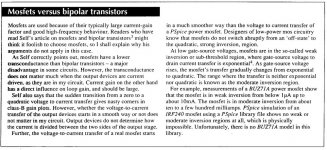

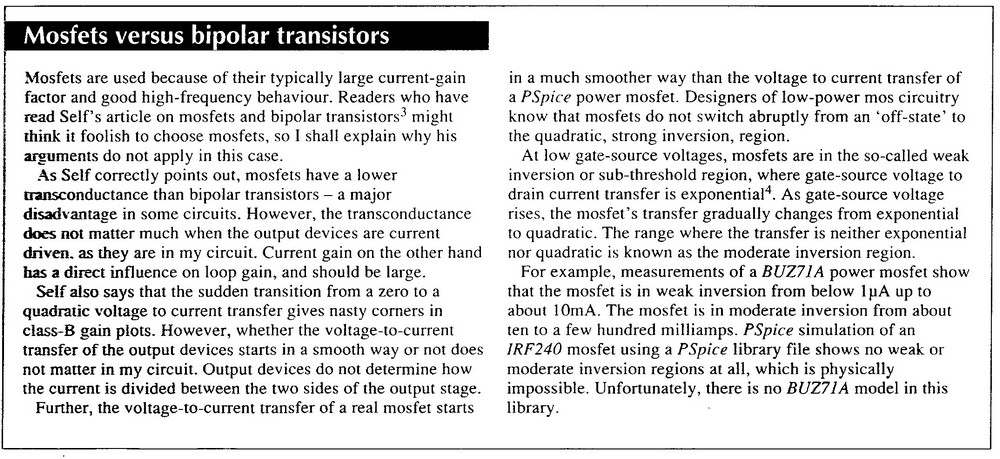

Why talk to him? Although wrong, he has written what he has written and that is crystal clear: "Figures 12 to 15 show spice gain plots, using 2SK135/2SJ50 devices".
Besides, I'm not the only one who disagrees with Self: See below, Marcel van de Gevel, EW, Feb. 1996, p.141
E.
