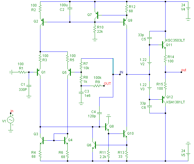

Nevertheless I must repeat my phrase: With LT-magic you can conjure anything out of your hat. You can put a gain probe anywhere, but that doesn't always mean the results make sense, let alone you can determine the order of the system in question based on those results.
Let's take for example a simple line-amp, comprising a LTP, an I-mirror and VAS, followed by a high speed output buffer. The Miller compensation includes the output. (yes it's rock stable: the phase margin of the local Miller loop is 85 degrees)
I hope that everyone will agree that, opposed to TPC, such an arrangement is basically first order system. Okay?

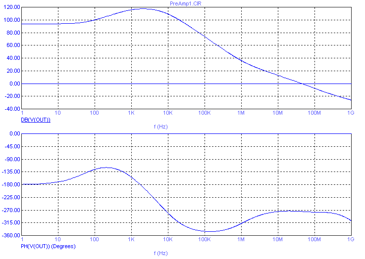

Now, let's look at the response of the so called 'minor loop including the OPS', by injecting the signal into the Miller cap (in order to include the OPS) as well into the NFB resistor (in order to comply with the weird definition of 'minor'). See fig. 1
Holy cow! WTF is this?
An enormous phase dip and a roll-off at 100kHz of ~40dB/decade (fig. 2). Well, I'm blowed! Surely, that must be a second order system.
Bottom line: one must be very careful where to put the gain probe and how to interpret the results. If done mindlessly, it easily leads to wrong conclusions.
E.
PS: Of course I could have used a more sophisticated Middlebrook or Tia gain probe, but I safely bet that you will get similar results.

The objective of both compensation techniques is to maintain the ideal closed loop transfer function with acceptable dynamic performance.
The minor loop technique is very versatile and powerfull to modify the dynamic of a feedback system. Miller, Nested Miller, two pole compensation, TMC are minor loop techniques.
JPV
JPV
Thanks Jean-Pierre,
Still, I'm a bit confused. Regarding a 'blameless amp' for example, is the Miller loop the so called 'minor loop' and the global negative feedback loop the 'major loop'?
E.
E.
Thanks Jean-Pierre,
E.
Yes exactly
JPV
Yes exactly
JPV
Thanks! Now, referring to post 1125, we can safely discard Mike's comments as 'utter nonsense' (his language, not mine).
E.
