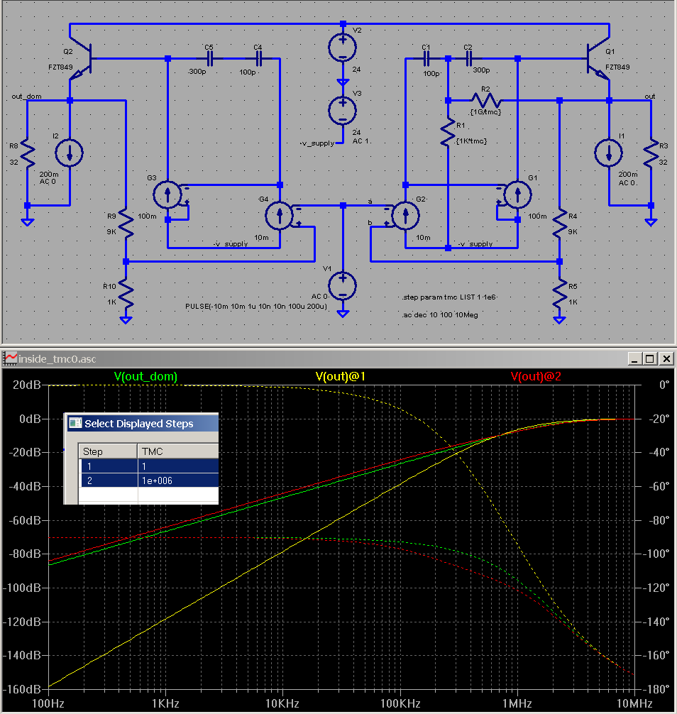

I modified my previous simplified compensation sim to explore PSRR
the g2,4 diff pair/mirror output and the g1,3 VAS spice models are referenced to the added -v_supply
to test PSRR the Vsource for the –v_supply has AC 1
as before the green trace is the “conventional Miller compensation” (left side “butterflied”/mirrored circuit with no compensation modifying resistors)
for the right side circuit when the variable "tmc" = 1 the compensation is actually "two-pole" with the resistor to the negative rail, clealy showing the superior negative PSRR in the yellow trace
red trace, V(out)@2 = TMC which as I stated based on the Sackinger paper's predictions is pretty much the same as "CMC"
positive supply rejection should be excellent for all of the sims - additional (mostly input) circuit detail would have to be added to capture CMRR properties
  • inside_tmc01.asc.txt

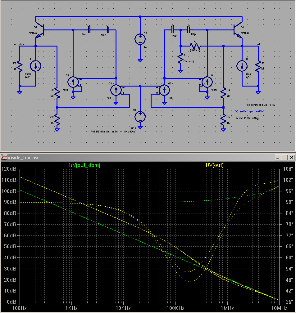

I had hoped that the Blackman inspired output conductance sim I showed earlier would be convincing that the greater feedback of TPC and TMC are externally observable by comparing both to the same amp with CMC
http://www.diyaudio.com/forums/soli...lls-power-amplifier-book-110.html#post2406839
after all we wouldn’t give TMC a 2nd look if it wasn’t reducing distortion and I think we agree that is because of “added feedback around the output stage”
The argument on principle is that added feedback (externally observable as output impedance reduction/conductance increase) has an unavoidable cost in stability and that TMC by using about the same added feedback as TPC gives similar stability
I believe the controversy is over interpretation of the TMC “1st order” outer feedback loop gain measurement which appears to show nearly unchanged phase margin from normal “CMC”
I think you do have to look at the inner loop in this instance for the full picture- what happened to change your earlier view?
...the global feedback gain crossover is only one parameter to keep an eye on. Those inner loops in any of the techniques can really get you, and must be watched closely...Bob
while my toy sim doesn’t have realistic enough output stage modeling – I believe your triple output should show added Cload destabilizing the TMC output much more than would be expected from the nominal 1st order appearance of the outer loop gain
and this is most easily viewed by looking at the gain "inside" the TMC resistor
the green trace is the output conductance of the “conventional Miller compensation” (left side “butterflied”/mirrored circuit with no compensation modifying resistors)
the two yellow are TPC,TMC output conductance

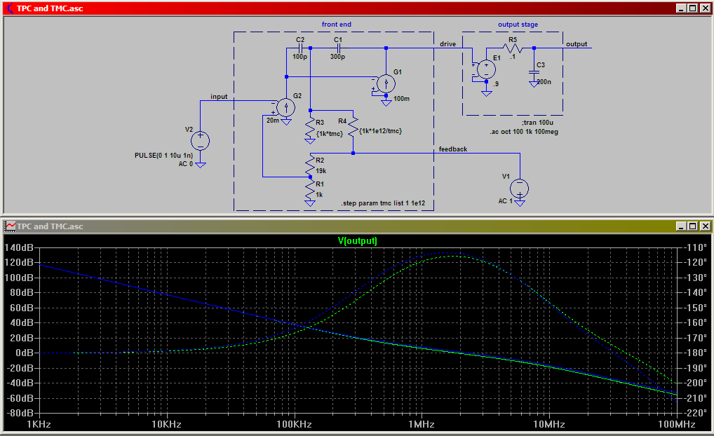

As the transfer function of the output stage and load, that is from VAS output voltage to final output voltage, is the biggest unknown in the loop what we should worry about as far as stability is concerned is the loop gain around the output stage. This is because its transfer function depends on large uncertainties like the relatively slow output transistors, significant parasitics, instantaneous output current, load impedance and so on. This loop gain is also what determines the amount of reduction of output stage distortion.
Whether the resistor in the compensation network goes to ground (TPC) or to the feedback node (TMC) is only of internal concern to the front end "black box" which has two inputs and one output. And this gain is, just as jcx and michaelkiwanuka point out, almost exactly the same for both cases. See attached figure. The plot shows loop gain for both the TPC (green) and TMC (blue) cases.

Once again, if you are claiming equality of loop gain around the output stage if identical components are used for TPC and TMC, then I assert that that is not convincing because you are applying an unreasonable constraint on the TPC and TMC approaches.
Identical component values is a perfectly reasonable constraint as it ensures equality of unity gain frequency between the two arrangements; precisely what is required for an apples and apples comparison.
