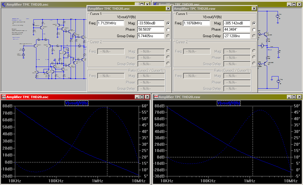

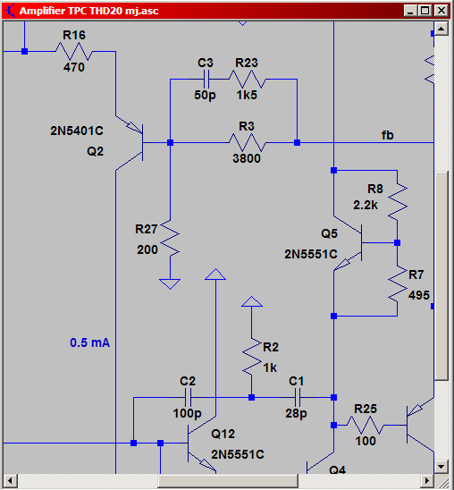

Notably, the TPC amplifier with equally low distortion as the TMC amplifier exhibits 67% small-signal squarewave overshoot and +3dB closed loop gain peaking. Large signal squarewave response exhibits ringing.
67% small-signal squarewave overshoot & ringing suggests your amp. is borderline stable. This implies component values for degeneration & compensation may well be incorrect. Check your loop gain. Also use phase lead comp.
It looks like the phase margin for the TPC version is a bit low in the loop around the output stage. It also has a lower crossover frequency at 1.2 MHz compared to 1.7 MHz for the TMC version.
The gain in the loop is the same at 60 kHz though at about 46 dB.
Hi Mike,
This is just what it takes to obtain TPC performance equal to TMC performance - you know as well as anybody that TPC inevitably results in overshoot and frequency response peaking (assuming no phase lead crutch is used in the feedback path). The more agressive you make TPC to get lower distortion, the higher price you pay in transient behavior and stability. The large-signal ringing, though small, results from the fact that margins do decrease in the real world due to signal swing, especially when driving a 4 ohm load.
Mind you, this amplifier with TPC is not anything I would build or recommend; it is merely for comparison to show what you get when you try to get distortion performance from TPC that is as good as that easily obtainable from TMC.
The TMC version is rock stable, with no overshoot, no frequency response peak, and good phase and gain margins.
I urge you to choose different compensation values for this amplifier and simulate it to see if you can do better.
I also will be happy to see what you can do with this if you put in some lead compensation. Once again, however, I remind you that the TMC amplifier needs no lead compensation to perform really well.
Bob

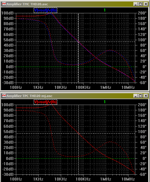

Here's something that gives similar loop gain for both TPC and TMC.
The input current to the VAS has already reached 10 degrees of lag coming from the input stage compared to the output so something is needed to make up for this. There is also a difference in that the TMC network gives built-in phase lead directly to the VAS which then needs to be added externally for the same loop gain shape.
While the TMC version may load the VAS less the TPC version draws less current from the input stage.

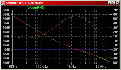

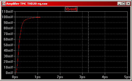

jcx,
I just tried your change of values and it pushed up the gain crossover frequency to 7 MHz. The inductances in the output stage start getting significant up there and they are not modeled. I haven't tried but I suspect going for such a high crossover frequency in reality is a bit more troublesome than in the simulator... 😉
Bob,
I played a bit with the TMC network and came to the same conclusion as syn08 did earlier but by a different method: the TMC network can, as far as the forward gain and feedback gain of the frontend is concerned, be replaced with a TPC network with the same component values plus an RC-network from the output of the amplifier to the base of the VAS. The capacitor value is the same as the TMC capacitor on the input side of the VAS (17 pF) and the resistor value is R * (1+Cout/Cin) (2.2 kohm * 6 = 13.2 kohm).
The loading on the VAS by the "equivalent" is different though, but can be lowered by changing the capacitors and resistor in the new TPC network to another combination which gives the same frequency of the high-frequency pole and HF asymptote but different impedance as seen from the VAS output.
I then took the current from the lead network into the virtual-ground VAS base and merged it with the current coming from the LTP into the wanted transfer function from the output voltage of the amplifier to the input current of the VAS. I then implemented it as a lead network across the feedback resistor instead, removing the RC network from the amplifier output to VAS base.
So in the end I ended up with 4879 ohms in series with 44 pF as a lead network which then goes across the 3800 ohm feedback resistor. In the TPC network I used 28 pF for both capacitors and 4 kohms for the resistor just like in your original TPC simulation. The simulation shows no overshoot for a 5 mV 100 ns risetime input step and the loop gain curve looks very much alike your original TMC implementation. The simulated distortion is 0.001723%.
The attached curves show loop gain for TPC + lead is in green and TMC is in red. The step response is for the TPC + lead version. The TPC version shows a little more phase lag which comes from the input stage.
