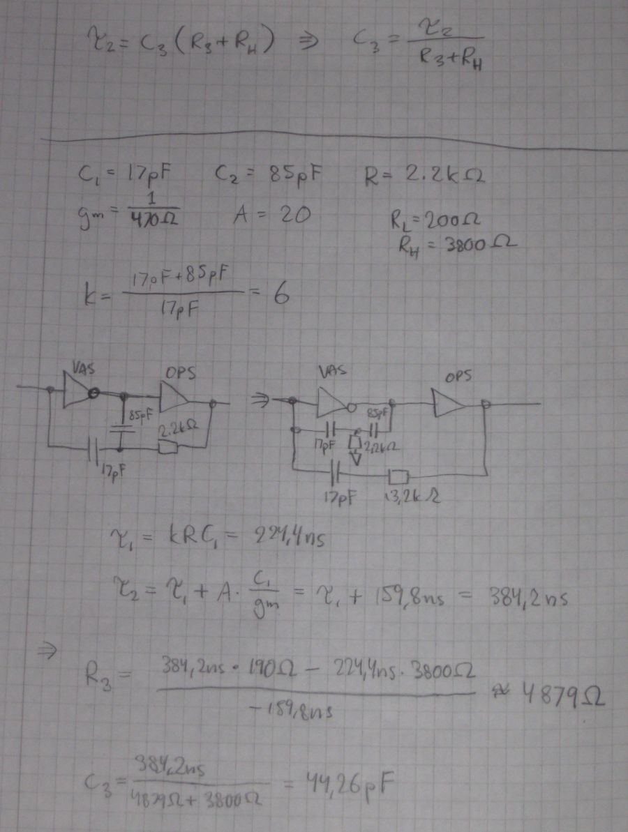

Hi Bob and Edmond,
A series combination of 4879 ohms and 44 pF across the 3800 ohm feedback resistor in the TPC simulation Bob posted will give the same phase lead that the TMC network itself is providing from the output directly to the VAS in the TMC version.
The loop gain around the output stage then becomes about the same for both the TPC and TMC versions with a gain crossover frequency of about 1.7 MHz. With this lead compensation network the TPC version neither has overshoot nor closed-loop frequency response peaking, just like the TMC version. See post 1200 for more details. I can post my derivation of these values if you are interested.

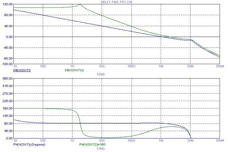

I played a bit with the TMC network and came to the same conclusion as syn08 did earlier but by a different method: the TMC network can, as far as the forward gain and feedback gain of the frontend is concerned, be replaced with a TPC network with the same component values plus an RC-network from the output of the amplifier to the base of the VAS. The capacitor value is the same as the TMC capacitor on the input side of the VAS (17 pF) and the resistor value is R * (1+Cout/Cin) (2.2 kohm * 6 = 13.2 kohm).
[snip]
The attached curves show loop gain for TPC + lead is in green and TMC is in red. The step response is for the TPC + lead version. The TPC version shows a little more phase lag which comes from the input stage.
Hi Megajocke,
These are interesting results, which are certainly worth to have a closer look at. So, would you be so kind to give us the exact schematics on which your graphs are based, as a verbal description alone might easily lead to errors and misinterpretation.
Thanks in advance.

Hi Bob and Edmond,
Joakim
Hi Joakim,
I tried just that and indeed the overshoot has gone. That's nice! But looking at the gain and phase response of the global NFB loop, we still see that ugly phase dip around ~20kHz. Moreover, compared to TMC, the unity loop gain frequency is two times higher: 2MHz vs 1MHz for TMC, and the phase margin lower: 69 vs 91 degrees. If we adjust the TPC caps for an equal ULGF (apples to apples, you know), then the distortion of TPC is 10dB higher :sad: though the PM has become slightly better: 74 degrees.
E.
PS: >I can post my derivation of these values if you are interested.
Yes, please (and the schematics).
Right. That's true for the feedback loop going through the LTP but the TMC version also has the feedback coming directly from the output into the VAS. If you instead look at the loop gain around the output stage they both have a crossover frequency of about 1.7 MHz and a phase margin of about 60 degrees. The TPC version has a little less phase margin because the LTP has some phase lag which I did not account for.
My thinking is that, since it's the output stage with its load that is the slow one and has the least well-controlled transfer function, this is where concern for crossover frequency and phase margin is needed most. Bringing the phase lead directly to the VAS through the TMC network or letting it pass through the LTP first shouldn't make that much of a difference as far as stability is concerned considering how well-behaved the LTP is at 2 MHz, let alone at 20 kHz where the phase dip is. If the input stage is driven into nonlinearity there will be differences of course. Is that where the worry lies?
Still there are differences in how the stages are loaded. The TPC version loads the VAS more, at least with these values in the TPC network, while the TMC version on the other hand loads the LTP more. I'll post my derivation of the component values later.
Joakim
Hi Joakim,
So it's matter where you put the gain probe. If you do it your way, then I agree with your remarks.

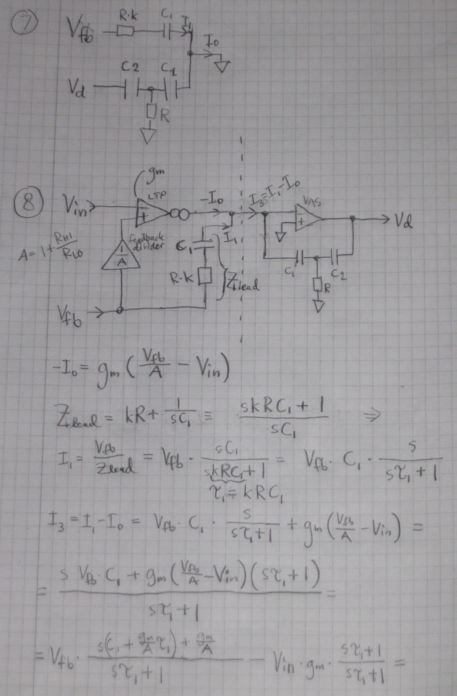

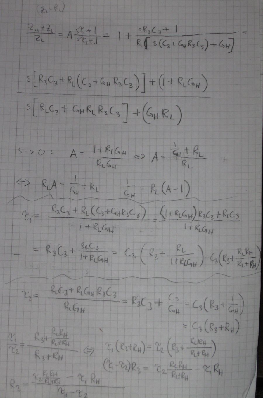

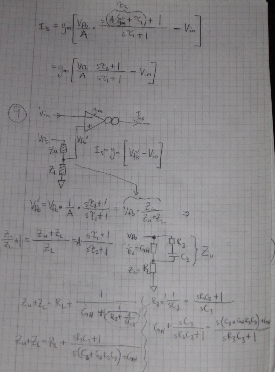

Here's what I did:
Step 1: This is the whole amplifier.
Step 2: The LTP is modeled as a transconductance amplifier with infinite bandwith while the VAS is modeled with lots of (infinite) gain and no input current.
Step 3: C1 feeds the current I0 into the virtual ground summing node at the input of the VAS and this network is used to calculate this current.
Step 4: The network in step 4 gives the same I0 if its input signals, the voltages Vfb and Vd, are the same (superposition). The loading of the output stage and the VAS is not the same as before however.
Step 5: Network used to calculate I2 in the upper branch of (4). I1 is calculated as current division between the capacitors.
Step 6: The impedances from (5) is scaled to give a network that outputs I1 instead of I2.
Step 7: The upper branch from (4) is replaced by (6) giving (7) which still gives the same I0 for the same input voltage signals as the original TMC network.
Step 8: The TMC network is replaced by the calculated TPC network and the lead link to the VAS summing node. The current I3 driving the TPC compensated VAS is then calculated.
The current I3 has two components. One is -Vin*gm for the forward path and the other one is gm * Vfb/A * (s*tau2+1)/(s*tau1+1) for the feedback path which is a lead type transfer function as tau2 > tau1.
Step 9: The lead type transfer function is implemented on the input side of the LTP instead. The circuitry to the left of the dashed line in (8) is replaced with this new network that will give the same I3 as the left part of (8) did.
The previously calculated transfer function from Vfb to I3 is identified with the one of the lead network which finally makes it possible to calculate the values of R3 and C3 that will make I3 the same as before, but now implemented with lead compensation before the input of the LTP instead of bypassing this lead feedback directly to the VAS summing node.
Finally the component values from Bob's TMC simulation are used to calculate the equivalent lead network which makes the TPC + lead version have the same feedback and forward gain for the front end as the TMC version. Thus, the closed loop gain will be the same for both.
