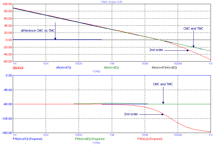

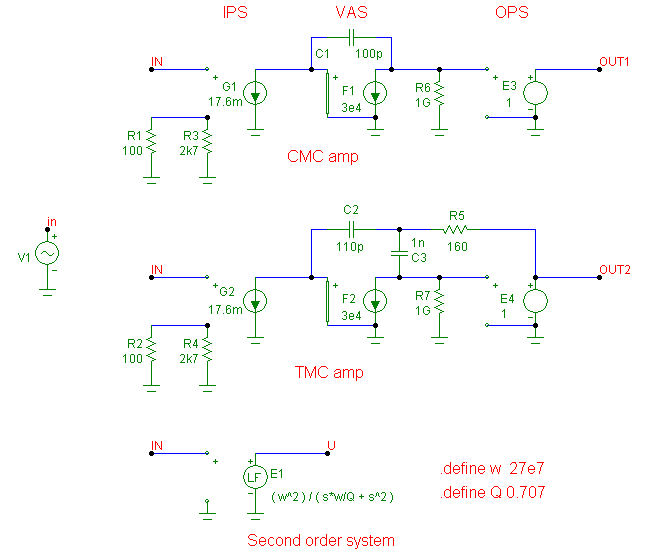

Nice try, jcx.
With LT-magic you can conjure anything out of your hat. Maybe you like to fool yourself with this kind of magic, but you can't fool me.
Anyhow, the question was whether The 2nd order terms of TMC are so small that we safely can ignore them and, consequently, we may consider TMC a 1st order system.
To get an answer, I've simmed two fairly standard amps with a conventional Miller compensation (CMC) and TMC. For comparison I have also simmed a 2nd order Laplace function.
To exclude minor side effects from real components, I've used synthetic ones instead: a VCCS (for the IPS), a CCCS (for the VAS) and a VCVS (for the OPS). See 1st pic. The ULGF and transition frequency are both 1MHz and the closed loop gain is 28x, though the global NFB has been disabled (by connecting R3 and R4 to ground) in order to investigate the open loop responses, See 2nd pic.
As expected, the Bode plot of the CMC amp rolls off steadily with 20dB/decade and the phase is a constant -90 degrees. See the blue curves (as far as visible).
Now, let's look at the Bode plot of the TMC amp, the green curves. These curves coincidence with the CMC curves. For the unbelievers I've also plot the difference of them, see the black curve (0dB).
Finally, have a look at the response of a critically damped 2nd order thingy (red curves). Clearly they are totally different. Beyond Wo: 40dB/decade roll-off and a phase shift up to -180 degrees.
Bottom line: TMC is essentially a first order system.

The CMC should have (with the values you are giving) a GBW ( or ULG or frequency where the loop gain is one) of gm1/2piC = 28 Mhz providing the other poles are at higher frequency ( what you assumed).
If we look at the TMC minor loop, its closed loop gain is 1/YR1 where Y is the admittance of the TMC feedback network and R1 is the input resistance of the VAS// with the output resistance of the first stage. This is for frequencies where the TMC loop gain is high >>1.
With the values given ( C2>>C1) Y~=sC1 and the TMC stage is an integrator down to the point where the TMC loop gain is <<1. There the TMC stage gain becomes constant ( = DC gain of the VAS).
So TMC and CMC behave as integrator down to low frequencies where they should have both the DC gain ( this I do not see in you simulation).
Except these two questions ( GBW of CMC and DC gain of TMC) it is obvious that TMC or CMC compensated two stage amplifier behaves like a first order system for the frequencies of interest.
Do you agree Edmond
JPV

Nice work, Edmond. I agree with what you have done and concluded here, with an ever-so-slight caveat. As I had mentioned in an earlier post, when an output stage has gain less than unity, the TMC may take on some very minor attributes of a second-order system. You might try your idealized TMC simulation with an output stage gain of 0.9 and see what you get. Nevertheless, you have properly qualified your assertion by saying that the departures of TMC from a true first order system in practice in a reasonable application are negligible.
For all practical purposes, TMC acts as a first order system and to quibble about very fine distinctions in semantics is unnecessary and detracts from understanding of the differences between TPC and TMC.
The similarity of appearance of the TPC and TMC schematics has enticed some into thinking that TPC and TMC are largely the same, and this is simply not the case. Moreover, I think that some here, having been so enticed, have used the same values for the C's and R for both TPC and TMC. This gives misleading results. If one uses the same R for TMC as for TPC (capacitors being the same), one gets extremely sub-optimal TMC in my opinion. In general, the R in TMC wants to be substantially lower than the R in TPC. This is the way I did it in the simulation example above where I showed that in a simulated real amplifier TMC was superior.
As discussed earlier, I do agree that the agressiveness of TPC used is a matter of choice, and TPC can be made to perform with larger distortion reduction than I showed if it is made more agressive, but in my opinion that involves added risk.
It is also true that TMC does nothing for improving the life of the input stage compared to conventional Miller compensation, while TPC does act to reduce distortion introduced by the input stage. Yes, it is certainly true that the increased global feedback afforded by TPC helps all parts of the amplifier. But TMC specifically and effectively attacts the most insidiuos contributor to distortion, namely the output stage.
Bob
Hi Jean-Pierre,
That's right, ~28MHz for CMC as well for TMC.
So TMC and CMC behave as integrator down to low frequencies where they should have both the DC gain (this I do not see in you simulation).
Due to the use of idealized components, the frequency where the gain flattens and becomes equal to the DC gain, is extreme and unrealistic low: about 1 micro Hz (far beyond the used scale). That's why you can't see it in the plots.
Do you agree Edmond
JPV
I fully agree with that.
E.
Edmond,
I must have misread your graph.
To me TMC and CMC loop must have the same DC loop gain, therefore my question because you are showing TMC vs CMC as different at low frequencies.
JPV
JPV

Hi Jean-Pierre,
Of course the DC gain of the TMC vs the CMC version is the same.
Perhaps the term 'difference' was a bit misleading. My apologies.
I meant the difference in gain in terms of decibels.
The black curve represents: dB(v(out1)/v(out2)) = dB(v(out1) - dB(v(out2)) = 0
E.

The order of TMC
Hi Bob,
I did just that. Even to my own surprise, it appears that the magnitude, respectively phase curves still coincidence very closely. IOW, also with a OPS gain of 0.9, TMC is hardly to distinguish from a first order system. The max. magnitude deviation (peak to peak and in given frequency range) is 0.0087dB and the max. phase deviation is 0.029 degrees.
No one would call this a second order system (except syn09, of course).
E.
Bob
Hi Bob,
E.
