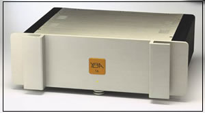

(for those interested : the 2nd page of the Hi-Fi N&R article i linked to describes the Yves Bernard André YBA1 model, first power amp i've seen in the late 80s that employs a BJT output stage without emitter resistors. Current YBA models do, btw)
