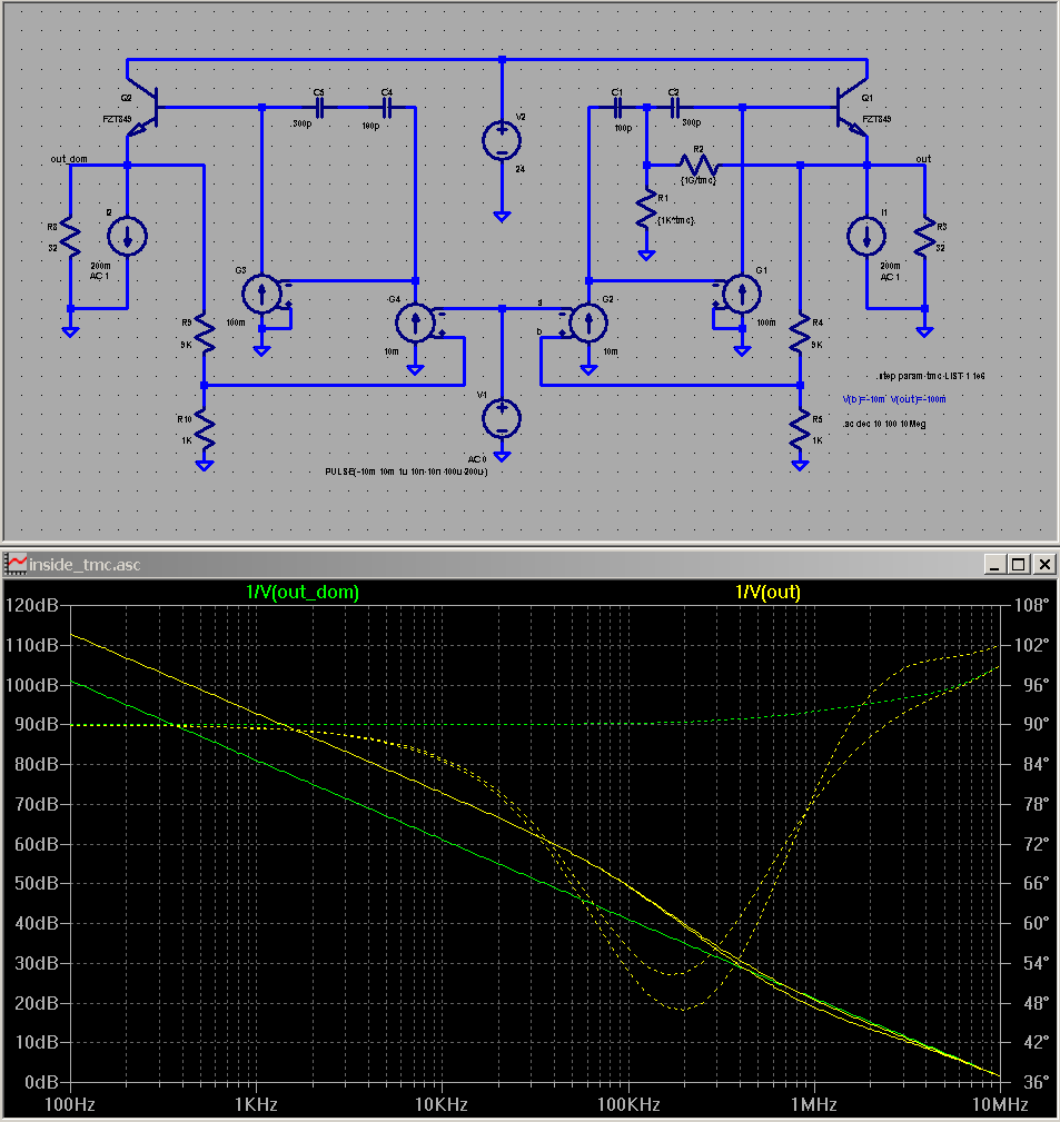

care to choose which of the Yellow traces show a "1st order" loop gain system?
the Vout is ~= output Z due to the AC 1 added to each output Q bias CCS
plotting 1/Vout gives the more familiar looking ~=gain curve presentation of output conductance
(I chose this "odd" approach to ward off arguments over where you should place a simple Middlebrook V test source to properly measure the loop gain - clearly this is a measurement of an external amplifier property and not subject to choice/debate)
the .step statement switches between TPC and TMC and both steps are plotted in yellow
green is the Cdom only output 1/Z
if you want to play you can plot each "step" with V(out)@1, V(out)@2 syntax
its really hard to see why anyone would want to get hung up on the semantics - if you want to call the TMC output step response "almost 1st order" I suppose you could - but I can tell the difference by eyeball in this sim and no ther aspect of TMC can be profitably talked about as a "1st order" system
