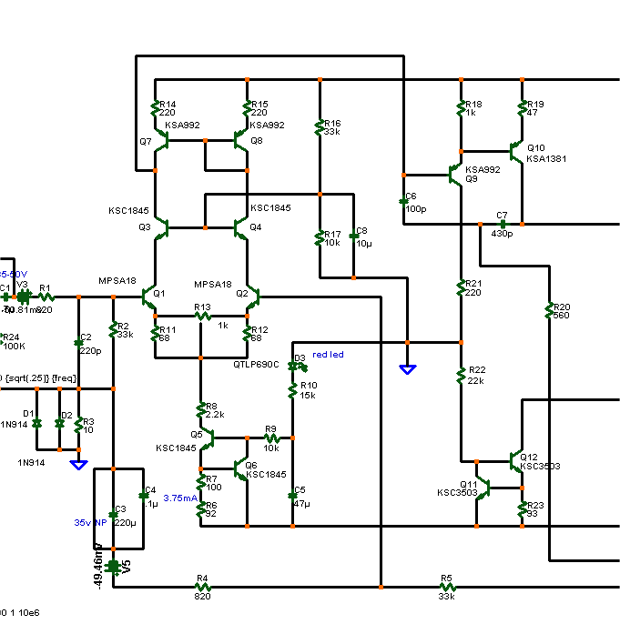

The simulator "lies" - occasionally..

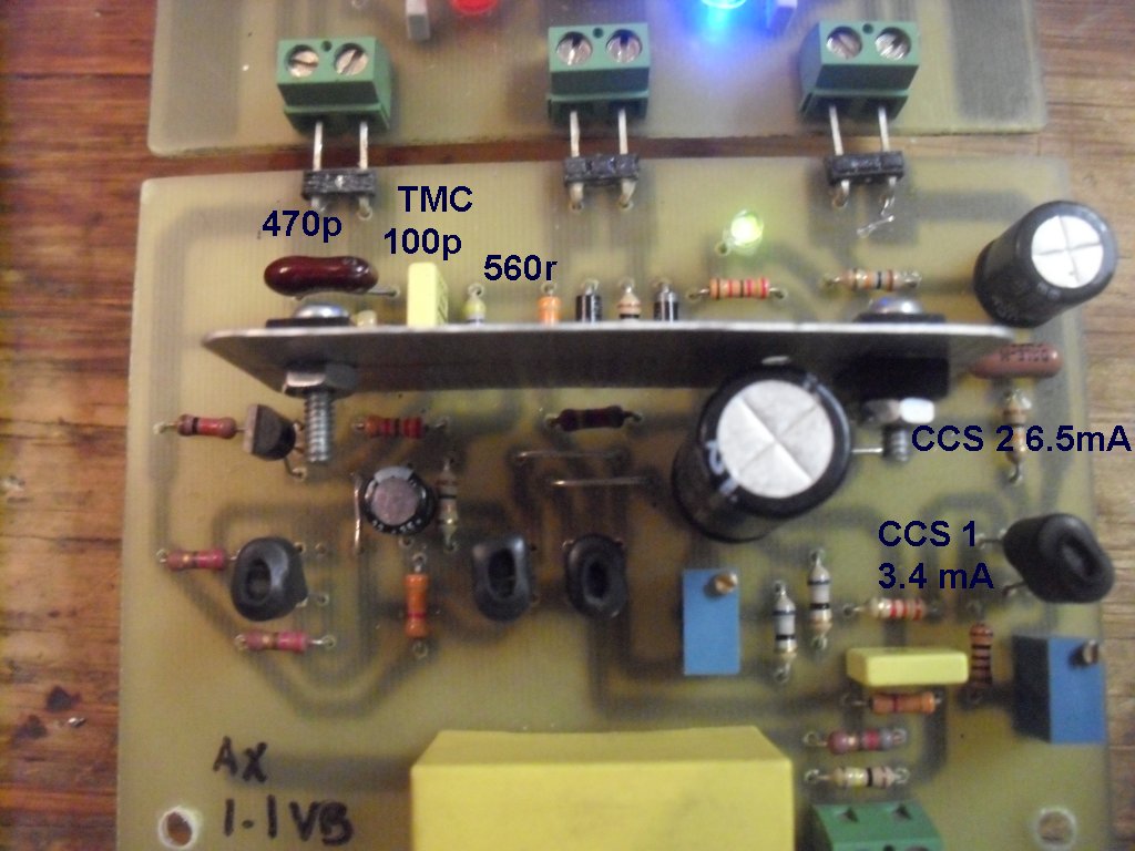

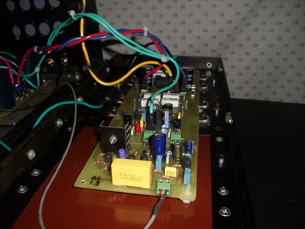

Thanks for the wonderful in - depth discussion on TPC/TMC. I have been in the "trenches" , actually building/ testing/abusing different topologies w/TMC on my "testbed" (pix1).
Similar to my main (and best attempt - AX - pix 2). 35db at 20K (simulated) , 875k GCF ,and "the bump" 😀 just above UG ? I got that with 470R or lower Rtmc (simulated). I ran the real amp with 560R (like E. stuarts example). I also ran a 10k SW into it with a resistive load ... perfect , no overshoot .. textbook.
I then listened to it , sounded wonderful at moderate volumes and outright glorious at major levels (150w w/ 400w transients). I put a switch on Rtmc and was able to A/B instantly (almost - shut down , "switch" - power up).
TMC's effect was both noticable and beneficial , not even on a subjective level (quite easy to notice). Best amp I have ever heard - really. (simple , too)
Tried it on a very similar topology with a bootstrapped current source. This attempt gave me an oscillator. 🙁 I increased my TMC ratio 6:1 -100p/560p- upped Rtmc to 1K , all was well)Even then , TMC did not have as a pronounced effect with the bootstrapped current source. The feedback of the bootstrap interfered with TMC .. the simulator did not predict this errata , but showed this topology as the clear "winner".
The winner (audibly) was the "blameless" /w TMC (AX-pix 3) , I compared it to 2 other popular amps (original symasym and a luxman clone) and the margin was noticeable. These real world tests were done on a standard EF2 - mje15034/35 / njw0281/0302 OPS. TMC is nice , but should be applied "carefully" , not all amps/topologies will benefit from it. 🙂

Hi ostripper,
As I have mentioned, I have been trying TMC on the BAKSA (with bootstrapped VAS) so I am curious how to look out for oscillations. I haven't heard any degradation in sound quality and I have been monitoring the temperature of all transistors and all seem to be normal temperature (about 10 degrees above ambient).
I suppose I need to get my signal generator and CRO out.
I should mention, as I have an off board output inductor I have been connecting TMC before the zobel or inductor.
86pF/330pF/470R
EDIT: I just realised I should have posted in your thread rather than here, sorry.

Either thread , it's not OT 🙂 I learn here , apply over "there" .
Sig. gen. +CRO = absolutely essential to find the truth.
"look for oscillations" ...maybe a smokin' zoble resistor (sniff, sniff)... 😀

Am sorry wahab, but without schematics and some details on the analysis methodology I myself cannot really follow your results and comments.
I must be dense, but in all truth, "Unity gain is at 30mhz,(not loop gain) , and that also common for any non compensated amp. Once the amp is compensated, unity gain decrease largely" doesn't make any sense to me.
