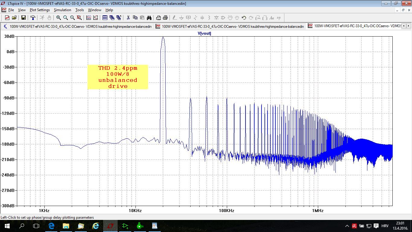

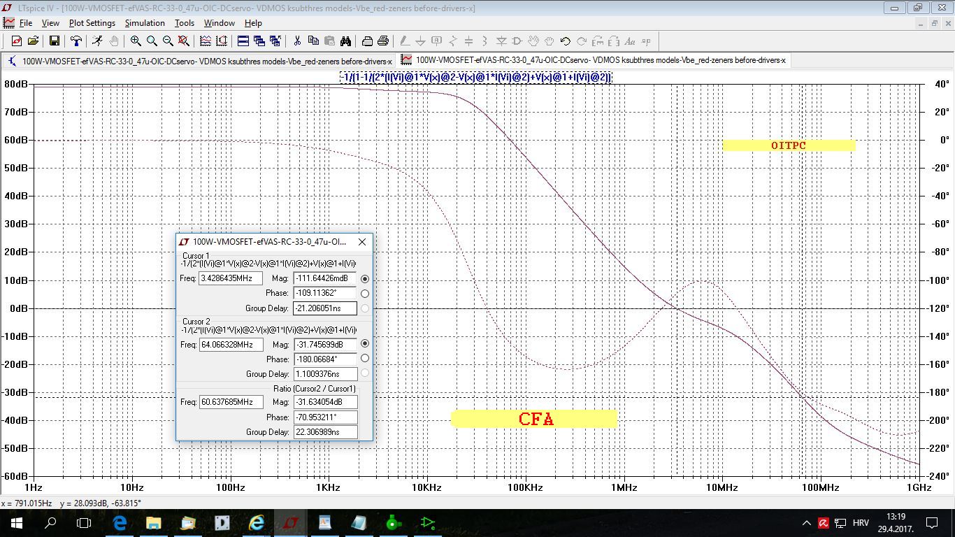

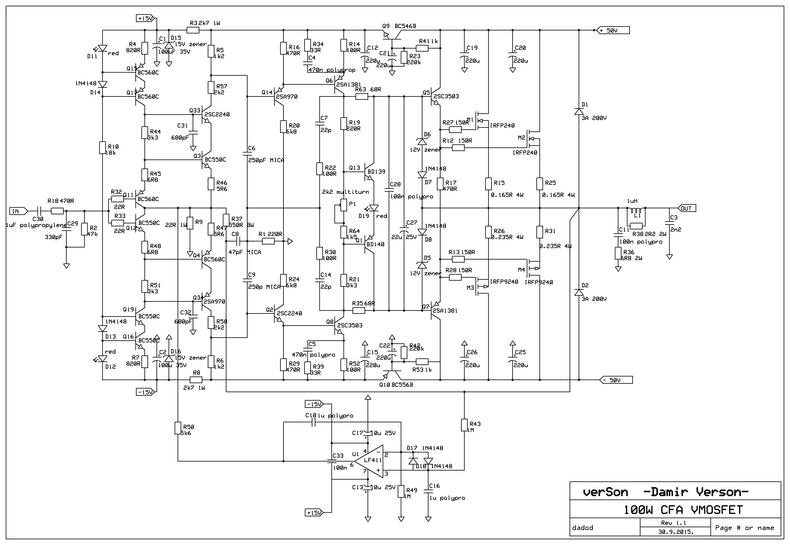

Why do you need triple with mosfet OPS or EC to get very low THD?😉
My CFA with IRFP240/9240 has less then 3ppm at 20kHz and full output power with simple OPS and two pole compensation, OITPC.
By the way, I changed output mosfet protection that one was not good enough, moved zeners after mosfets gate resistors.
