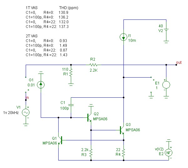

See picture for the 2T VAS.

See picture below.
Current sense resistor, which together with Q1 protect the VAS against excessive currents.What is the purpose of degeneration the vas.
Cheers, E.
I see. It's not optimal.
You may try to use a current source to load the collector of the Q2.
The current source should be set at above the current of Q2.
I did this in my project. Thus you do not need R4.

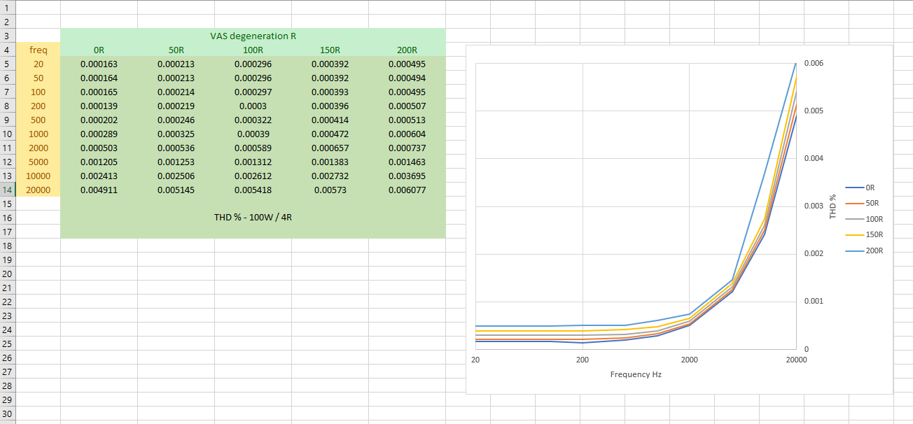

I've spent hundreds of hours building and measuring power op-amps for instrumentation. Maximizing Miller-feedback loop-gain has always been consistently instrumental to keeping the overall distortion of an amplifier below my measurement limit for as long as possible as frequency rises.
This means, amongst other things, using as little VAS emitter degeneration as possible. Sometimes a little degeneration is helpful to the goal of frequency compensating the Miller-feedback loop itself (whether it encloses more than just the VAS transistors or not), but as insofar as distortion goes, in most cases, less is ultimately better.

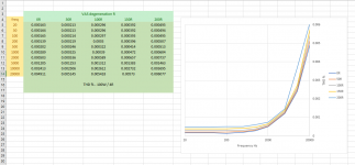

Just for the sake of it, attached is a quick sim of a typical 100W / 4 ohm "Blameless" amplifier with a global ULGF of ~830 kHz. The VAS emitter degeneration was stepped from 0 to 200 R in 50 R increments. For each value of degeneration the THD was taken at 1/2/5 frequency intervals from 20Hz to 20kHz.
The ratio of highest to lowest distortion (over the range of degeneration) is greatest at the lowest audio octaves, which is exactly as one should expect. This is because the most important parameter of the VAS, as far as its ability to drive the non-linear load of the power output stage is concerned, is its ability to keep its output impedance low. At low frequencies feedback via the Miller-feedback compensation capacitor is minimal and you're now relying on on the VAS transconductance being as high as it can be to keep the Miller-feedback loop gain up.

Another thing that might be worth mentioning is that degenerating the VAS in not at all analogous to degenerating the input stage as far as the transconductance/linearity trade off is concerned. Unlike when degenerating the VAS, there is no such tradeoff at all when degenerating the input stage (IPS).
To a first order analysis the amplifiers ULGF is determined by three variables - the IPS transconductance, the value of the Miller-feedback compensation capacitor and the the value of closed loop gain.
With the closed loop gain and the value of the Miller compensation capacitor set, in order to set your desired ULGF, you've got a specific value of IPS transconductance to design for.
You can either run the IPS un-degenerated and simply program the target transconductance with the tail current, or you can set the tail current much higher (say x10) than required to achieve the required transconductance in the un-degenerated case, but then degenerate back down to the required value.
Both methods end up with the same result as far as transconductance goes, buy the latter method results in an IPS with much better linearity. The take away here is that you've dramatically improved the linearity of the IPS, but in doing so you have not in any way thrown away a big chunk of beneficial loop gain.
In comparison to the IPS, the VAS with, say, a typical Iq of 10mA or so, is already running "hot" and there really isn't any practical/worthwhile scope for making up for the transconductance lost to degeneration by running it any hotter.

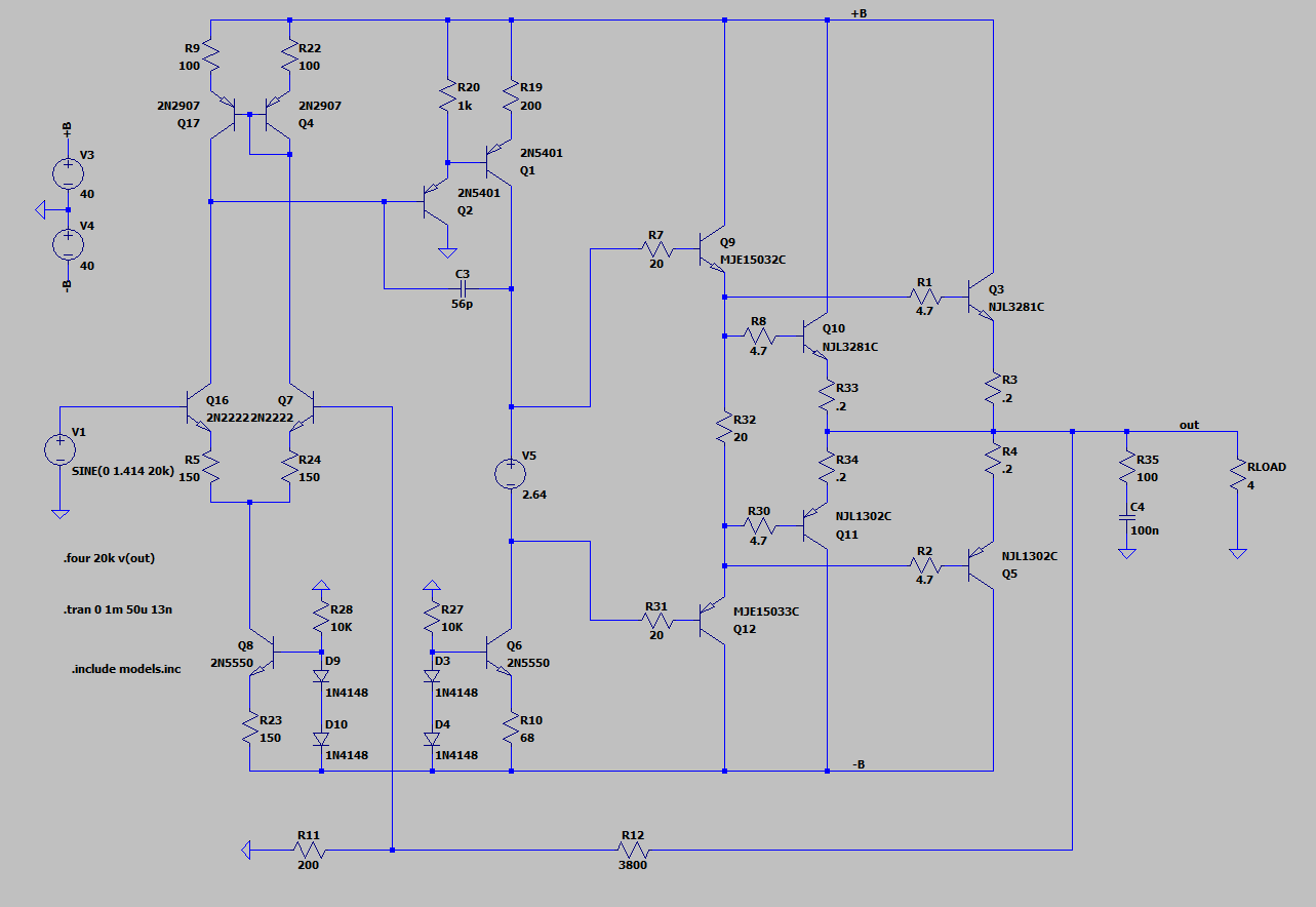

Try the same experiment with an output triple EF. Double EFs are inferior, especially when driving a 4-ohm load. That just clouds the picture.
How so? By demonstrating that some of the truths expounded here about the interplay of VAS parameters to amplifier distortion aren't, as a matter of fact, universally true?
Like it or not, in the world of discrete audio power amplifiers the double EF, despite its limitations, is probably the most ubiquitous bipolar power output stage out there.
Notwithstanding its popularity, the double emitter-follower output stage is significantly inferior to the Locanthi-type triple emitter-follower output stage in virtually all respects.
