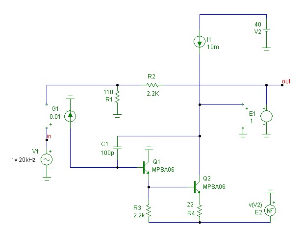

Hi Mark,
That's not my experience. Distortion due to the nonlinear Cob of the VAS, is not reduced by Cdom. One might reason that Cob is "swamped" by the much larger value of Cdom, but the distortion will be still there, undiminished.

Hi Mark,
Cheers, E.
Hi Edmond,
I think you are referring to a 1T VAS, where Cob is essentially in parallel with Cdom. In a 2T VAS, the EF up front breaks this path for Cob of the VAS transistor.
Bob

Hi Mark,
Before I put my comment, I made sure that this -rather counterintuitive- statement does hold by simulating the VAS distortion.
Cheers, E.
Hi Edmond,
Bob
Hi Bob,
Indeed, I was referring to a 1T VAS. To make the story complete, I've also simmed a 2T VAS (in isolation!). As expected, the distortion (due the nonlinear Cob) was much lower, about 1ppm. But adding Cdom had the opposite effect: THD rose to about 1.5ppm.
Cheers, E.

You measured the distortion of the VAS by itself, or the overall distortion?
This may be a consequence of loading interaction between distortion mechanisms, which gets complicated and which I specifically was not considering here. The VAS in isolation should be linearized because you are adding more linear feedback (assuming the cap is NP0 of course 🙂

Hi Mark,
I "measured" (read: simulated) the overall distortion, but since the rest of amplifier (input- and output stage) comprises ideal components, the only source of distortion is the VAS. See picture for the 2T VAS.
True. But at the same time the gain of the VAS is decreased by the same amount. As a result, the overall distortion is still the same, or even (slightly) worse.
As Bod already suggested: "when Cdom was added was a result of Cdom's loading of the 2T VAS, increasing required current swing a bit."
IOW, the input stage has to deliver more current, which -inevitably- will lead to a little more distortion.
Cheers, E.

Cdom linearizes the current in -> voltage out characteristic of the VAS where it is dominant (which is not a given).
However increasing Cdom will not reduce the distortion of the amplifier barring edge cases.
This trope of "Cdom has a linearizing effect" is taken way, way too far. It is intuitive, yes, and it's very very wrong in the way everyone seems to use it here. Like some kind of virus.
Cdom just adds to the current through Cob, it does not eliminate it in any way, and it also adds whatever distortion is present at the VAS output.
I don't completely agree with some of the terms you are using here. I think it adds confusion to the discussion. What people have been discussing here about Cdom has not been way, way off.
One also has to be very very careful about whether one is talking about a 2T VAS or a 1T VAS.
The Miller feedback around a 2T VAS is simply shunt feedback, and it does provide linearization in the frequency bands where its local loop gain is adequate. This means that there can be exceptions at very low frequencies, but those exceptions can add to confusion if they are given too much prominence in the discussion.
