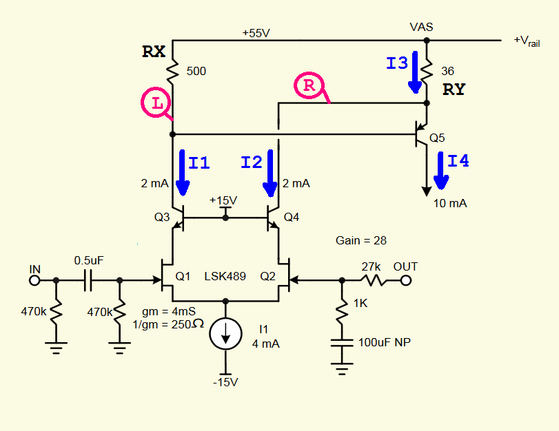

I've attached an image. Some things that the circuit designer will consider when proportioning this circuit, might include
* Choose I4, the current in the 2nd stage aka "VAS". It should be large, so the VAS can drive the OPS authoritatively. But not so large that the power dissipation of the VAS transistors is unacceptably high. Bob Cordell has chosen 10mA which, with plus and minus 55V supplies, means the VAS transistors will dissipate 0.55 watts. They need to be TO-126 devices and they need heatsinking.
* Choose I1 and I2, the currents in the two halves of the input stage differential pair. Choose them to give acceptable transconductance gm, while minimizing power dissipation in the input pair. Bob Cordell has chosen 2mA for each; Douglas Self very often chooses 3mA for each. That's 0.11W or 0.17W with 55V rails.
* Calculate the gm of input devices Q1 and Q2, using the hybrid pi model. Or from the semiconductor physics device equations. Or from curves on the manufacturer's datasheet.
* Choose resistor RX such that (gm_Q1 * RX) >= 2.0 . Then the half circuit gain (at node L) is 1.0 or greater. This ensures the input stage actually provides useful gain, it's not merely a current conveyer.
* Calculate the voltage at node L. It's Vtoprail - (I1 * RX). You now know Vtoprail, you know I1, you know Rx. So this is simple arithmetic.
* Calculate the voltage at node R. It's VL + VBE so again this is simple arithmetic
* Calculate I3. It's I4 - I2 and you know both, so it's simple arithmetic.
* Calculate RY. It's (Vtoprail - VR) / I3 . Again simple arithmetic
* Victory
The difficult bits are (A) estimating VBE to within 5 millivolts; and (B) calculating gm to within 5%. I recommend plain ordinary lab measurement. It's very difficult to disagree with measured data. Especially if you made the measurements yourself!

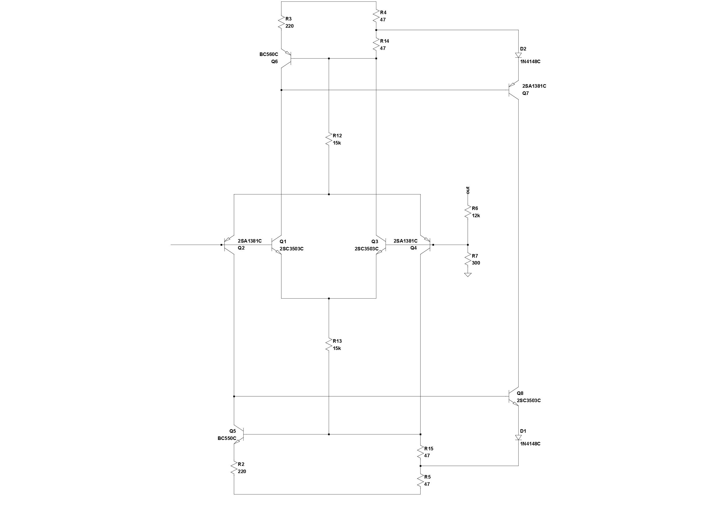

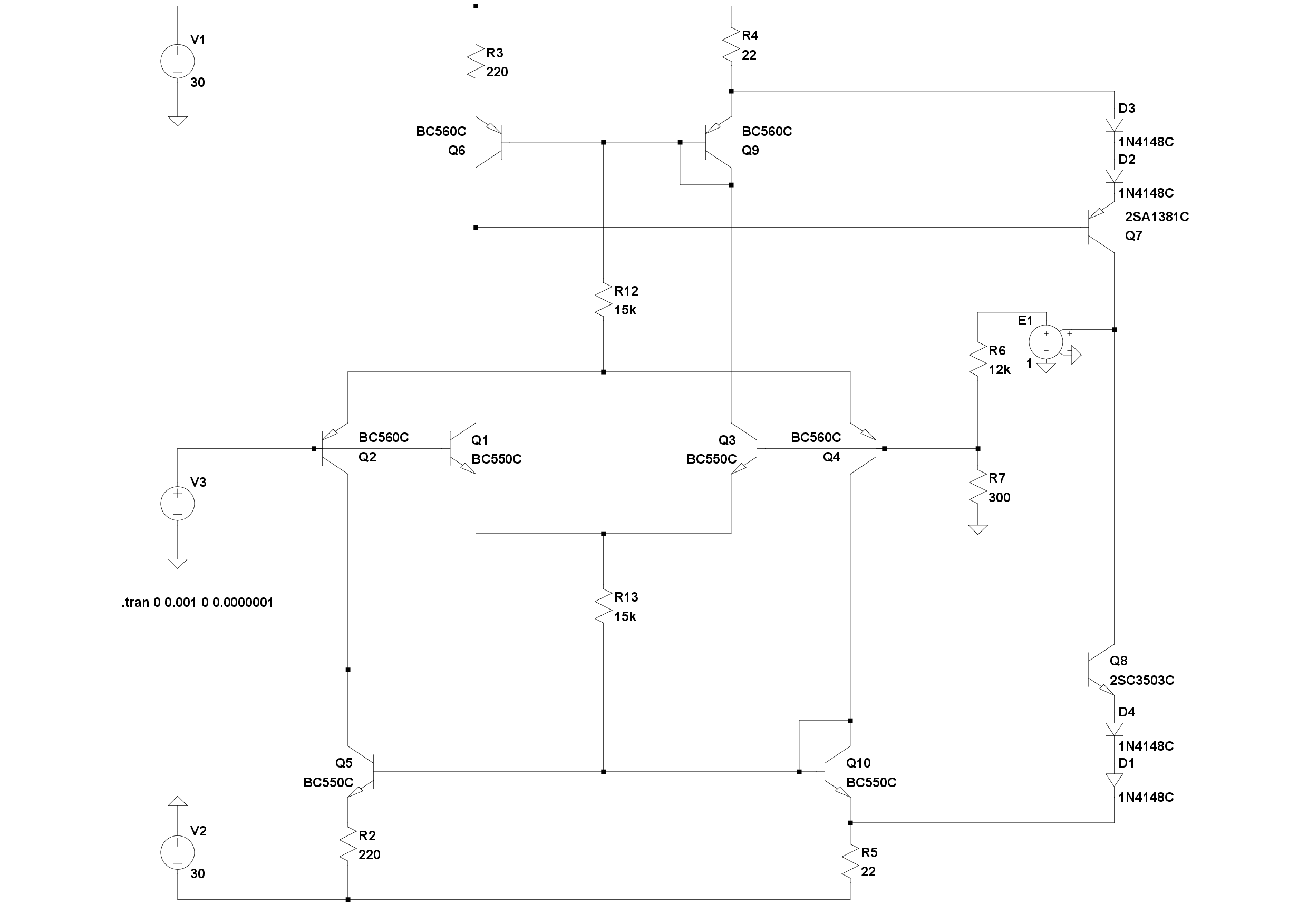

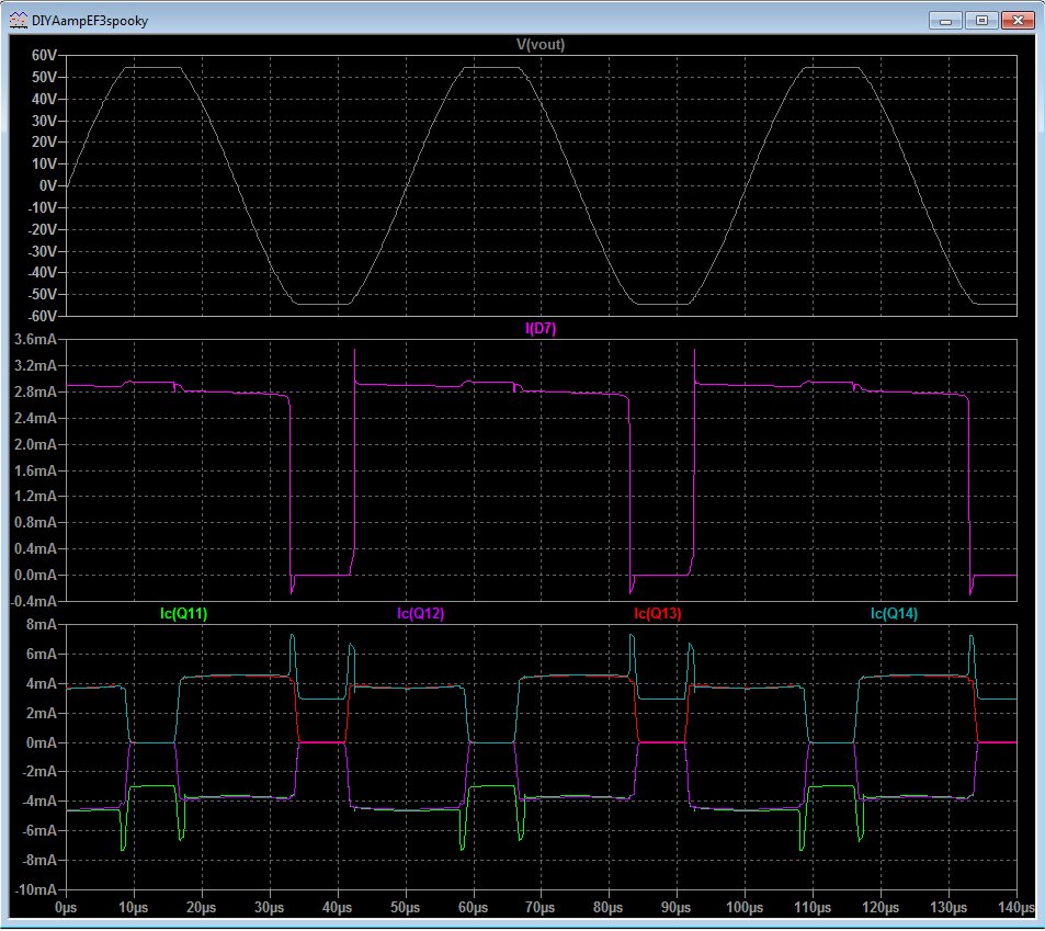

That's great info Mark. I optimized my values on the simulator. I ran the input stage and VAS currents quite high - 5mA per side and IIRC 20mA in the VAS. I've backed off a bit on the VAS currents now, and the front ends are not VFA anymore, but CFA.
How about this sort of thing been mentioned?
By combining IPS I picked up from Edmond Stuart and another solution by someone else (not me but can't cite the person) this was the result. Not quite mirrors but these could be reinstated. It clips better with resistors...
Paul
Paul
Wow, medium power devices in TO-126 for the inputs, but low power TO-92s for the current source loads.
Yes, it's just an experiment at the moment. Could easily add cacodes and use TO-92 for the input devices. The TO-92 is fine for the "current mirror".
In it's current configuration from a dissipation point of view the choice of transistors makes sense. The rails for this are 63V in my sims. It was a quick cut, simplify and paste....

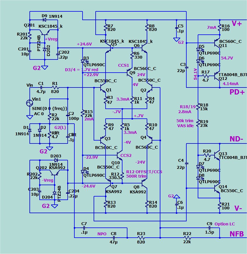

Crude , but I just use this ...
It's the most popular , too. (below)
Over 100 built by others. My 4 ... I used two for music.
One I used for abuse , can I blow it ?? 0-70C VAS I(4.1-4.2mA).
Idle to full -same. Clip (below 2) VAS drops a little to 3.5mA.
The input stage became cool , in fact .... always cool.
Just a big 17mA per rail discrete op-amp with a little light show 😀
LED's flicker on clip.
I can't understand the dislike of complimentary designs.
Or , using so much current in all the stages. I know I could get
more gain @ 2-3mA, but use 546B/556B (or C). All semi's are lower voltage
except Q12/13.
OS

Not to complicated, but low distortion and high slew rate.

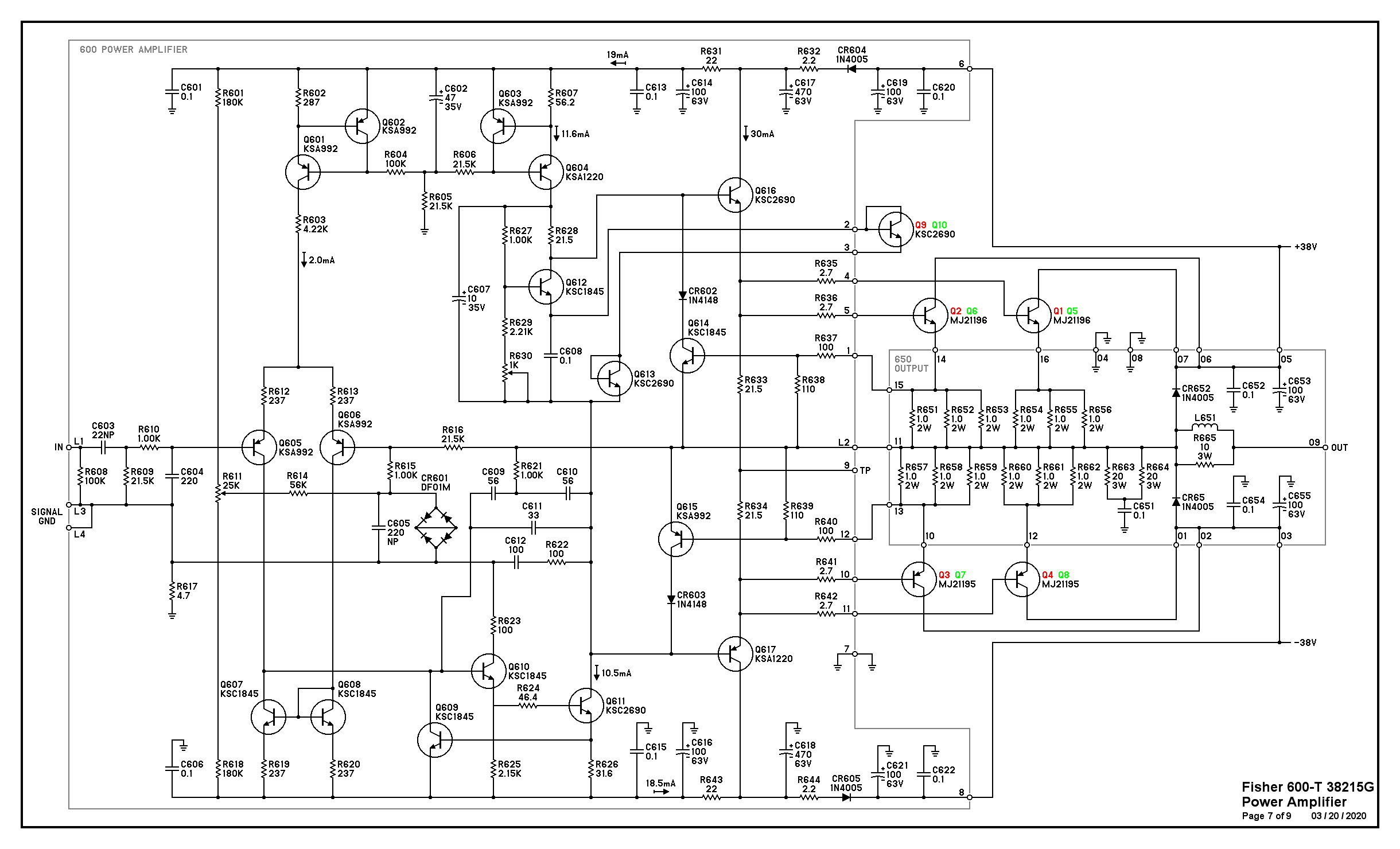

Follow up from early last year. A rough drawn schematic of a power amplifier was posted. That amplifier is now completed and in service with an updated schematic below.
As may have been mentioned earlier, this is a replacement amplifier for a Fisher 600-T receiver. The original circuit was 4 PNP germanium transistors in series to handle the voltage. The circuit was similar to that in an early RCA Transistor Manual and was subject to many problems. Since it used 4 output transistors per channel, it was easy to use parallel devices in the new design.

Success in getting the schematic uploaded.
C609-C611 ended up being a slightly unusual arrangement for the Miller capacitor, but it works.
Q613 is clamped to driver Q616 and Q9/Q10 are clamped to Q2/Q6 to control the bias spreader.
Constant current limiting at 4.2 amps is provided by Q614-Q615 and R637-R640. Only one pair of output transistors is sampled, so the total current limit is slightly over 8 amps. The circuit will handle this long enough to blow the 2 amp rail fuses.
R633-R634 connect the driver transistor emitters and the point between them is taken out to a test point. Driver current is 30 mA and eliminates the "speed up" capacitor.
L651 is 11 turns of #22 wire wound around R665.

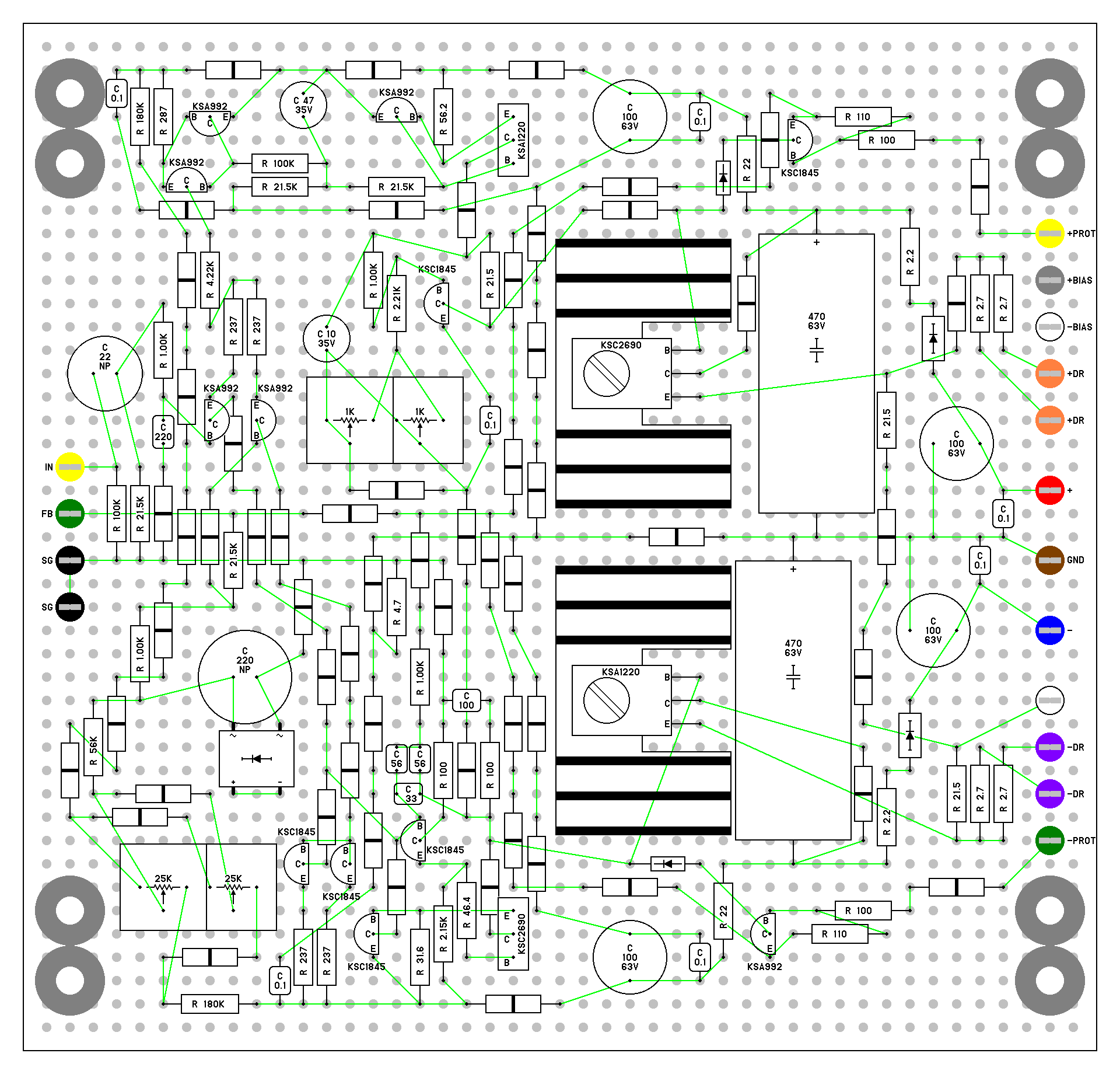

Below is the physical layout. The light green lines are the wires on the back side of the board.
After rereading much of this thread, it appears that VAS transistor, Q611, KSC2690 might be replaced with KSC3503, which has lower Cob.
Since this uses the existing 600-T power supply, rail voltage is ±38 volts, no load. I do not have a distortion analyzer, but output just below visible clipping is 56 watts per channel, both channels driven, 1kHz and below. 10kHz power drops to 52 watts and 20kHz drops to 42 watts.
With a 4 ohm load, power is 66 watts, limited by the 2 amp rail fuses. 2.5 amp fuses might get it up to 100 watts but it would stress the power transformer.
Thanks to Bob Cordell, Douglas Self, Bonsai, and others for all of the valuable information.

Lender circuit
In the Audio Amateur article from 1982 Erno Borbely strongly implies that the VAS transistor in the Lender connection is common base. It would seem to be a hybrid as the base is driven as well as the emitter. In Borbely's version the polarity of the followers is changed so the collectors returned to the rails. This makes the voltage across the diff pair collector resistors about the same, for DC analysis.
Has anyone considered whether Borbely's claim has merit?
Jeff
Jeff
I asked a somewhat related question MANY years ago:
https://www.diyaudio.com/forums/solid-state/2309-power-amp-driver-block-topology.html#post18104
Nelson's post directly below yours is exactly correct. The circuit on the left is not really a cascode in terms of where the dominant action is in controlling VAS current. That circuit is mainly a cute trick to make the collectors of both diff pair transistors see the same VAS input voltage, but it makes very little difference. Both of these circuits are inferior to the IPS/VAS circuit where a current mirror is used.
In a true folded cascode, the limitation is that there is no signal current gain in the VAS. The VAS collector signal current deviation is no greater than the signal current coming from the input pair.
Bob
