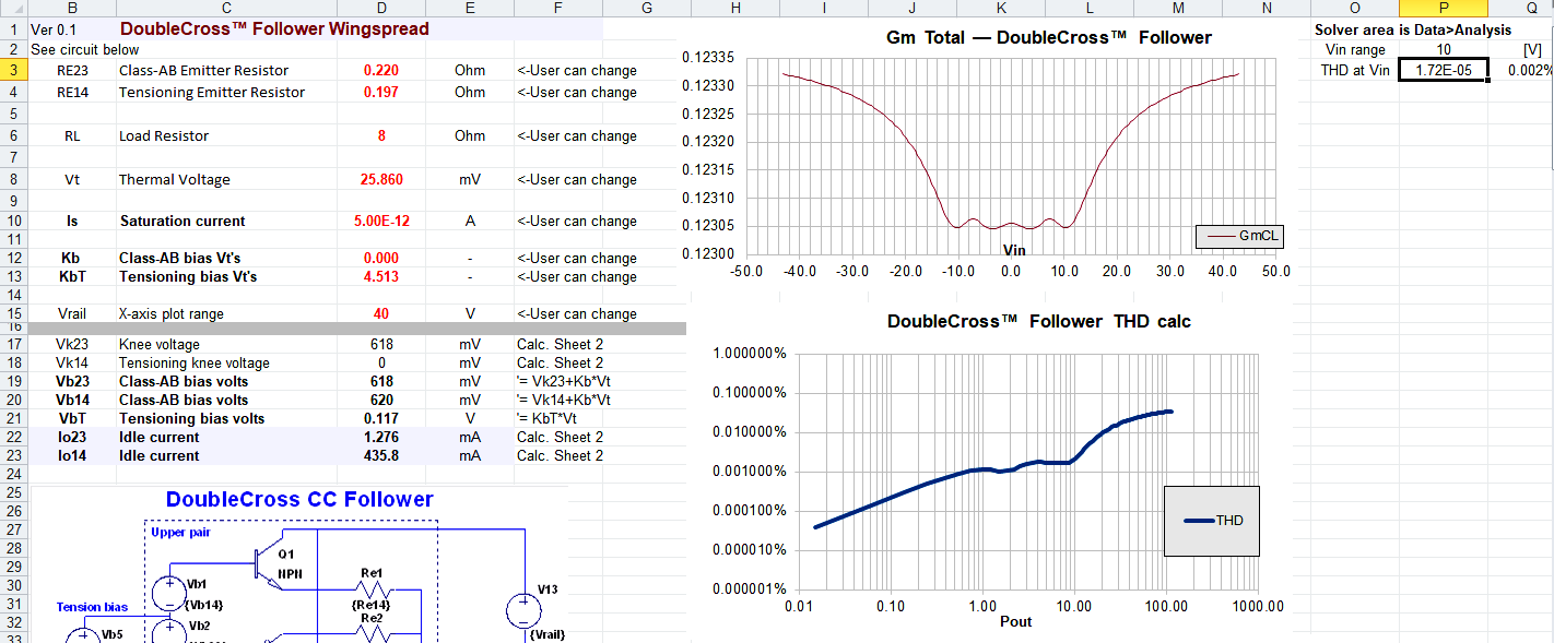

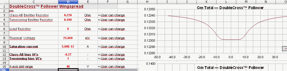

Hi Bob,
Here's the link for a DoubleCross(TM) spreadsheet for the Follower:
PAK412-Spreadsheet-DoubleCross-CC-wingspread.xls - Google Drive
Use 0.22 ohm and 0.18 ohm emitter resistors that you suggest in your book and with 290mA bias there is a relatively wide near zero distortion region up to a few watts.
Of course a practical amp bias will drift with varying signal levels of music so I don't have any idea yet how low the distortion can be maintained in a practical amp.
I saw a few posts ago your BC-1 build will have DoubleCross(TM) so you maybe able to get some figures soon. I'm looking forward it.
Cheers, Ian

Hi Bob,
Cheers, Ian

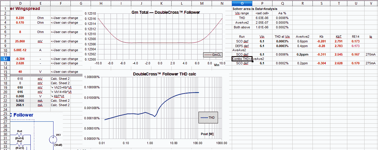

Hi Bob,
Nice to hear from you. My sims used 80mV for he tension bias (3*Vt). For 80mV across the base stopper there needs to be 17mA. Double that for two pairs. So I see the need for 5 ohms base stopper rather than 2 ohms.
If you (or anyone) are interested the spreadsheet now has a section added to calculate THD as a function of input swing Vin and hence output power (ss link in earlier post).
I tried to get the same THD as LTspice for the same settings as the spreadsheet but the lower Vin THD calculations are lower than LTspice. There may be something I have overlooked, but so far the shape of the THD graph follows LTspice THD vs power plot which is a good start. I calculate THD first by finding the average gain for any Vin swing (as a running-average), then I find the deviation for each Vin increment up to Vin, and then average that from Vin=0 to Vin to give the ratio of distortion to the total signal for any Vin sinewave swing.
The xls version also runs with Solver so you can goal seek. I made RE14, Vb and VbT variables and chose the cell THD at Vin=10V as the value to be minimized. It returned a lower value changing RE14 from 0.18 to 0.194 ohms and Vb and VbT. It took 0.1 seconds to optimize (a log can be exported to an added sheet). The gain plot went from flat between -5V to +5V to wavy-flatish between -10V to +10V - a relatively low THD up to 6 watts.
Solver is very useful for biasing strategies for DoubleCross. There are so many more variables with DoubleCross than the simple two pair output stage making it almost impossible to find the best resistor values and best biasing with say LTspice.
And "best biasing" depends on whether you want higher order harmonics need minimizing (for best amp quality) or if unweighted THD is sufficient. At present Solver doesn't minimize higher order harmonics. But it's a good start. Enjoy🙂
To add Solver to Excel enter Solver in Excel Help and follow the instructions. It then comes up under Data>Analysis. Enter the cell reference to optimize and then the cells to change, eg RE14, Vb and VbT on Sheet 1) then Solve. Look at the new values and accept changes. I used Solver's default engine.

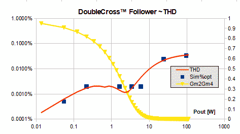

Update
Hi Bob, All,
I have added compression of the spreadsheets calculated THD to conform with LTspice THD as shown (for the best flat region bias Kb=-0.27,KbT=3):
I chose to use "GmQ2+GmQ4" to compress the low-end THD where the two transistors contribute most of their gain and cause the low-end THD flat part. Using this is variable just a hunch, I need to check if it still gives reasonable THD estimates for other bias conditions.
I notice your 2nd Ed book has measured DoubleCross THD plots (Figs 13.11, 13.13 and 13.14) and the spreadsheet THD plots are similar - almost believable😉.
Both xls and ods spreadsheets have been updated on Google drive (links above). The xls version has Solver set up.
Hi Bob, All,
Hi Ian,
This looks like really good work! Thank you! It is remarkable that you got results similar to actual measurements with a spreadsheet. That deserves a toast!
Its been almost a year since I worked on the first PCB prototype of the BC-1, having spent a great deal of time on the DH-220C. I am now in the process of stuffing the the next generation of BC-1 PCBs. Rick Savas and I did a major physical design change to make the boards more compatible with a nice 3U enclosure. We also made the design a bit more modular, with AFE (IPS/VAS),
OPS and protection (PROT) on 3 separate boards of equal height that will mount on the heatsink side of the enclosure. As soon as I get this BC-1 Rev. 2 up and running, I'll evaluate it in the DoubleCross mode and let you know the results. Rick has also designed a power supply board for the BC-1.
Best regards,
Bob

Hi Bob,
Nice. Maybe there is some way to do an A/B comparison while running like removing the link resistor between bases that removes the offset between pairs (and then re-bias for the ordinary optimum). maybe it would take some time for the heatsink temp to stabilise but still it might be helpful.
Thanks for a thumbs-up on the spreadsheet. One use for the DoubleCross spreadsheet is to find what biasing and emitter resistors gives the best linearity in the lower power region where distortion goes almost to zero before global feedback and up to a few watts. I have now used Sun's Solver engine with OpenOffice and used to to find values for the best linearity in the lower power region (as shown):
I have added another distortion metric which is the average deviation of the THD - it is averaged from Vin=0 up to my low power (Vin of 6 Vpk) - it gives a value for "waviness" in the wingspread low power region (I expect that relates to higher order harmonics which means more in audio amps than straight THD). Using this metric Solver tries to get the bias setting for the flattest gain in the low power region.
Using this approach I found the DoubleCross gave ten times lower distortion over the whole low power region than I was able to get by manually changing the bias values and the emitter resistor value for Q1,4.
Putting the new values into LTspice there was some improvement in linearity and THD.
So the spreadsheet with Solver optimisation is some help for designers of DoubleCross.
Cheers, Ian
