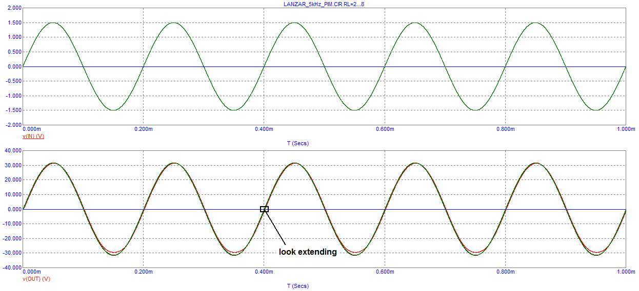

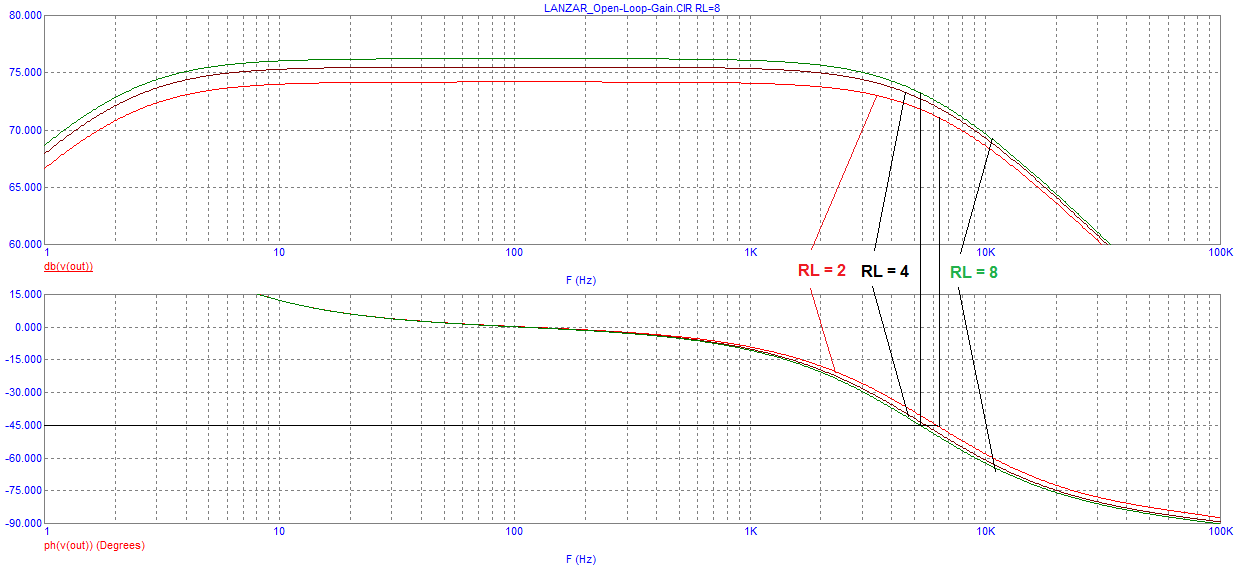

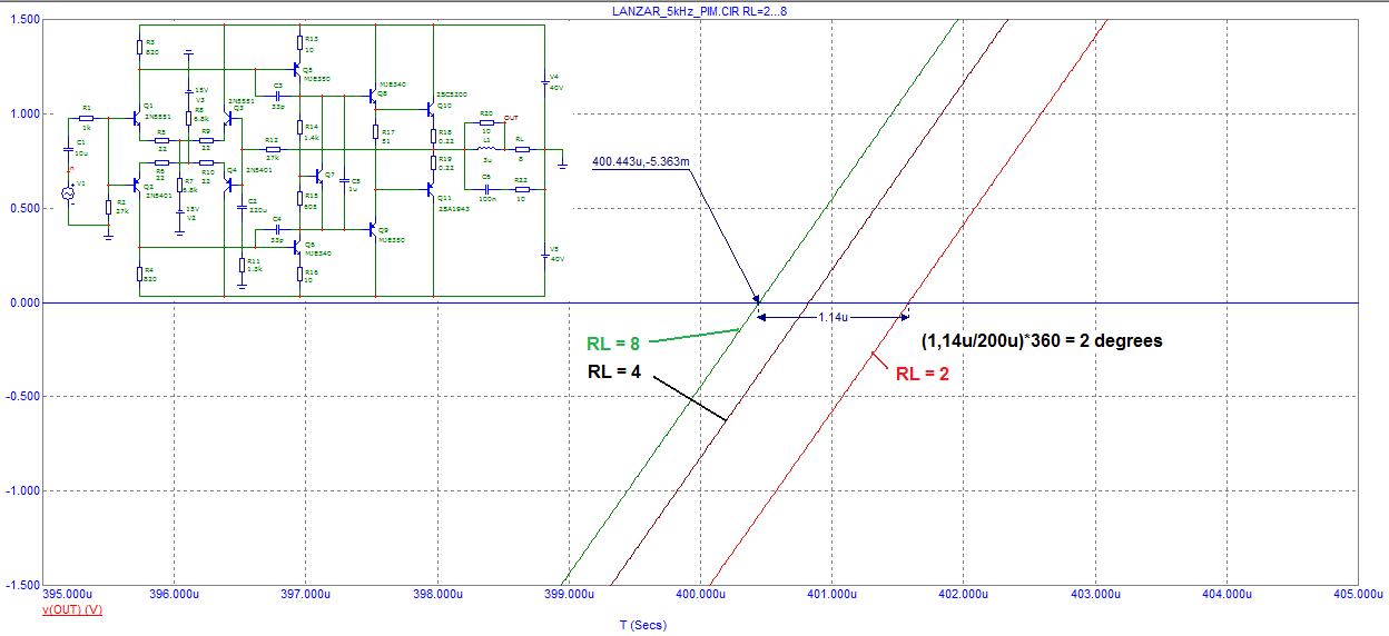

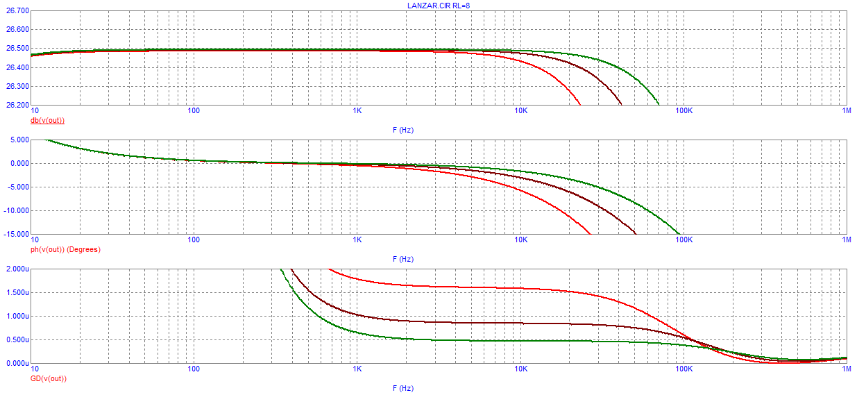

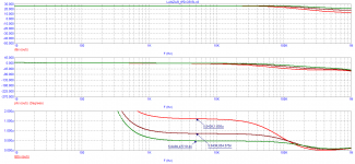

Phase deviation occurs to a greater extent in amplifiers with Miller correction.
When the load changes, the VAS gain changes, along with it, the Miller's dynamic capacitance changes, which causes the phase deviation.
This can be seen on the example of the LANZAR amplifier.
