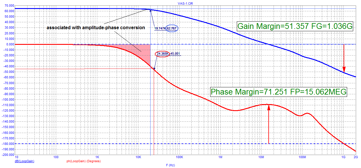

this is due to the peculiarities of the loop amplification and, first of all, to the frequency of the first pole
Bruno Putzeys
Hypex Electronics, Grimm Audio, The Netherlands
On the occasion of the 123-rd AES Convention, October 6, 2007
Not scientifically established but useful nonetheless:
1. When you’re strapped for loop gain at 20 kHz, limit low-frequency loop gain to the same value.
2. THD becomes higher but constant throughout the audio band.
3. Colouration becomes less obvious and less annoying.

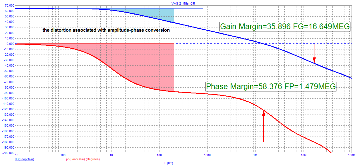

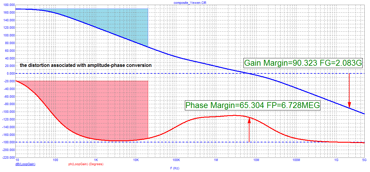

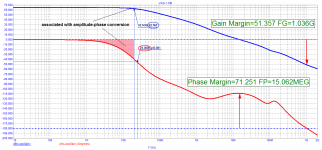

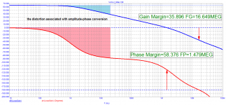

1. So we came to the first pole with a frequency of 20 kHz, and in 97% (if not more) of the released amplifiers it is not higher than 1 kHz.
2. Not only is the THD stabilized, but the output impedance becomes constant throughout the audio range. Decreases the phase deviation of the loop amplification in the audio range and, accordingly, the distortion associated with amplitude-phase conversion.

Definitely not scientifically proven. This harks back to the de-bunked TIM arguments of the 1970's made by Matti Otala. He made similarly-de-bunked are guments about Phase Intemodulation distortion (PIM).
In particular, the open-loop bandwidth has no effect on modulation of phase. In a feedback amplifier, the closed loop phase is modulated by changes in the closed-loop 3-dB point, not the open-loop corner. This is because ordinary amplitude intermodulation causes across-the-board gain changes in some stages that then cause changes in the closed-loop bandwidth that result in minor phase deviations in the closed loop response. See the paper on PIM on my website. It is important that one recognize that a power amplifier is essentially a minimum phase system.
Bob

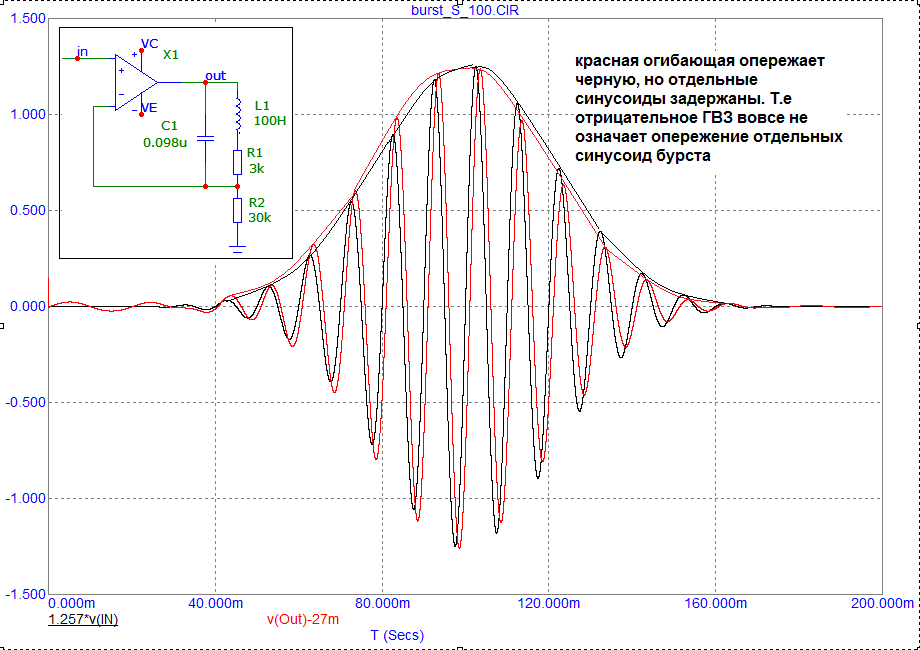

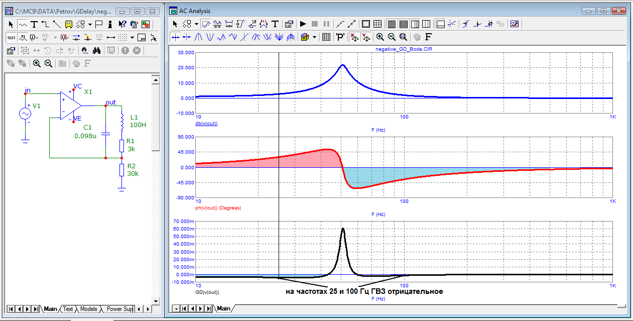

Phase shift and group delay are completely different concepts. The group delay can be negative in a certain frequency range, while the phase shift can be both negative and positive, depending on the frequency: to the left or to the right of the group delay surge (overload).Seems phase shift and propagation delay are sometimes confused.
Here is a real example
At 100 Hz, the group delay is negative (the envelope of the output red signal is ahead of the envelope of the input black signal), and the phase of the output signal is lagging.
At 25 Hz, the group delay is also negative (the envelope of the output red signal is ahead of the envelope of the input black signal), but the phase of the output signal is ahead
This is all well and good, and we must always be mindful of the difference, but we must also be mindful of the magnitudes of these effects in the audio band. PIM, for example, is real, but it can be remarkably small, and largely has nothing to do with where the open-loop pole is in the NFB open loop.
For some perspective, you should take a look at a second-order or 4th order Linkwitz-Riley speaker crossover.
Bob
Bob

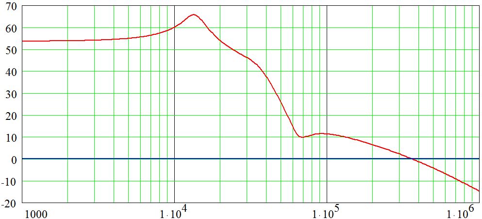

is there a phase plot for the Hypex? That looks challenging to stabilize.
Hi Demian
It is almost impossible to stabilize it when it's coming out of clipping so one have to "knock out" one active pole.
To have a look at the phase plot(s) you should download the following
Whitepapers from: Hypex application notes and whitepapers
Ncore technology whitepaper
GLOBALLY MODULATED SELF-OSCILLATING AMPLIFIER WITH
IMPROVED LINEARITY
You can also read the Hypex and Purifi audio patents by Bruno.
I can point you to a schematic of a Ncore if you like to see how it's done.
Stein
