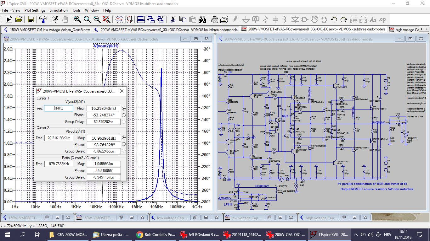

I don’t think that this lead capacitor or even Cherry type of compensation with capacitor from amp output is a way of RFI ingress from speaker and their cables.
Why, because in good designed GNFB amp output impedance (position from where the feedback was taken) is very low, much lower than the speaker cables and output inductor have. This could be even more important then DF. Simple MC is not good enough at higher frequencies, it needs more sophisticated compensation like TPC, TMC or my OITPC to get high Loop Gain throughout whole audio band and beyond.
Attached my amp simulation of the output impedance.
Damir

Hi Damir,
The output impedance in a well-designed GNFB amplifier at the point where negative feedback is taken is indeed very low at frequencies well below the ULGF, however it does rise with frequency, as does the output impedance of most any GNFB amplifier. This is not just because of the declining negative feedback, but also because the beta of the output transistors is declining as frequency increases. This is, I admit, an aspect of design wherein I may be over-conservative.
Miller compensation is fine for many amplifiers, but performance can indeed often be improved with more sophisticated compensation techniques like TPC and TMC, I agree. The BC-1 deliberately avoided these refinements in the goal of simplicity. However, it is quite easy to add TPC or TMC to the BC-1 with a couple of simple white wires and an added resistor and capacitor.
Bob
The output zobel shunts the OPS impedance, so it should not matter if it rises. To cause significant demodulation you need a minimum RF voltage across the zobel. 45mV reduces LTP gain by 6db so let's consider that a critical value. 45mV/10ohm zobel = 4.5mA RF current and 20mW into the zobel resistor, assuming the OPS does nothing to mitigate the RFI.
If this were a crystal radio receiver it could cause permanent hearing damage using headphones. So perhaps it is CM RFI we are worried about. I suspect it is the more common type.
