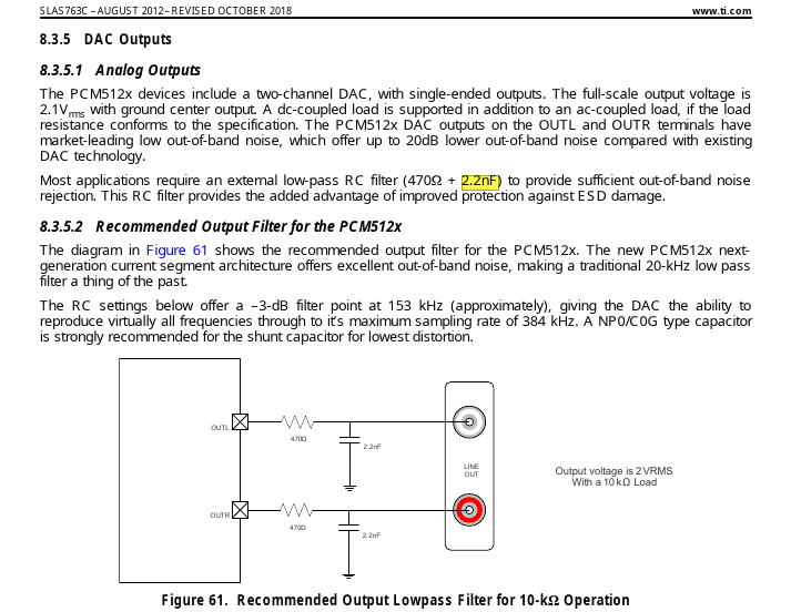

Dear Chris,
the output of the pcm5122 DAC is low ohmic and followed by a simple output filter (470R resistor and 2.2nF). See datasheet excerpt.
A standard oscilloscope probe (200MHz, 1X set) was connected from the output filter RCA side to the 1MOhm input of the spectrum analyzer.
(so the "stray" capacitance of the cables adds to the 2.2nF)
Amplifier input impedance is about 40kOhm. I think we can trust the measured levels.
BR, Toni

Dear Chris,
BR, Toni
Hi Toni,
That's a lot better than what I thought it was going to be. Your output impedance is therefore going to be about 500 ohms or so. Not too bad.
Being the careful tech I am, just for yourself, you should measure the output voltage at some of the higher frequencies to prove to yourself that it's flat. I've had some nasty surprises in the past when equipment performs differently than the specs would suggest. It never hurts to actually check and make certain the claims are true.
So, how do you like the sound of that one?
