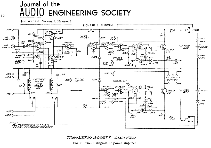

....with an output Triple, a VAS operating at still-reasonable bias current will....
So why stop there?
Return with us now to 1958. Tubes Ruled!! We liked Ike. Sherman Fairchild(!) was president of AES. And Richard was messing with transistors.
This is not the first 20 Watt Solid-State audio amplifier, but maybe one of the best of its day. Unlike many others it overloaded benignly. Because of the very limited choices of transistors, this runs a *Quadruple*. Two layers of this are powered with floating-bootstrap Mercury(!) cells, with modified relays for power sequencing. But we see a Darlington Vas Q1 Q3, a CCS load Q2, Darlington Vas buffer Q4 Q5, and "bias diodes" as still commonly used to bias the idle of a class B stage.
EIGHT stages of current gain! (Gain per stage was less those days: Vas hFE>60 and ft=60MHz was fabulous then, power 2N277 was hFE>35 and ft 200kc.)
THD @500cps (we didn't Hertz) 20W is <0.02% (10kc 1%-5% but we didn't have Disco yet).
JAES Volume 6 Issue 1; January 1958
Permalink: AES E-Library >> Complete Journal: Volume 6 Issue 1 ($33 non-member)
