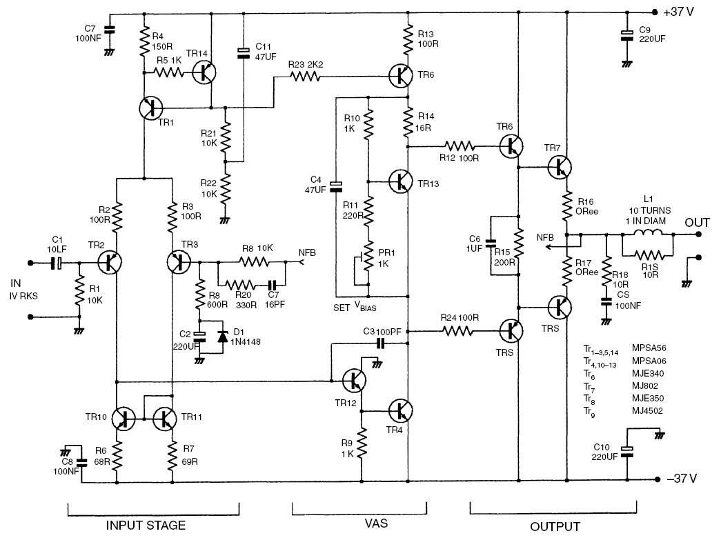

BTW has anyone read Cyrils Speaker Cable Amp Interaction article?.
The output inductor is one small consideration for stability, there are many others.
It takes some skill to design an amp that is unconditionally stable.
I'm going to read that article but did you catch the model of the amps that failed, schematic?
Read part 1 and the bipolar amps were D. Self “Blameless” bi-polar 50 watt class B amplifier.
I'd sure like to see a schematic of his exact build, PC board and chassis (grounding) layouts.
This is from a Google search, the article mentions a 10K feeback resistor with 330R in series
with 100pF across the 10K. This has those values except for 16pF in series with 330R:
This is not the exact amp but it shows 10 turns 1" diameter for the output inductor,
I'll have to measure that but it seems too low.
