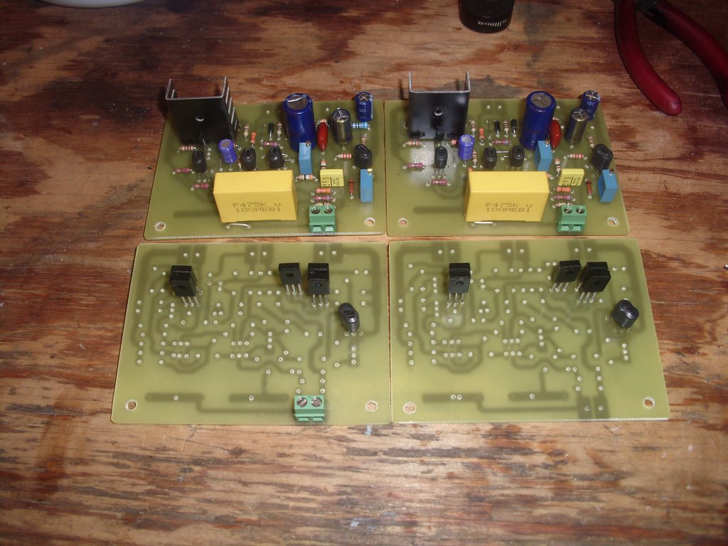

It certainly is. The necessary decrease in (the already poor) bandwidth means an increase in distortion. In the fabulous realm of simulation it is obviously different but has nothing to do with physical reality.
I deal in reality (below) , TMC has NOT resulted in ANY performance decrease in amps that I know "inside and out" (Blameless and beta enhanced balanced VAS -symasym). Scope shots and all are soon to come !! The "fabulous world of simulation" can come scary close to the real thing provided the proper models.
OS
