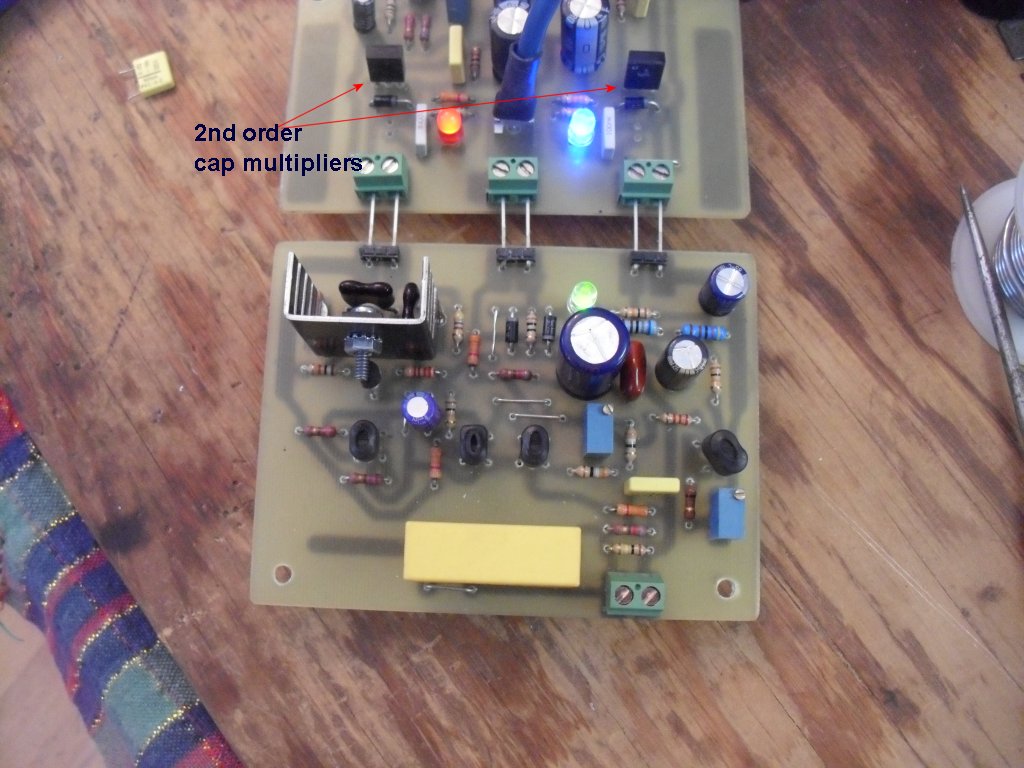

Yes,
Ostripper has shown us that deliberately mis-tuning the output stage bias has a big effect on output distortion and that adding TMC mitigates the mis-tuning. That static mis-tuning is very roughly equivalent to dynamic bias mis-tracking.
A TMC amp at 20ma (statically misbiased) sounds as good as a traditionally compensated amp with ideal bias. Really !
I now listen to the new BX (pix1) , which was designed around TMC , it is on a new level ....ABSOLUTELY stunning clarity(at normal bias). The nice thing is that I can just plug it in to my hitachi Lateral OP board .. (pix2).
The blameless has new life , one more pair of "strait" units , with CCS's , are being burned now. 🙂
OS
