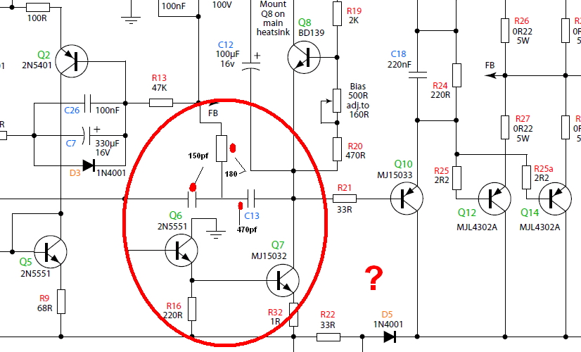

Does it? How many ideal values, how many mathematical constants, how many (missing) derivatives are employed in the bitter struggle against the uncertainty principle?The "fabulous world of simulation" can come scary close to the real thing provided the proper models.
jcx,
The larger capacitance, the more feedback, the greater linearity?"A significant aid in keeping the distortion contributed
by the final stage as low as possible is provided
by the compensation scheme, which exploits
the direct connection of the Miller capacitor
at the amplifier’s output to introduce a local AC
feedback path enclosing the output stage itself."
Edmond,
You don`t say. Could it be me? Without even giving me a chance to provide substantial evidence and logic? How long is your ignore list?I just added three more people to my ignore list, as they are not only stone deaf to my arguments, but also prefer to speculate on alleged typos without any substantial evidence and logic.
If we accept both of your statements as truths it requires the belief that Baxandall lacks the ability to select proper component values - something I find absurd given his obvious talent. This leads to my opinion that it was a typo.
So in one hand he s got huge talent, that lead to think that
he knows how to select adequate resistor value; and on the other
hand, this same talent lead him to make unprobable typos ?......
Reality is that the text is very well written, or rather copied
from a firstly hand written memo, so the "professor" had all
the necessary "recoil" to check for eventual mistakes.
The reason he s quoting a 68R return resistor lies elsewhere,
that is in the experience protocols itself.
Firstly, he says " a good deal higher than the OS output impedance"
which he says is about 20R at the frequencies of interest,
so that match the 68R value...
Secondly, he seems to set a necessary condition, that is implementing
a return path from the OS, as enough for the scheme to work,
without specifying another necessary condition that the
VAS has enough gain.
Therefore, for TMC to work, and badly , the said resistor must be low
enough to allow for a minimal NFB between the OS and VAS input.
Just make a sim using a non enhanced VAS and an enhanced
one, you ll see that the first mentioned has not enough gain
to make the TMC related THD reduction significant, using the
values we are now accustomed to.
Hence the low value resistor to increase the dominance
of the relevant NFB loop and make the effect audible
when experimenting with a zero bias OS.
That said, i agree that he did set a footstep on TMC
implementation possibility ,but unfortunately it was
develloped without his contribution since these papers
were not published in proper time to contribute the way
they should have been...

ostripper ,
Hi WuYit,
How much experience have you had builing amplifiers and simulating them? It sounds like you are being a bit too negative on simulation. If you have had bad experiences, can you share them with us?
When the simulation is done properly with decent transistor models, and when the corresponding amplifier is built well (good wiring practices, good bypassing, no parasitic oscillations, solid design), the correspondence between simulation and the amplifier performance should be quite good.
Correspondence is never perfect because of real-world things that are usually not accounted for in simulation, such as wiring inductances, wiring capacitive or inductive coupling, etc. But in a decent execution of a design, these should be second-order in their effect, and are no reason to throw up one's hands and dismiss simulation results.

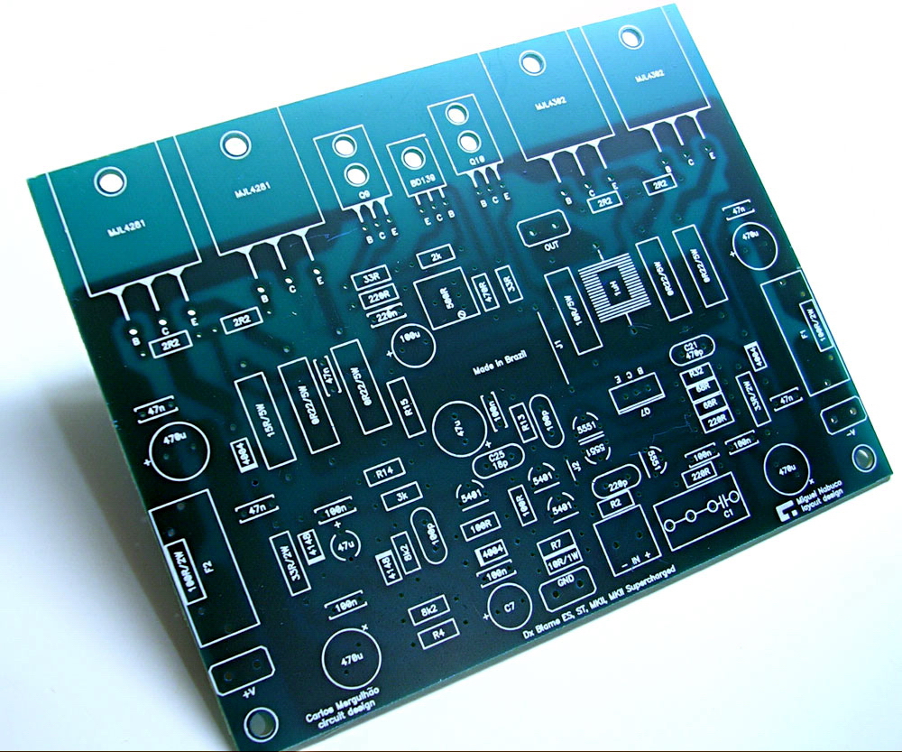

Dear Bob Cordell.... my people (Brazilians) are excited about TMC
Your book was readed and also Baxandall texts.
I have just released a new model of amplifier (hundred boards sold in the group buy...half and half to brazilians and to the international comunitty) ... and i have a few guys that wants to try the modification.... when i am asking them to wait comparative tests i should make next year.
But, as i am very curious, i would like to ask if there's some audible effects... say...clear audible effect into a blind A to B comparison.... the question is a consequence of the distortion numbers...awsome numbers...but is this inside the human threshold of audibility?...can we easily perceive that?
I have some worries because my boards, recently released, have not been made to accept this modification... was not my prevision...so, they may produce very ugly connections to try, and many of them does not know how to compare...so..they may "follow the leader"....or what the leader said....in this case the leader is you.
My last amplifier is a modified Blameless, having bootstrap to feed VAS, enhanced VAS, or darlington VAS as you have shown... something alike Blameless with some steróids.
thank you in advance by your kindness to spend a couple of minutes with me..i will feel deeply honored by that... you are one of the most respected experts in our comunitty.... but also i know you love measurements..when i love to listen and evaluate.
regards,
Carlos
Adequate for the said compensation.
THD is significantly reduced..

A question on the operation of the flying catch diode ( fig 15.11 page 327)/
Is this a solution that has been tested in reality with BJT. Will it operate correctely whenever the short happens during any program signal with any phase, providing of course you can handle the limited power.
JPV
regards,
Carlos
Hi Carlos,
Those are very nice looking boards!
TMC is certainly a very inexpensive and effective way to reduce distortion, particularly that arizing in the output stage. However, it is also fair to say that many well-designed BJT amplifiers can provide superb performance without TMC, so don't feel bad if you cannot use it. In any given amplifier development, I recommend that you temporarily compensate the amplifier both ways if you are going to consider TMC. Compensate it conventionally first, then compensate it with TMC. Look at THD-20 in each case. If the use of TMC does not improve the distortion numbers significantly, this may mean that the basic design of the amplifier, especially the IPS-VAS, can be improved, and I recommend tackling that first.
I have not done any comparative listening tests between the same amplifier compensated with and without TMC, and I honestly am not sure how much difference one could hear between the two if both are very well-designed.
As you know, I like MOSFET power amplifiers. However, due to transconductance droop, a MOSFET power amplifier with the same number of output pairs and idling at the same bias current will tend to have higher THD than a comparable BJT amplifier, at least in conventional bench tests. This was the reason I originally applied Hawksford Error Correction (HEC) to a MOSFET power amplifier - it did a wonderful job of mitigating the effects of transconductance droop. For similar reasons, I think TMC can be used to make the biggest difference in MOSFET power amplifiers; one then gets the benefits of MOSFETs and has THD-20 that is competitive with the best BJT amplifiers. One could always argue, of course, that one could apply TMC to a BJT amplifier and get still better THD performance.
There is, however, an argument that makes TMC very attractive for BJT amplifiers, and it may have little to do with static distortion measurements. It has more to do with what happens to crossover distortion under dynamic music conditions, where thermal bias mis-tracking may be poor, resulting in much worse crossover distortion than under static conditions (this is much less of a problem with MOSFETs). Here the use of TMC can mitigate some of the nasties of BJT output stages.
Bob
