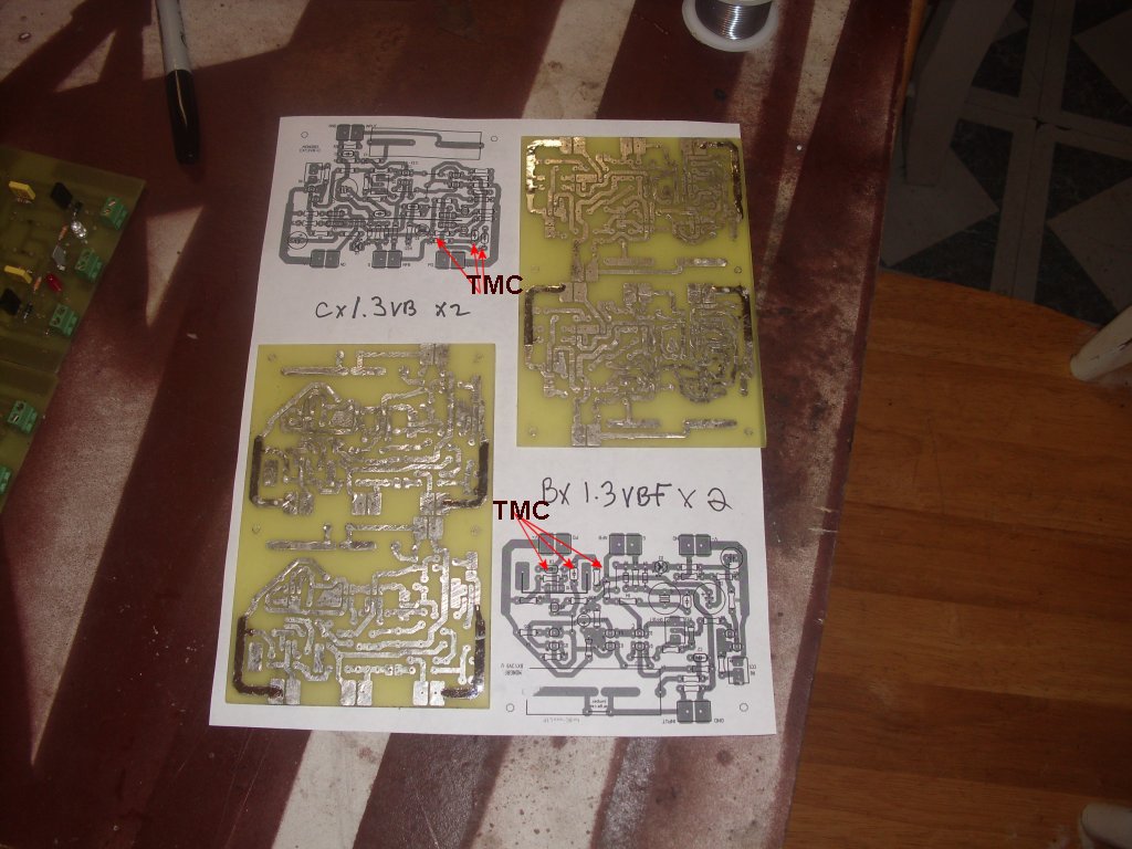

I Built 2 in prototype , am listening now. One of my builders ,(SNG001) in Australia has a pair http://www.diyaudio.com/forums/solid-state/169590-mongrel-supersym-ii-17.html#post2377265
Tomorrow , I will have 4 more TMC creations (pix 1-below) , just burned the boards. 1 pair is the replacement for the working prototype (BX - "blameless" w/cascode and bootstrap current source) and the second (CX) is the untested beta enhanced balanced VAS (like a symasym). Both top 90db OLG. . As far as measuring them , a simple CRO will do. Observe Xover point while decreasing R or watch the correction (you can hear this) as you underbias. I can't afford an AP precision , but the improvement is SO apparent it almost seems like "cheating". 😀
OS
OS

I Built a pair, sim it before I instaled it to my old amp using power supply only.
It is blamelees with bootstrap for beta enhanced VAS.
Sound i so sweet that I beginnig to think that there is no need for complicated amps.
LTspice simulation shows cca 50pp at 3kHz.
dado
