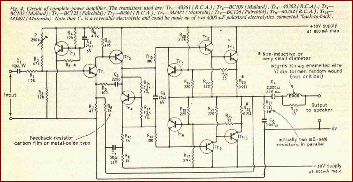

to those that can look and see HF operation:
Can you explain why C2=220pF has been chosen at a high value?
Normally it's <<47pF.
Note that R23 is 100 ohms; the time constant of that branch is, mainly, a function of R23 and C2. If we were to scale the entire feedback network up so that R23 were 1K ohm then C2 would be 22pF, however the higher Z feedback network would be more sensitive to stray capacitance and Cin of the negative diff pair input. While we do sometimes mention actual component values here, what really matters is the transfer function of the network.

In the postscript of Wireless World, december 1970, for his class A amp Linsley-Hood proposed about the same compensation, a 1000p cap from the VAS collector to the emitter of the input transistor, drawn dotted in horizontal position in fig. 1 of :
http://www.tcaas.btinternet.co.uk/jlh1970.pdf

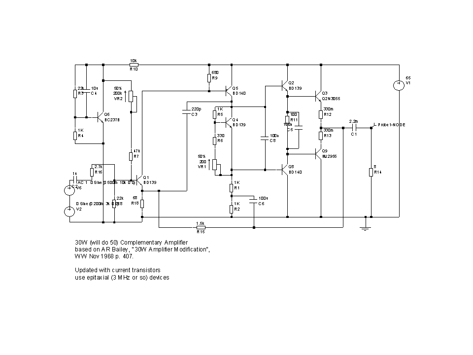

However, Bailey used an RC circuit in series (100 Ohm, 220 p) for the same kind of compensation in his 30-Watt amp, wich was detailed in Wireless World, May 1968, pp 94-98 (first attached picture)
It seems, this circuit was modified in november 1968 leaving out the 100 Ohm resistor (second attached picture).
For first two parts Bailey's article, send me an MP.

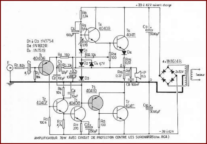

That looks like some sort of translation, this is an early and similar RCA reference design but it does not use MIC:
Bob this is what I believe is the basis for the Citation 12 by the way:
http://www.diyaudio.com/forums/soli...-12-substitute-transistors-3.html#post2355300
That looks a bit like the "Brute 70" published in the Feb. 1967 issue of Popular Electronics:
http://www.swtpc.com/mholley/PopularElectronics/Feb1967/PE_Feb_1967_pg43.jpg
http://www.swtpc.com/mholley/PopularElectronics/Feb1967/PE_Feb1967.htm

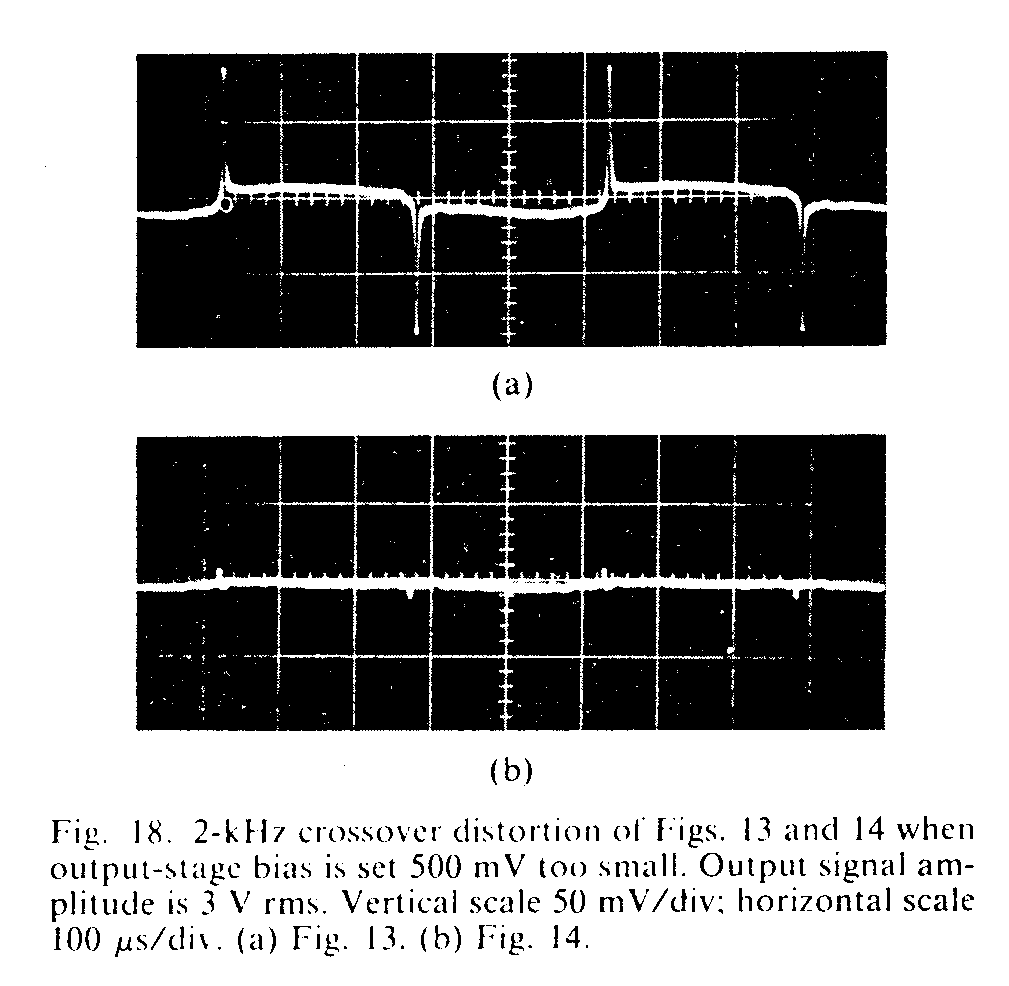

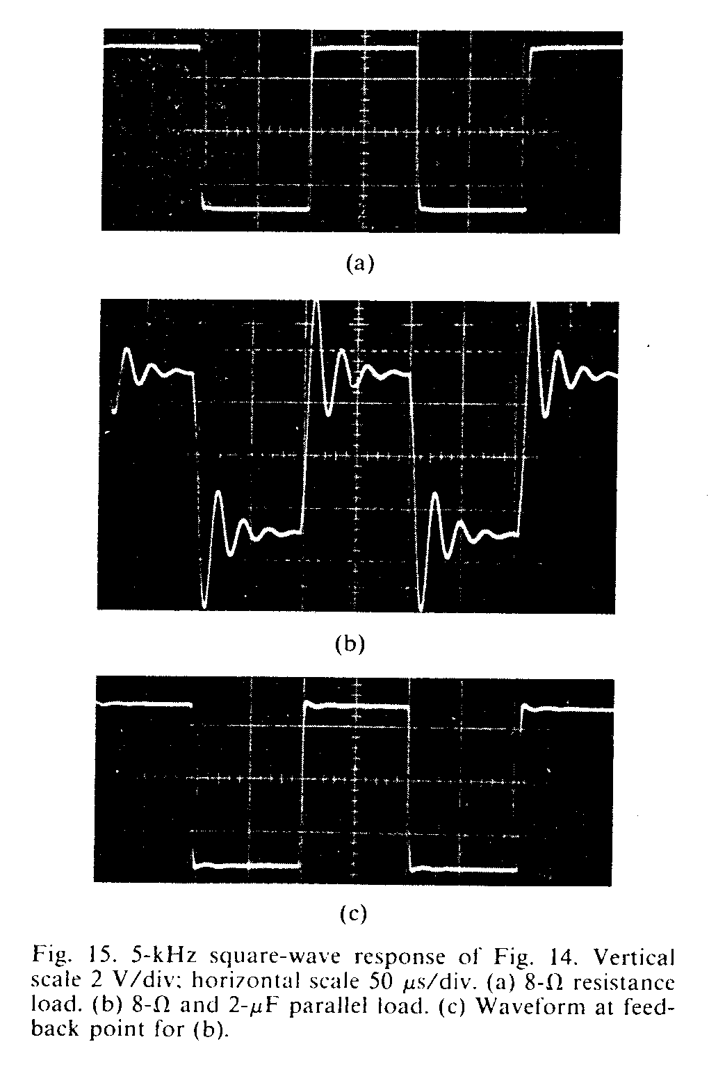

As far as I understand, tens maybe even hundreds of Cherry's designs has been built by his students. In the JAES paper he also showed some oscilloscope pictures (see blow). So we can safely assume that his amps do work in real life. But..... These are not just "output inclusive compensation" amps. If we look at his recommendations to make them work (see 3rd pic), he also put 30-50pF caps between the base and collector of the drivers. Effectively, this means an additional shunt compensation at the VAS output!. IOW, it's a hybrid form of compensation. Should we call it 'HMC'? 😉
I never said his amplifiers didn't work. I said that it was a matter for considerable concern that he gave no measurements to back up his mathematics. I cannot tell you how many ingenious amplifier schemes I have seen that calculated and simulated wonderfully but were quite unworkable in practice.
On the other hand, I have met several people who tried to build NDFL amplifiers but could not stop them oscillating. Hard words were said.
