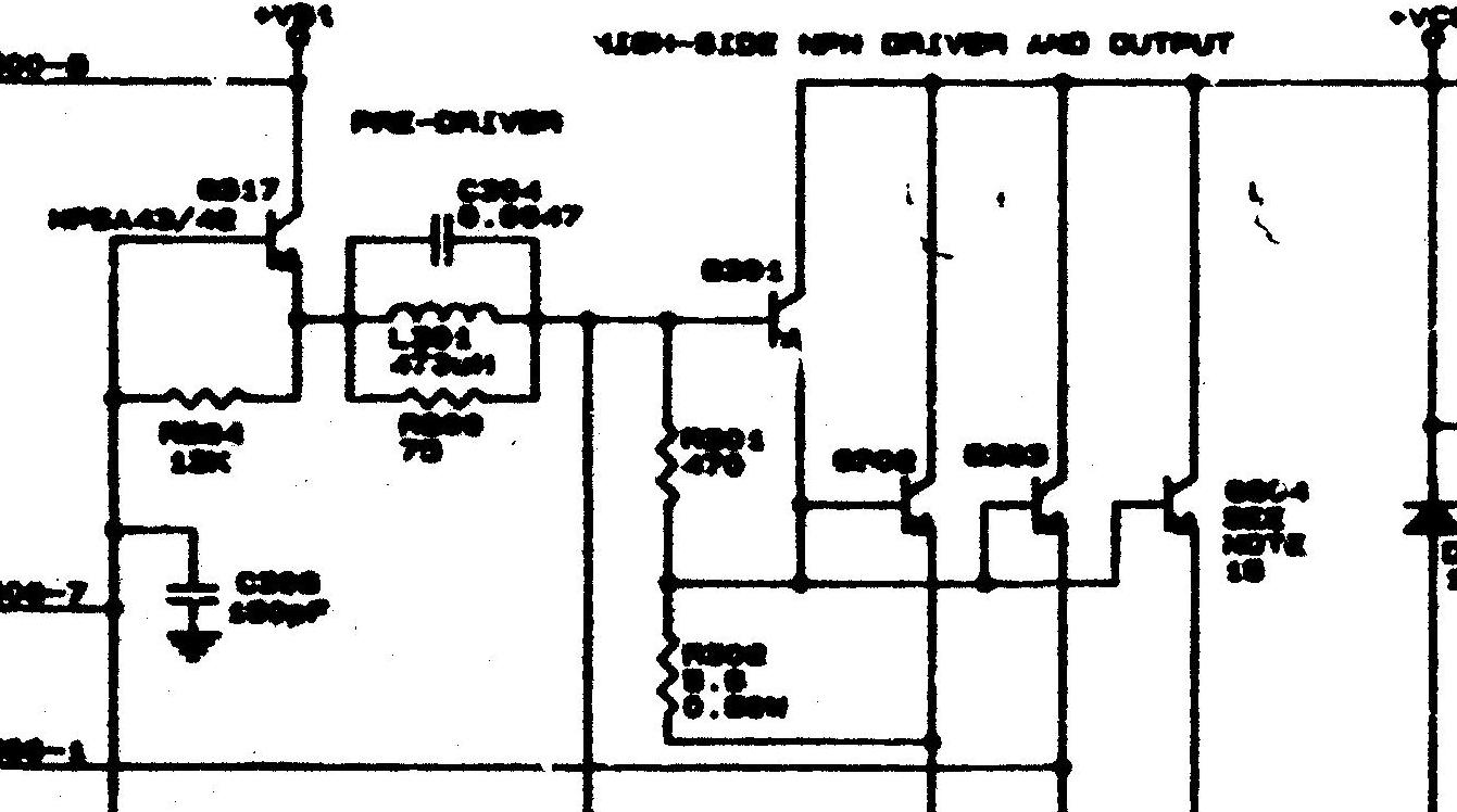

Wouldn't it be a good idea to bypass the base stoppers with small inductors? E.g. 10uH in parallel with 10R for an output device. That should improve thermal stability and distortion without hurting RF stability. The little ones that look like resistors and cost peanuts would be ideal.
I've never seen this done, though. Am I missing something?
Crown did this in there Macro Tech series, but not necessarily on the output transistors.
They used a parallel LCR.
David.

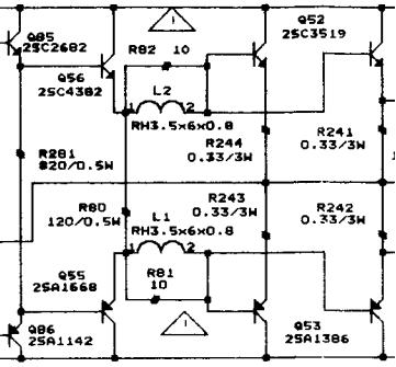

Hi, take a look at this HK OPS.
Edit: And many thanks to Bob Cordell for your nice book!
