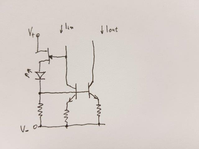

Samuel Groner proposed this scheme.Bob, what about using jfet as a helper transistor in current mirror? Perhaps it takes a LED or something similar in series with source to get proper voltages. It would certainly improve the speed and linearity, plus the value of the third (non degenerative) resistor would be much less critical.

This is what I had in mind (but no adequate drawing SW at hand )
That should work, but I'm not sure it is an improvement at the end of the day, and it does not equalize mirror collector voltages.
Bob

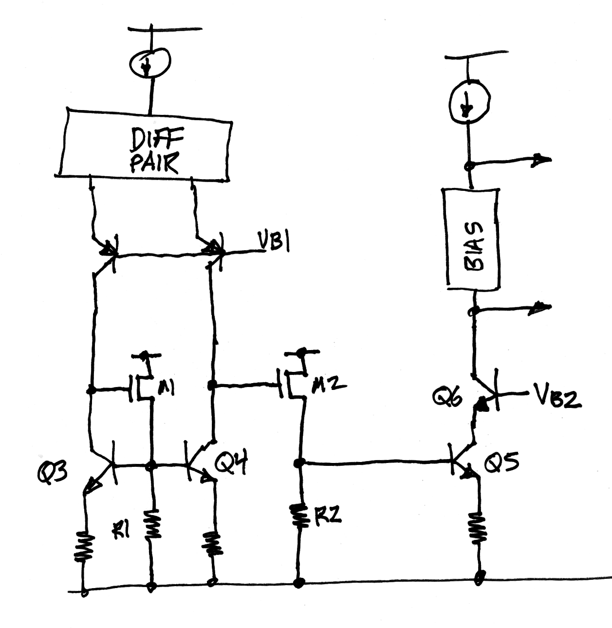

So did I:
... redeploy the original 741 opamp's current mirror load, but replace bipolar emitter followers Q7 and Q16, with MOSFET source followers M1 and M2. Be sure to match the MOSFET load resistors R1 and R2, just as Fullagar matched the 50K emitter load resistors in the 741. We're not building a low power opamp so we can use source leg resistors a lot lower than 50K! Fortunately we can buy dual MOSFETs whose two devices are manufactured side-by-side on the same wafer, see pdf datasheet attached.
M1 supplies all base current, thus the mirror loads are not unbalanced. M1+M2 ensure the mirror collector voltages are balanced. The high input impedance of M1+M2 increases the low frequency gain (Zload / gm) of the IPS. What's not to like?
So did I:
M1 and M2 need to be matched. That's kind of not to like.
Bob

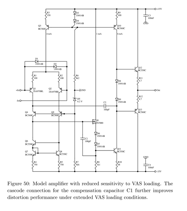

I don't think that resistor is a problem and not need to be bypassed, at least it's only EF and collector voltage fluctuation, even with 5k resistor, is very low even at full power. Distortion simulation at full power with and without protection resistor shows no difference at 1 kHz and only very small increase at 20 kHz. In case of VFA with JFET LTP I used 4k7 resistor and I case of CFA I used 6k8 resistors. Built CFA distortion measurement shows only 3 to 4 times higher distortion at 20 kHz at full power then simulated. (simulated THD20 at 200W/8 was 3.6 ppm and measured just 3 to 4 times higher, on all account very low).
By the way Bob have you included in your new book edition any example and analysis of an amp with symmetric complementary IPS or CFA?
Best wishes, Damir
Did you see this part of the same posting
But perhaps the biggest concern isn't matching between M1 and M2; rather it's repeatability of the threshold voltage of M2 when you build five thousand amplifiers with five thousand M2 devices. If/when M2's threshold varies from amplifier to amplifier, the input bias point of the VAS changes, which requires DC NFB to introduce an output offset that moves the VAS back into balance. Ick. Looks pretty on the schematic though.
If M1 and M2 are N-channel JFETs, their sources need to be positive wrt to their gates. That would force the BJT VCE to zero or very small, I think.
Bob
Suppose we use them anyway even though they are NOT matched. Suppose their gate threshold voltage "VTH" values are 1000 millivolts apart.
Then the Perfectly Balanced point for the current mirror, would have the collector voltages 1000 millivolts apart. Let's figure out what it will take to get those collector voltages back to equal.
Using the Cordell Audio spice model of the 2N5551 transistor, I simulated a 3T current mirror with emitter degeneration resistors equal to 9 * (1/gm of the mirror devices). Running at 2mA per side, Spice said the mirror's dynamic output resistance was about 3E+6 ohms.
Thus to pull the mirror back into a condition where the two collectors are the same voltage, we use Ohm's Law to compute the required extra current in one leg of the mirror
- Iextra = 1000mV / 3E+6 ohms
But wait! 0.33uA is 0.017% of the per-leg mirror current. The emitter degeneration resistors are ±1% (or maybe ±0.1% if you're xnal-retentive). So the mismatch in M1-M2 is completely negligible compared to the mismatch in 3TCS emitter degeneration resistor. And NOBODY worries about mismatch in degeneration resistors. I checked Bob Cordell's JAES amplifier paper: no mention of mismatch in degeneration resistors. I checked Bob Cordell's book, Chapter 7: no mention of mismatch in degeneration resistors.
And yet a quick simulation verifies what intuition predicts: a 1% mismatch in current mirror degeneration resistors, gives a 1% mismatch in currents between left-leg and right-leg.
So it seems that M1-M2 mismatch is a much smaller contributor to current mirror imbalence, than emitter degeneration resistor mismatch. What a pleasant result.

Sorry, I didn't realize you were suggesting MOSFETs.
Bob

Good points. I always assume the use of 1% metal film mirror degeneration resistors. If they are in the extreme +1% and -1% each, then the mirror's common mode rejection is only 34dB, even if everything else is perfect and there is no current drawn by the base or gate of the helper device.
I don't take the trouble to measure and match 1% metal film resistor pairs, but I always pick adjacent ones off of a tape. They are usually like peas in a pod (but you can't count on it). Same for transistors.
Bob
