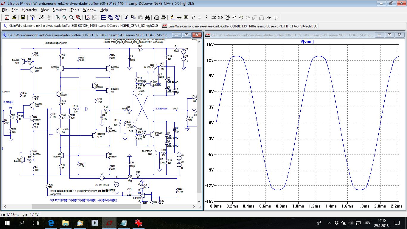

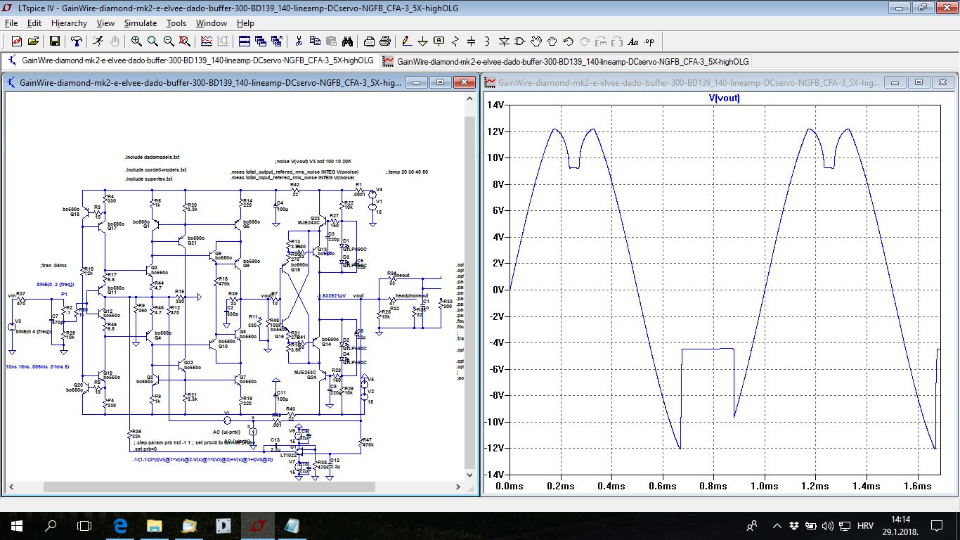

R20+R21 are very low. I used 47k or similar.I noticed strange clipping in my GaiWire preamp where this kind of 3T current mirrors where used. When I switched to ordinary 2T current mirror problem was solved.
No difference at all, I went up to 100k with the same result.
The current mirror helper EF is over-driving the VAS transistor into saturation and pushing enough current base to emitter to lift the emitter off of the rail. The 2T current mirror cannot source enough current into the VAS base to do this. The VAS should have a current-limiter transistor on it.

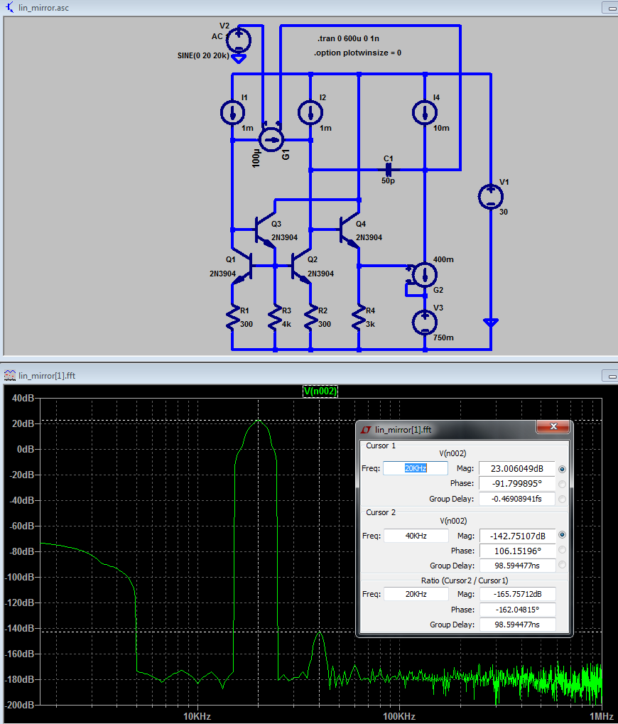

Hi All. Its been great reading everybody's responses to my current mirror questions I am planing on test some of the response infomation on the weekend. I was just wondering if anybody had a Spice file that allows me to just simulate a single ended Input stage with a Dc ails, current source, differential pair, current mirror, negative feedback etc.. and then whatever other components that I need to allow me to simulate the circuit using Lt Spice.
First thing I would try is collector resistors on Q21 and Q22. When it overdrives the CM helper transistors can pull an indefinite amount of current out of the VAS collectors through the base. This occurs as phase inversion.
There is no VAS, just current conveyor. I think that with current conveyor the helper transistor is doing more harm than help. And this happened only in feedback mode, in non feedback it behaves OK.
This sort of thing is one of the reasons I wanted to put anti-polarity clamp diodes across the IPS collectors, so as to limit the voltage swing in clipping to no more than +/- one Vbe about the nominal voltage. One concern in the 2T VAS is over-current in the EF transistor when it tries to drive the emitter of the saturated VAS transistor through its base. There can even be a safe area concern for that EF transistor. With the positive swing out of the mirror limited to no more than 1Vbe above nominal, the amount of this over-current is easier to control. In my design, I place a 50-ohm resistor between the emitter of the emitter follower and the base of the VAS transistor. This, in combination with the typical 22-ohm VAS transistor emitter degeneration helps limit the current in the EF transistor during clipping.
Bob
