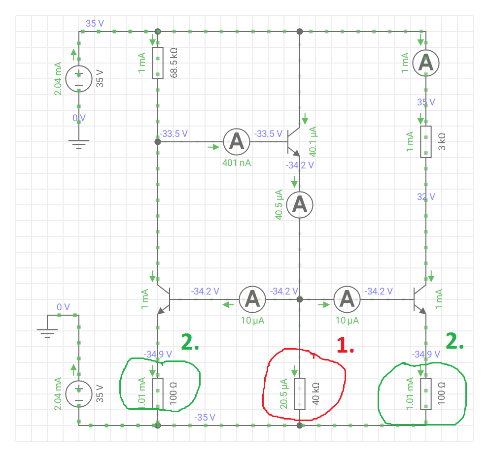

Current Mirror Question
Hi All,
I was watching a Burning amp 2016 youtube clip were Bob was talking. (great video by the way YouTube ) I noticed that on one of Bob's circuit diagrams he show a extra resistor connected from the base to the negative rail on his current mirror shown a "1" in my attached diagram.
Could someone please explain to me the purpose of this resistor. I was thinking that it may possibly help drain the base current from the two transistors when you want them to turn off, but I am not sure.
The other question that I have is regarding the selection to the degeneration resistors for the current mirror. Is there a rule of thumb for this or a way to calculate the best value for them. Shown a "2" in my attached diagram.

It increases the current through the top transistor, which increases it's Ft and keeps it from turning on and off during operation. With only the base currents to bias it it will be very slow, and this can cause phase problems in the feedback loop. It also has to drive the mirror's base capacitances, which allow the base currents to be negative at times. An NPN transistor cannot supply negative current, so it needs extra bias to absorb the capacitive currents.
This resistor introduces some nonlinearity due to converting the nonlinear Vbe of the current mirror, so it can be a damned if you do, damned if you don't sort of thing.

Thank you for the great detailed explanation really appreciate your time.
I also found that if I lower resistor 1 to much the current becomes to high and actually pulls out base current which affects the accuracy of the current mirror.
Do you have any advice on the selection of the degeneration resistors?

Keantoken has left the forum for the moment, so if I may comment.
It's easiest to make the recommendation in terms of the potential across the resistors.
For reduced noise it should be >> 26 mV, say 260 mV .

300mV is a good figure for current mirror degeneration for noise, you don't get much better by going higher.
Rbias/Rdegen should be >> Hfe of the current mirror transistors, as a basic rule of thumb, so that the benefit of the current mirror Hfe isn't lost due to the bias resistor. In this case, 40kRbias/100Rdegen=400 whereas Hfe is 100. Notice that you can't increase Rdegen in this case. If we increase degeneration to 300mV by increasing Rdegen to 300, then 40kRbias/300Rdegen=133.
Note that an Hfe of 100 is pretty low considering what we usually use for current mirrors. The situation gets worse when you use for instance the BC550C with 500Hfe.
So this kind of current mirror has a lot of damned if you do, damned if you don't type of stuff going on. That's why I never use it, in practice it's actually terrible in terms of linearity.

What type of circuit do suggest that I use for a current mirror them. Can you please post and example.300mV is a good figure for current mirror degeneration for noise, you don't get much better by going higher.

I recommend choosing the emitter degeneration resistors in a current mirror, large enough that the voltage dropped across them is at least 20 times bigger than the worst case delta-VBE (a/k/a "VBE mismatch") you might ever get between the two transistors in the current mirror. So, for example, if you expect you might get a 10 millivolt difference in VBE, drop at least 200 millivolts across the emitter degeneration resistors.
By the way you want the third "helper" transistor in the 3-transistor current mirror, to exactly match the emitter follower in the "Darlington VAS". So you want to run them at the exact same current. So you want them to have the exact same resistance in the emitter leg. You can see that Dave Fullegar did this very thing in 1969 when he designed the famous uA741 opamp, schematic below. This was four years before the SPICE simulator was created.

Im not sure how the 40k is used as Rbias in your calculation as the current is not flowing through it and into the base. Can we use Ib/Ie ?I shouldn't say it's terrible, since it can work well, but I've never seen the need to fight with it rather than use another kind of current mirror.
The voltage across the degeneration also appears across the 40k resistor, hence for every 1mA through the degeneration, there will be 100mV across the 40k resistor. 100mV/40k=2.5uA per 1mA Ie. So it acts like Hfe, it isn't a physical Hfe. It is a parasitic effect of the 40k resistor.
