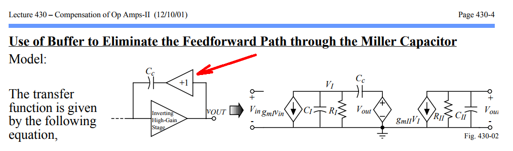

I suspect you might mean, lowering the GBW without reducing the slew rate too much.
If reduced slew rate is acceptable, you could just increase the compensation capacitor. To prevent big Ccomp from creating a right half plane zero, you could install a good old Yannis Tsividis x1 buffer between VAS collector and Ccomp.

Simply putting a small resistor in series with Ccomp also eliminates the zero. The value of the resistor should be 1/gm of the degenerated VAS. A value larger than that can be used for Rseries, in which case it will introduce a LHP zero that will provide a little bit of phase lead compared to the theoretical 90 degrees of lag that the Miller compensation provides.

You describe that "zero trick" somewhere in your book, and you also recommend enhanced VAS (EF + VAS) for good reasons. I'm wondering, whether the reader should be pointed at the possible VAS stability issue when combining both techniques.

I'm unaware of any VAS stability issue that is introduced when adding the resistor, as long as its value is not excessive. Bear in mind that its value for canceling the zero will be on the order of the value of the VAS degeneration resistor value, often in the neighborhood of 22 ohms. Note that in a typical case where the Miller cap is 30pF, the zero that would normally be introduced is pretty high in frequency.

http://web.mit.edu/klund/www/papers/ACC04_opcomp.pdf discusses added series R for a zero in Cdom (~ halfway thru)

I'm refering to p. 176/177 of Bob's book and did not remember the last sentence "Caution must be exercised with this technique to avoid compromising gain margin". (It is, however, not clear for me whether this relates to global loop or minor VAS loop.)
The problem is described around Figure 37 in the reference from jcx. Maybe, one can also combine the solution with high-frequency shunting of the VAS emitter degeneration. Anyway, one should consider the issue when trying to mitigate influence of a main-loop pole with the additional resistor.

Edit: All depends, of course, on values. Assuming the 5MHz pole example from the book, and an attempt to mitigate it with an additional main-loop zero at 10MHz, then this additional pole in minor VAS loop may be in dangerous vicinity of original crossover frequency in minor VAS loop.

That's a good paper jcx provided. Bear in mind that the author was introducing a zero at a frequency below the ULGF to compensate for a heavy pole created by the capacitive loading. The need for a high enough resistance in series with the compensating capacitance in order to insert a zero at such a relatively low frequency is what led to the minor loop instability. Inserting a small resistor to cancel a RHP zero created by the Miller capacitor has its effect at a much much higher frequency, and involves the insertion of a much, much smaller resistance.

The feed-through zero is out of question. For the main-loop zero, one should also remember that crossover frequency in our VAS is probably lower than that in the op amp example.
Finally, all depends on the phase margin one would like to maintain in the minor VAS loop; a bit a question of taste. Some people only consider it a problem, if peaking in main loop occurs.
