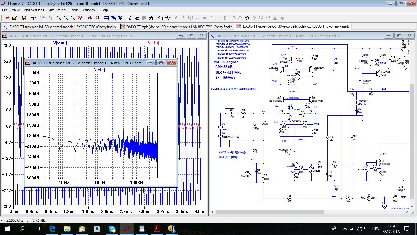

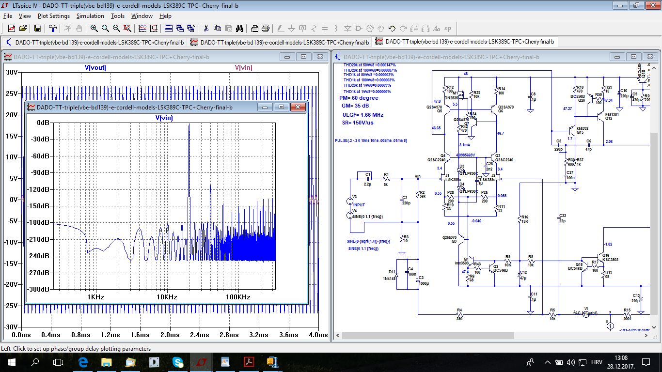

Here is simulation to show input distortion with input resistor of 0.1R and 1k.
Used Cordell's models.
Do I do something wrong here?
Damir
Added input distortion of my CFA.

Matthias there is DC balance, 1k resistor is in series with capacitor.
It depends on how you cascoded it
Attached my TT amp with the fet bootstrap cascoded LTP.
Input distortion is dominate distortion in this case(0.000329%), THD20 is below 1.5 ppm with low source output resistor.

In my understanding, base current of inverting input flows via 20K, while base current of non-inverting input flows via 0.1R||20k or 1k||20k in the second circuit. So I would expect some effective offset voltage, depending on bias currents.
Matthias
OK I got it. Normally there is serial capacitor in the input here removed to simplifies the FFT. If you want DC connected input you would need DC servo.
This unbalance does not influence input distortion.

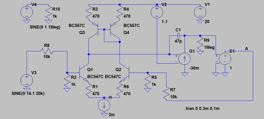

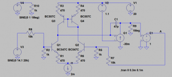

The baseline seems to be the problem, at least can I confirm that for the "think model" of impedance symmetry between the inputs.
In the simple conceptual model below (ULGF around 600kHz, V4 ensures small sim step), one gets lower THD, if R2 and R8 at non-inverting input are scaled down. I have also checked that e.g. collector voltages of Q1 and Q2 remain in balance after that change.
In my amp with much less distortion, this does not hold. Best performance is achieved with balanced impedances.
Sorry for the noise and any trouble, Damir.
