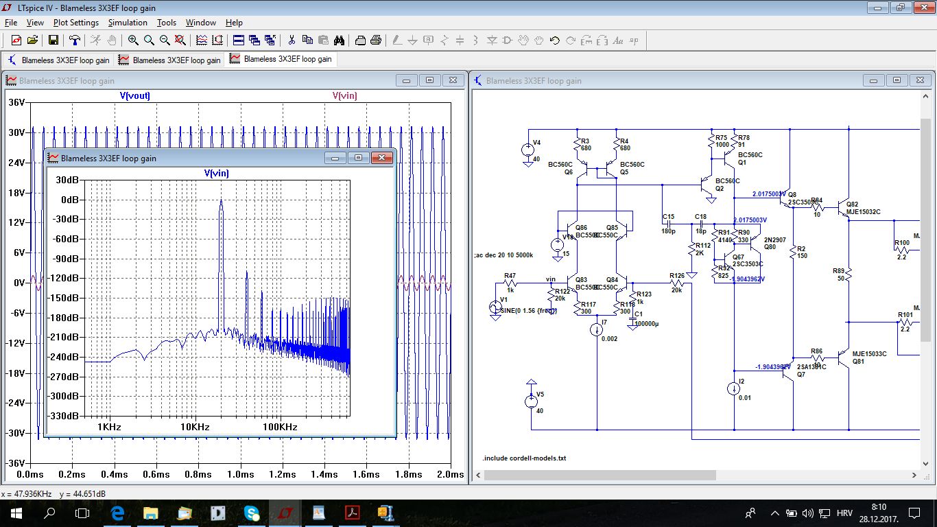

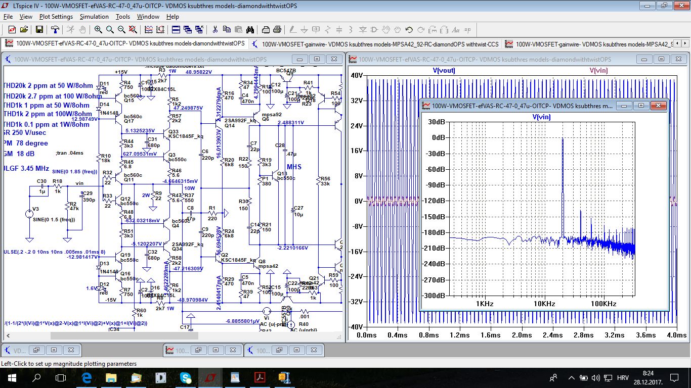

I simulated three amps I have built.
1. Classic blameless with BJT LTP and CM. Increase in input distortion with source output resistance was major distortion source, much higher than the amp distortion with zero source output resistance.
2. FET LTP bootstrap cascoded with CM. Very similar to first case. That one surprised me, I expected much lower input distortion??
3. My CFA with complementary BJT input. Input distortion was much less influenced by the source output resistance and was quite low, probably reason, some cancelation of the input base currents.
Damir

Here is simulation to show input distortion with input resistor of 0.1R and 1k.
Used Cordell's models.
Do I do something wrong here?
Damir
Added input distortion of my CFA.
